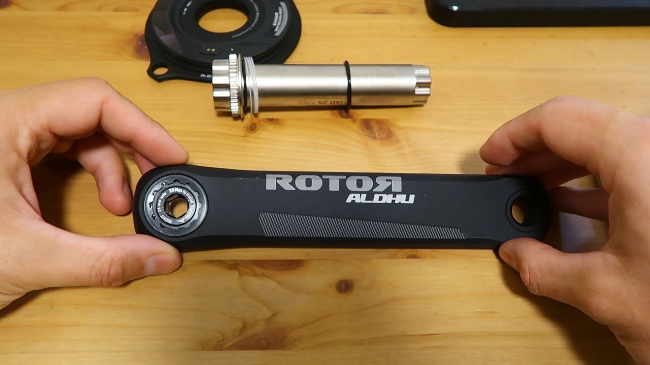

Yesterday, I took delivery of a Rotor 2InPower MTB crank, and I looked at the installation instructions. They call for 35–40 Nm to fix the chainring to the crankset in their instructions. But I don’t think there is a way to use a torque wrench in this instance.
Rotor, in their own installation video, does not use a torque wrench and I wouldn’t even know to attach one in this particular instance. I cannot use a ratchet attachment like this one and the video instead uses a bb wrench.
Am I missing something or is this just something I need to “eyeball”? If so, what does 35–40 Nm feel like?

With a normal short bb tool say 125mm in length, 35Nm is about as tight as a normal person will be able to pull without risking slipping.
I also don’t think most things on a bike that call for 35 are really that critical to get to 35, including crank bolts, but I’ve never used rotor. If I couldn’t get a torque wrench on it I’d just retighten after the first ride
No problem. I just find it weird to give torque specs if there is no (simple) way to use a torque wrench.
