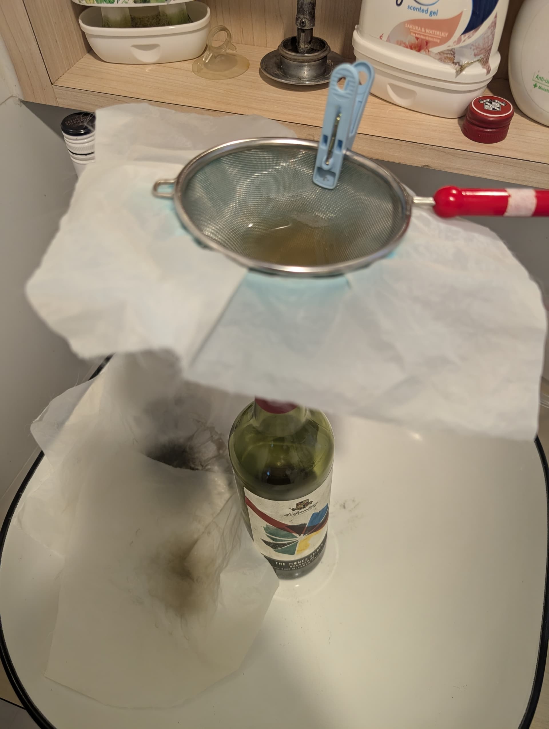

This lets you get off with less degreaser, especially when dealing with heavily soiled components, like those off gravel and MTB bikes. You can then re-use the degreaser after filtering it. I typically use cutup sheets of 50 micron cheesecloth as a filter; any smaller and it takes forever to filter, any larger, and you’re letting microscopic particles through.
