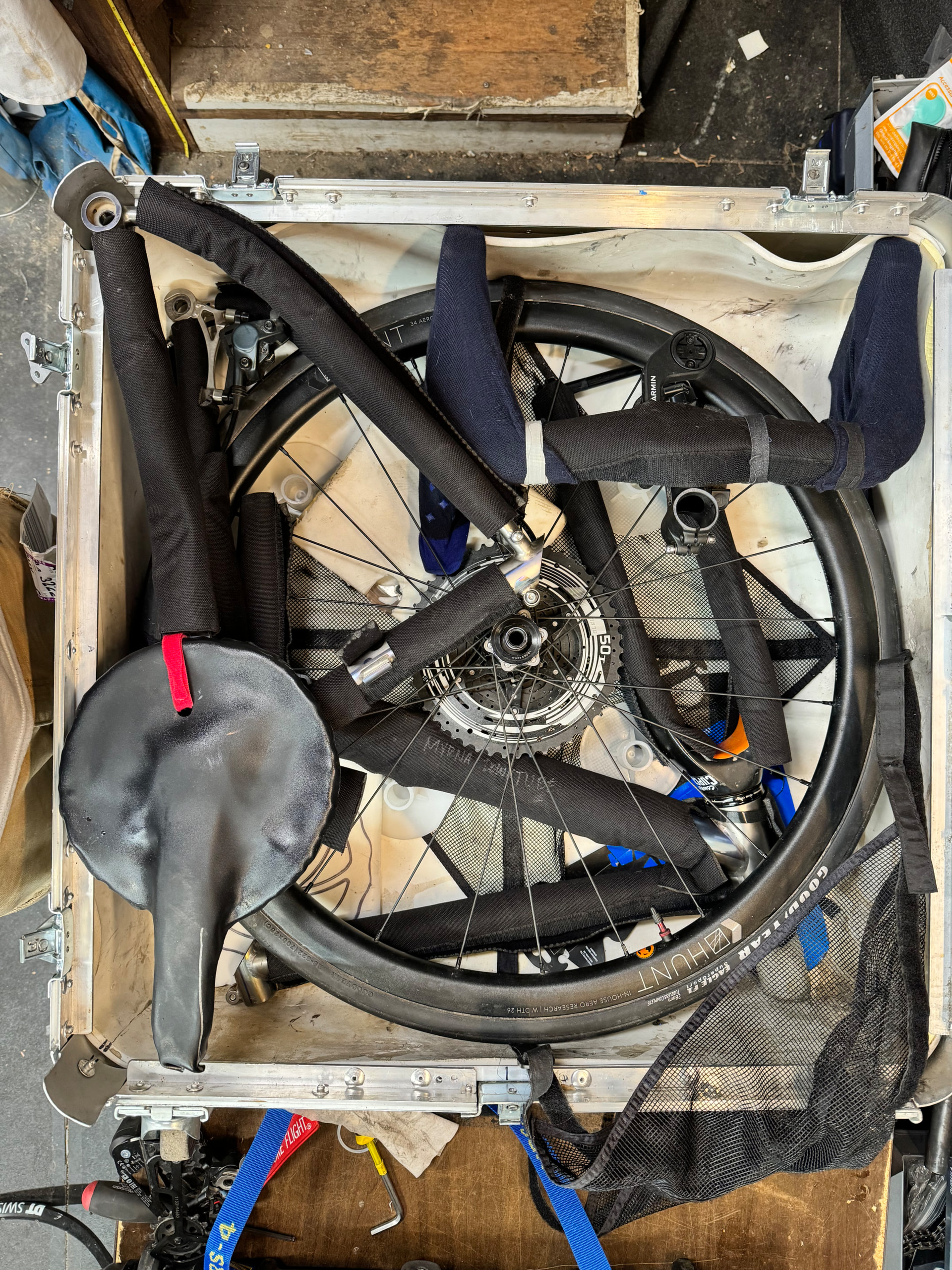

I have a post above from December showing some foam inserts I made from scrap packing material. They slip in between the lever and bar, and my SRAM buttons are protected from being hit in the case. You should be able to do similar to protect your Shimano buttons, and it will also protect the lever as a whole. Once the inserts are installed, I use long socks (retired ski socks or similar) to pull over the whole bar for scratch protection and to hold the insert into place.

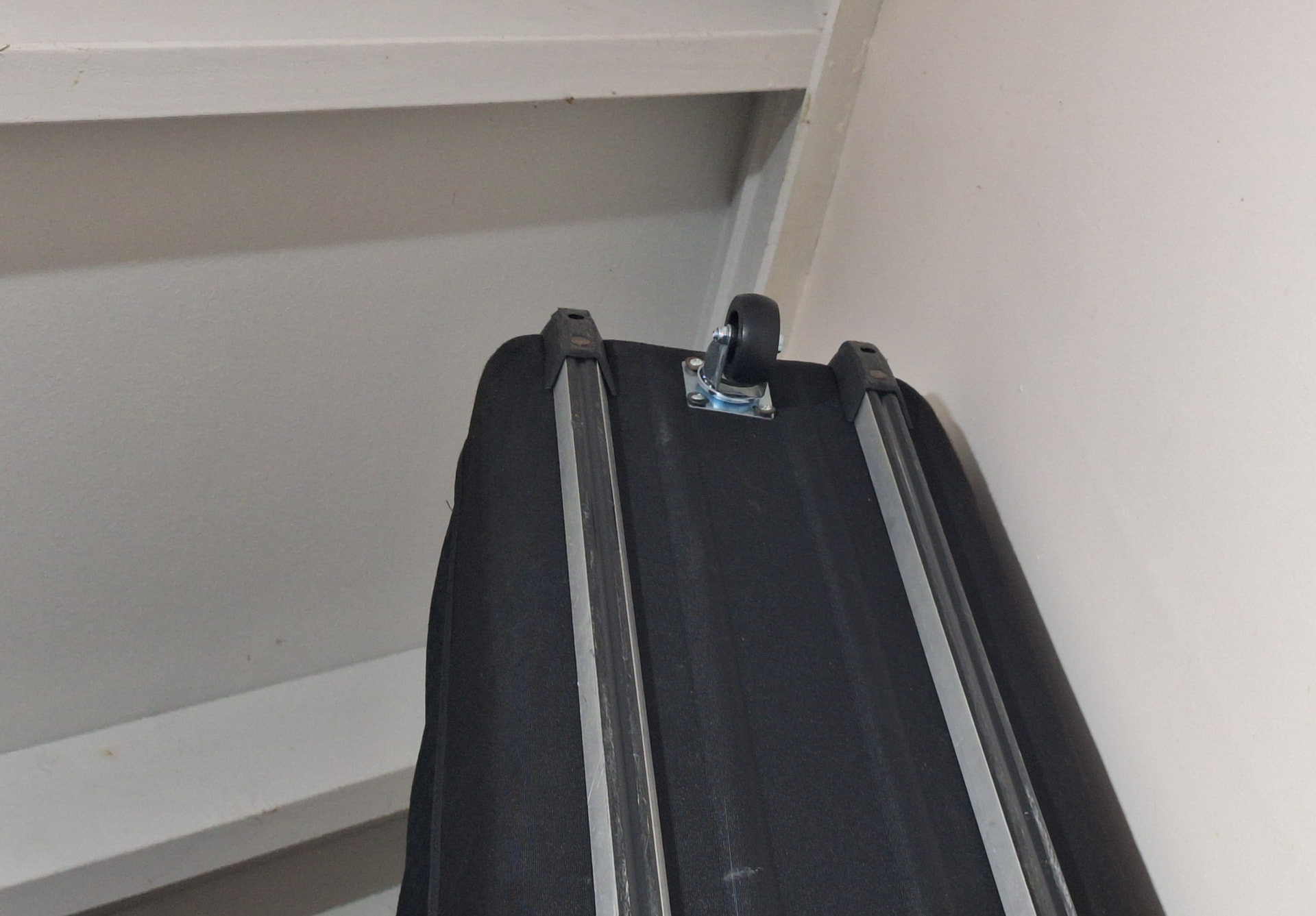

I gave up trying to get a wheel for my Evoc bag, they don’t make them anymore. Just bolted on a 7$ caster from the hardware store. Theres a bit of timber inside for the screws to bite into.
