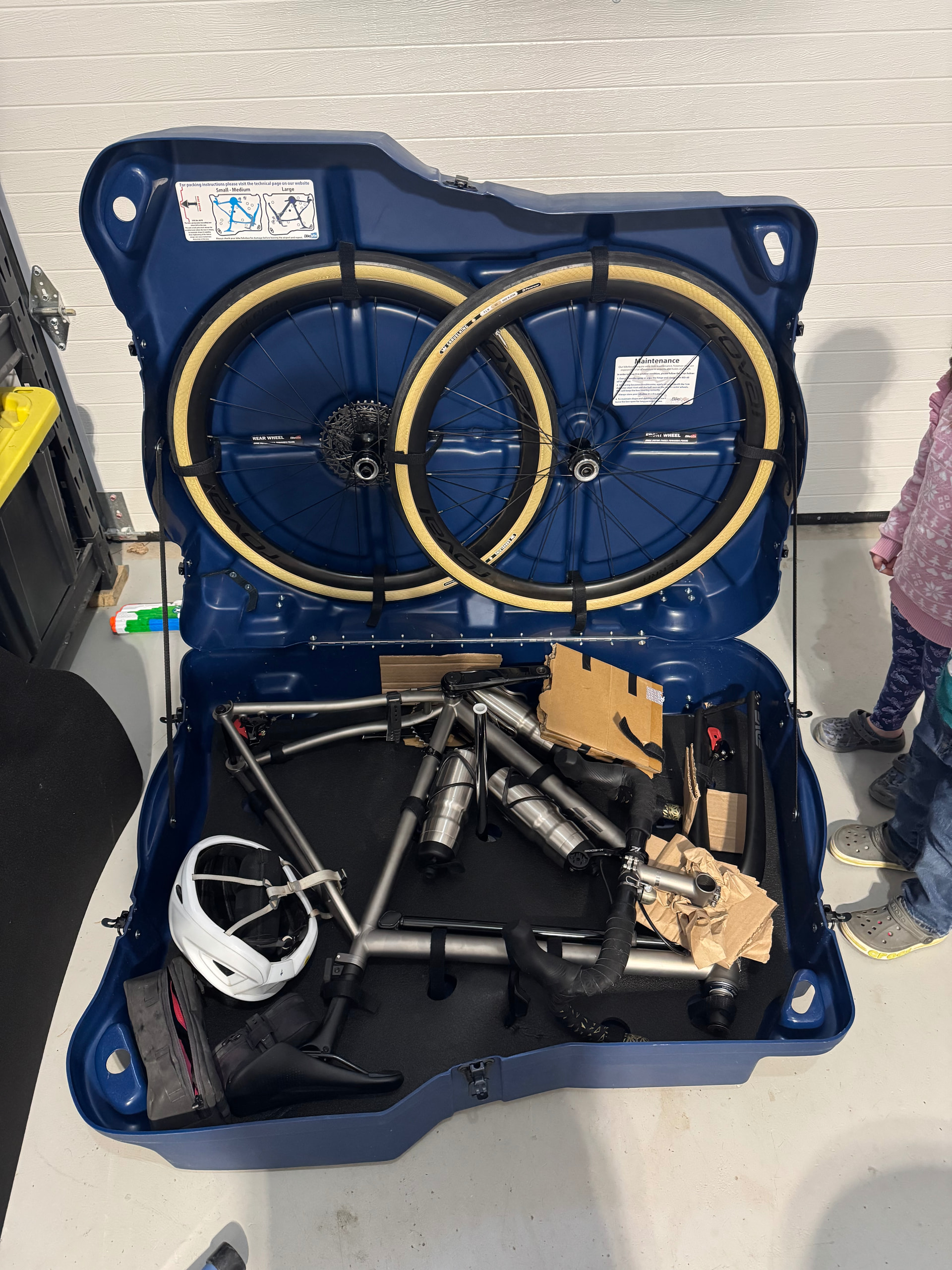

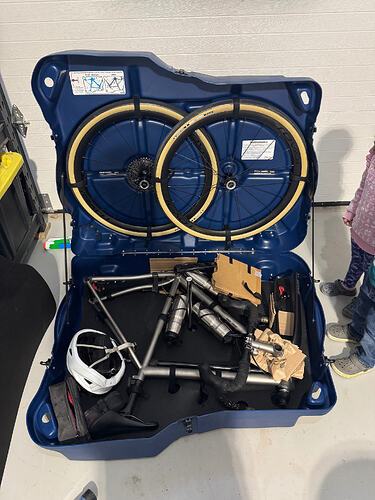

I’m packing for a trip and thought I’d share photos of my BikeBoxAlan Premium Plus. Approx size 56 bike with ~43 mm tires.
I worked as a guide for cycling tours a while back and all the clients who arrived with damaged bikes had soft cases, some damages were fixable on the spot, some had us chasing new parts in remote France, some bikes were ruined, most common damages were rear mechs and handlebars.
The worst problem we saw amongst clients with hard cases was one Di2 bike that went into crash mode during travel…
That doesn’t mean all bikes transported with soft cases will get damaged, many were fine, but the risk is much higher IMO, I wouldn’t use a soft case personally. I have a Scicon Aerotech hard case, used it many times and lent it to friends too and never had any problem, the little wheels still roll as well and the whole thing still looks in surprisingly good shape, just a few scuff marks.
No matter the case type though, one tip to help limit some damage risk: don’t load your case with all your kit/shoes/street clothes and what not, keep it as light as possible. The heavier the case ends up, the more it’s going to piss off the employees who load them on and off planes and conveyer belts, and the less carefull they’ll be.

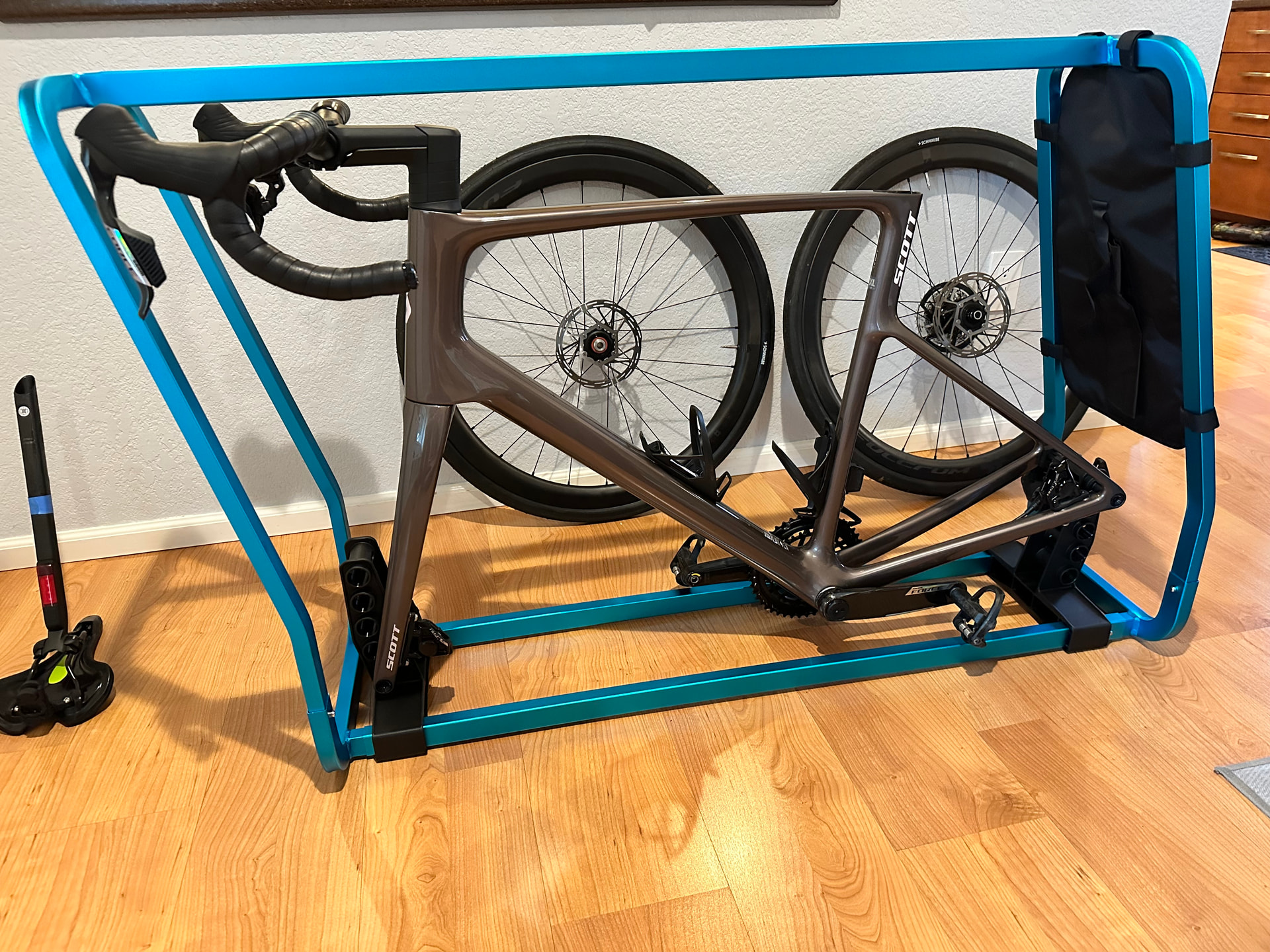

I am 6’6” ~198cm and have an XXL Scott Addict. I just took delivery of a Orucase Sentinel.

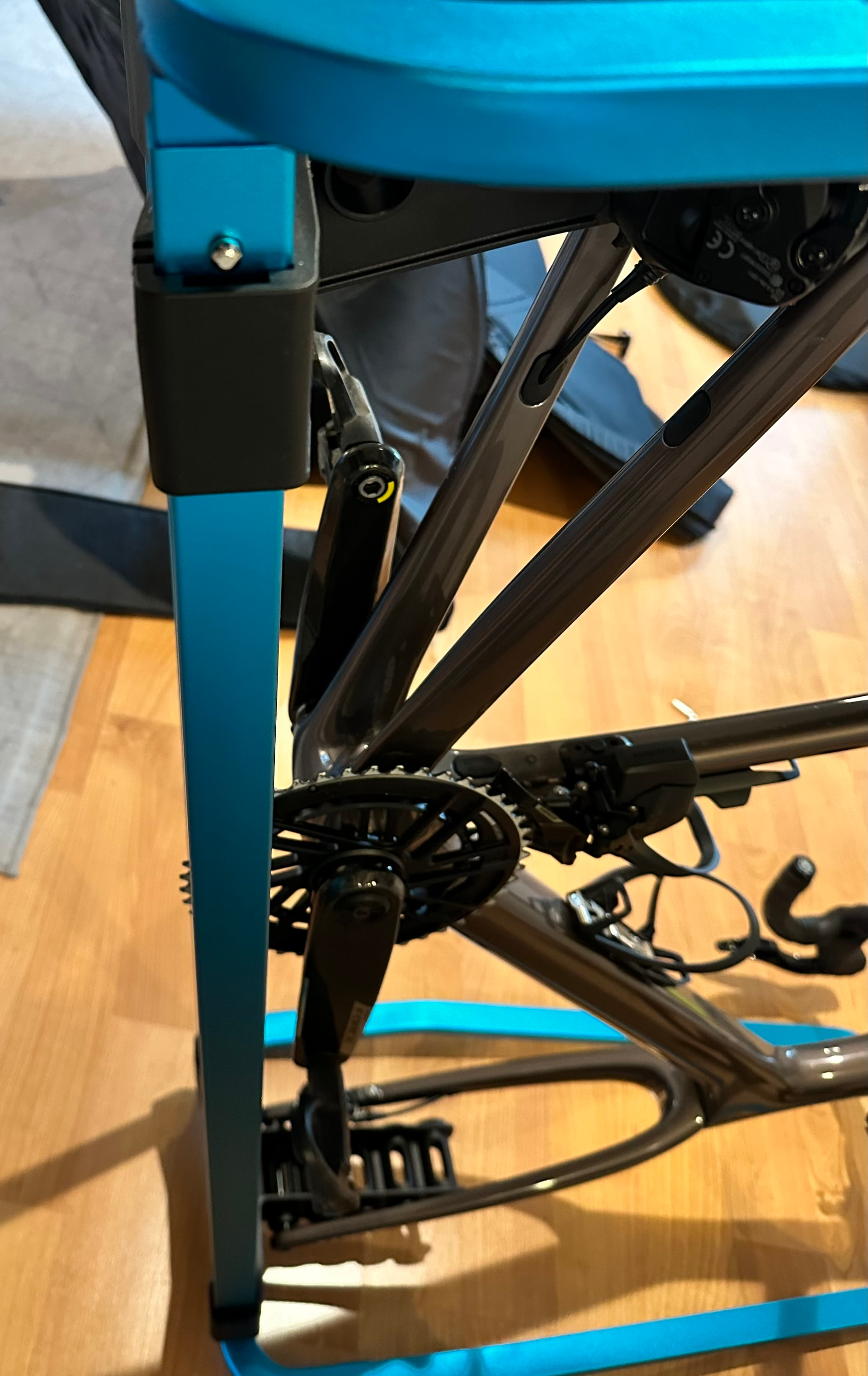

It seems the only way to make my frame fit results in the chainring sitting a little below the aluminum frame. It just barely doesn’t touch the floor thanks to clearance provided by the axle mount “feet.” I can’t move the front axle hole/mount any higher or my stem won’t fit under the top aluminum frame piece, and I am already using the highest rear mount.
I’d like to find a case that will work for my big-ol-bike. What would you do? Should I look for a bigger case/bag/box
Can you raise the rear axle?
Take off the crank? How much trouble that is depends on the crank. I do it regularly for travel with Shimano cranks, and that’s straightforward (I do use an aftermarket preload nut that uses hex instead of Shimano’s weird star).
I’m using the highest setting on the thru-axle mount apparatus. Since i have my seat post put. I theoretically could, but I’m wondering if at that point a differ t case would make more sense?
I looked at the case at Sea Otter last year and thought it was pretty nice with some good ideas. It’s hard to tell from the photos, but it looks like if you could raise the rear end up a bit the chainring would clear, and with the seats post out It looks like you have room. Maybe a 3d printed adapter will work?

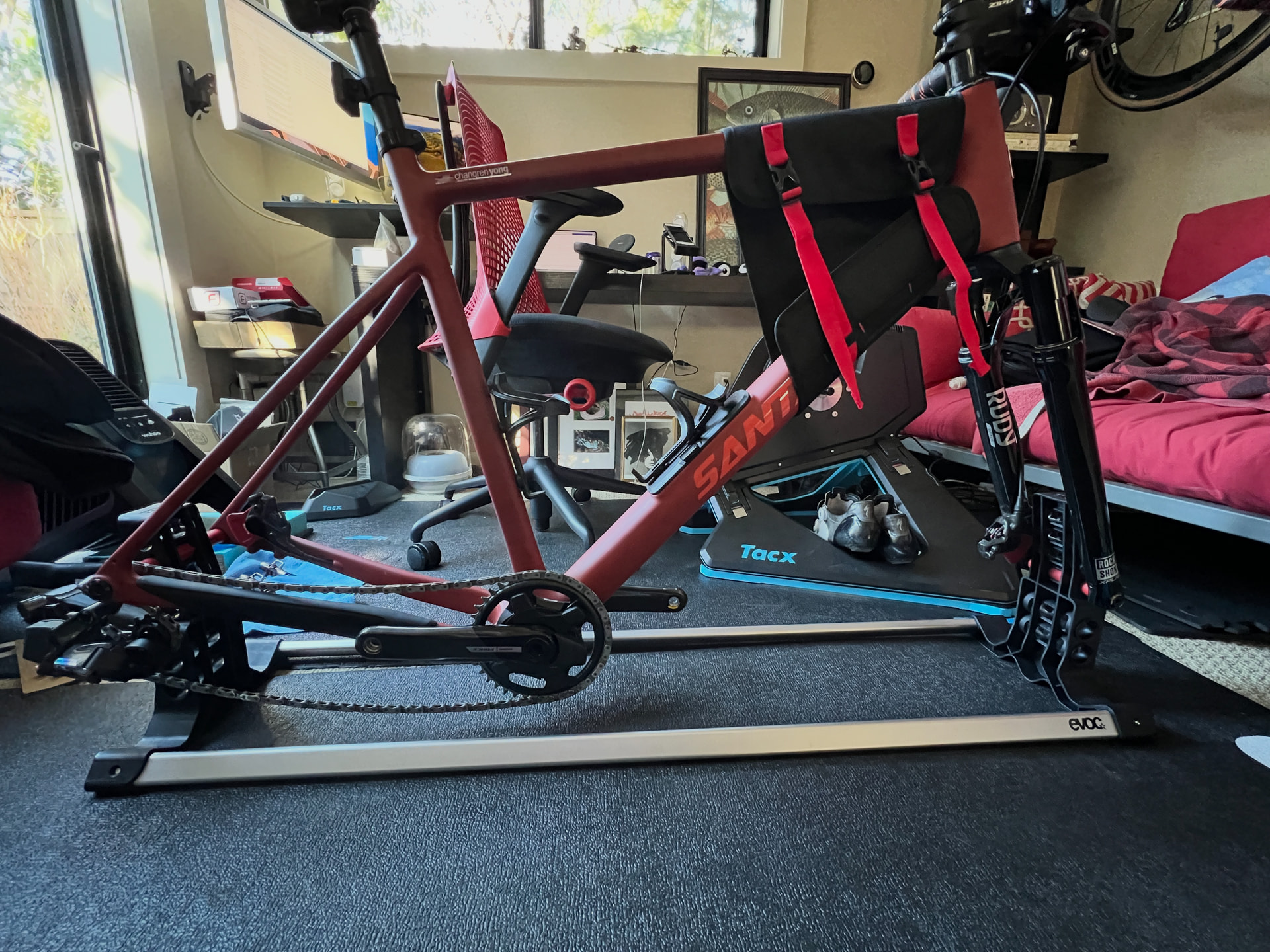

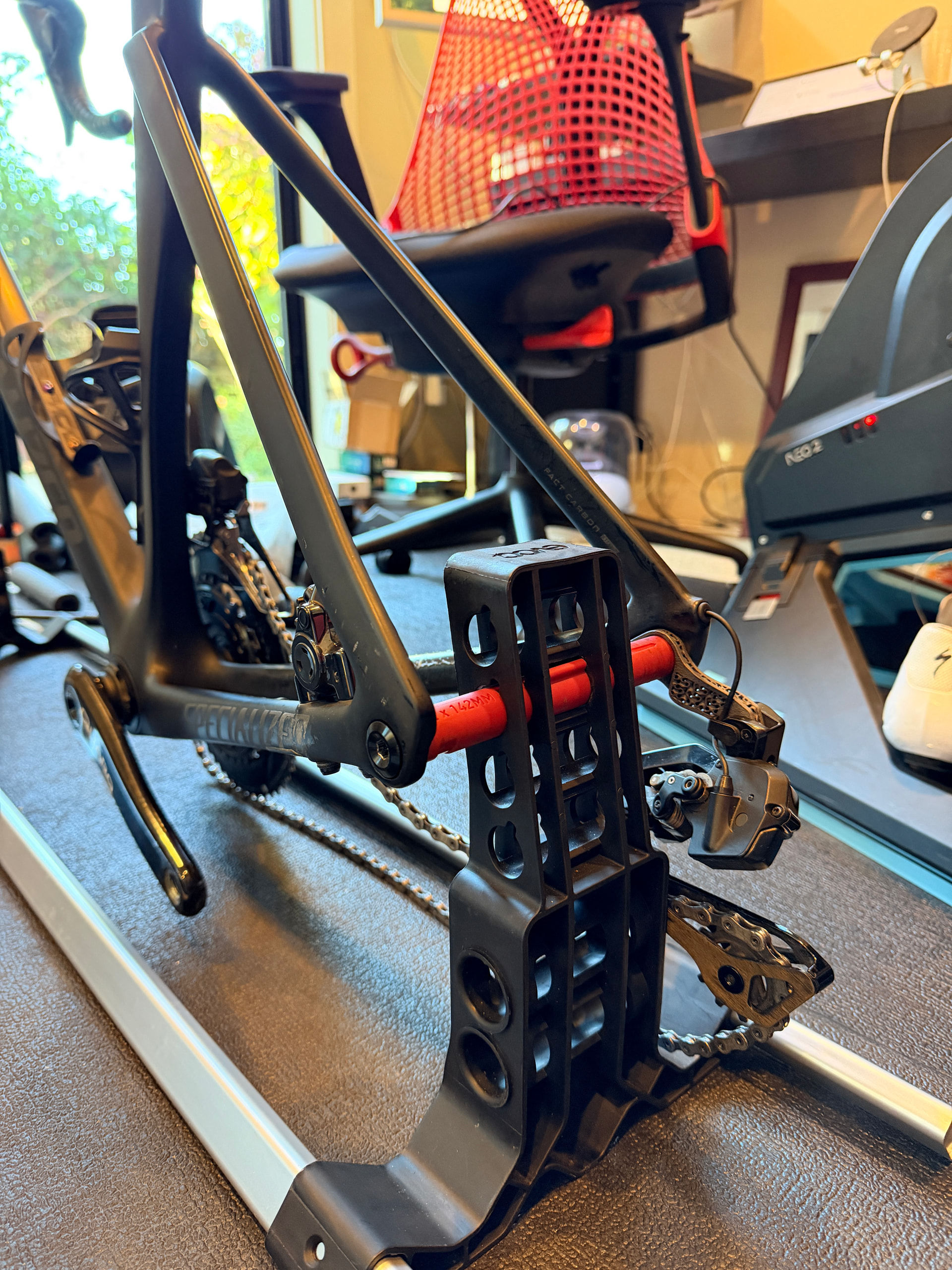

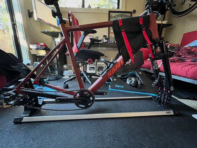

What’s the wheelbase of your XXL Scott Addict? I have a EVOC road bike bag pro and the maximum wheelbase is 106 cm. I have a XL Specialized Venge (size 58 cm, wheelbase 10.05 cm) and a XL Santa Cruz Stigmata (wheelbase 102.4 cm). To fit the Stigmata, I have to “reverse” the rear axle mount. If you can flip your rear axle mount, looks like it might raise the rear end up a bit.
Santa Cruz Stigmata:
Specialized Venge:
In case I wasn’t being clear about reversing the rear axle mount.
This is your current setup:
Front Rear
(______________)
Reversing the rear axle mount:
Front Rear
(______________(
