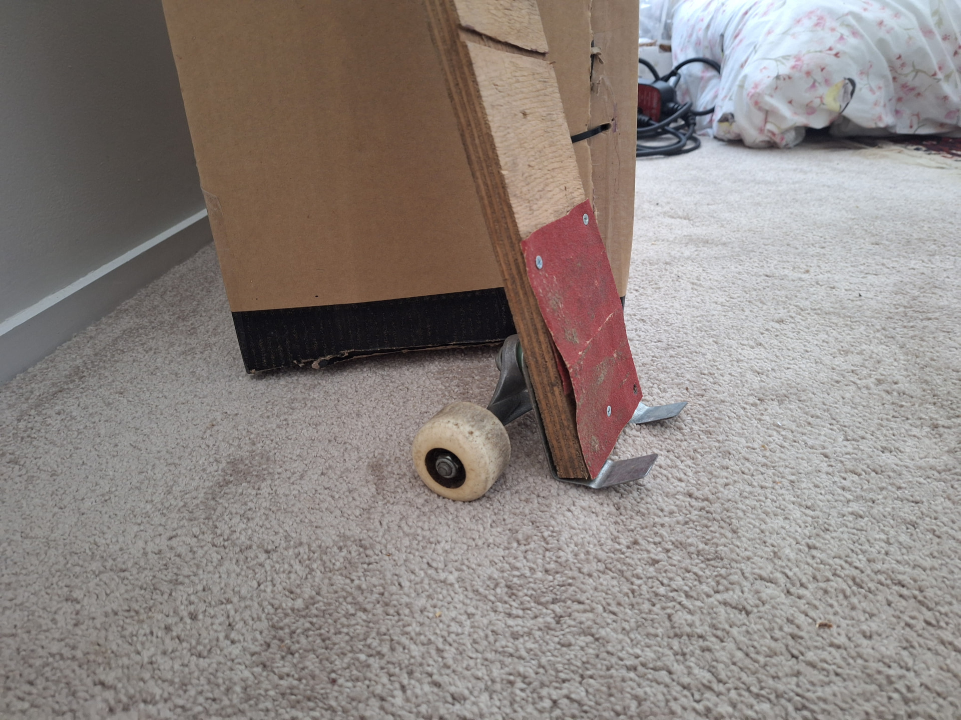

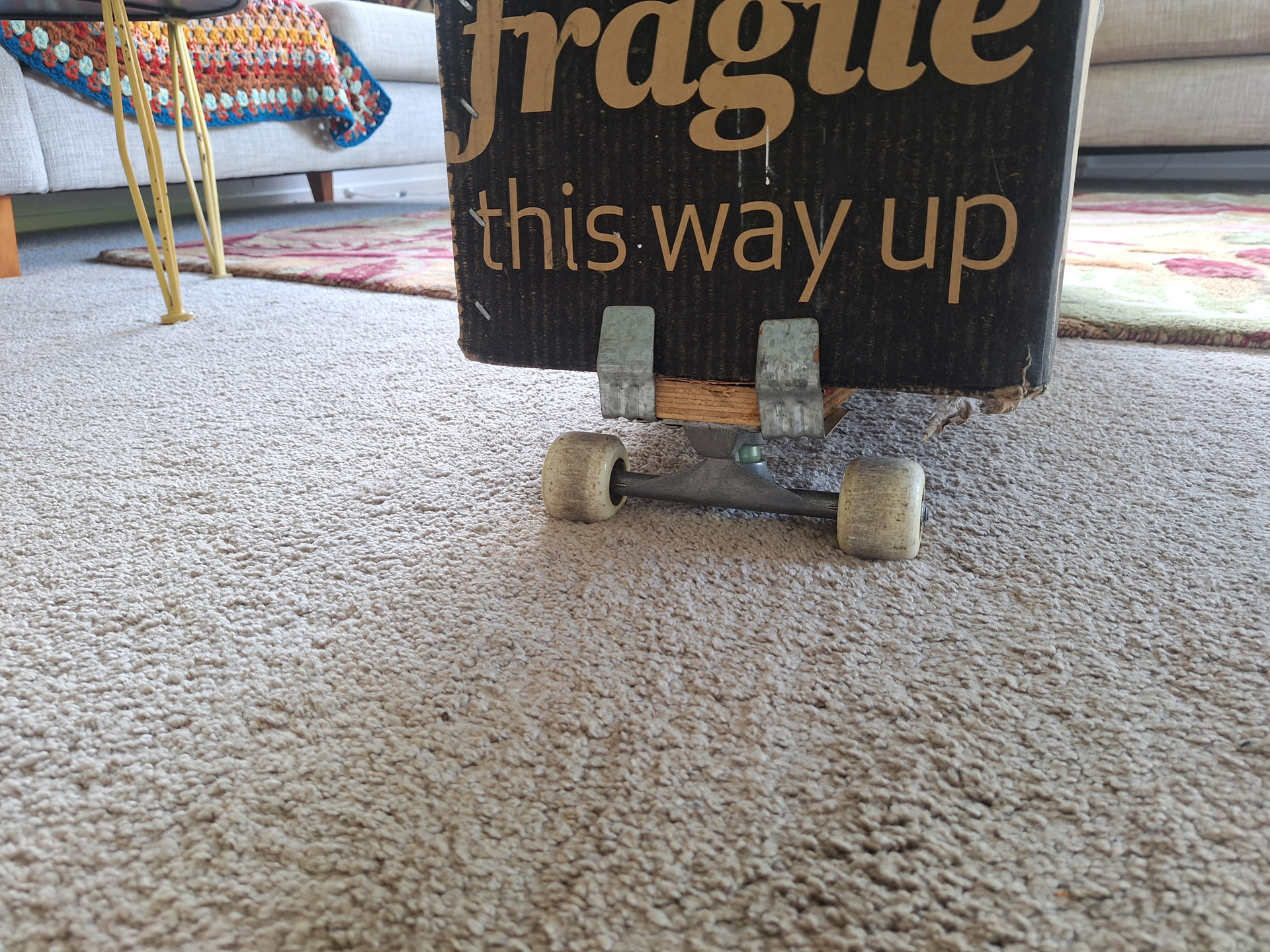

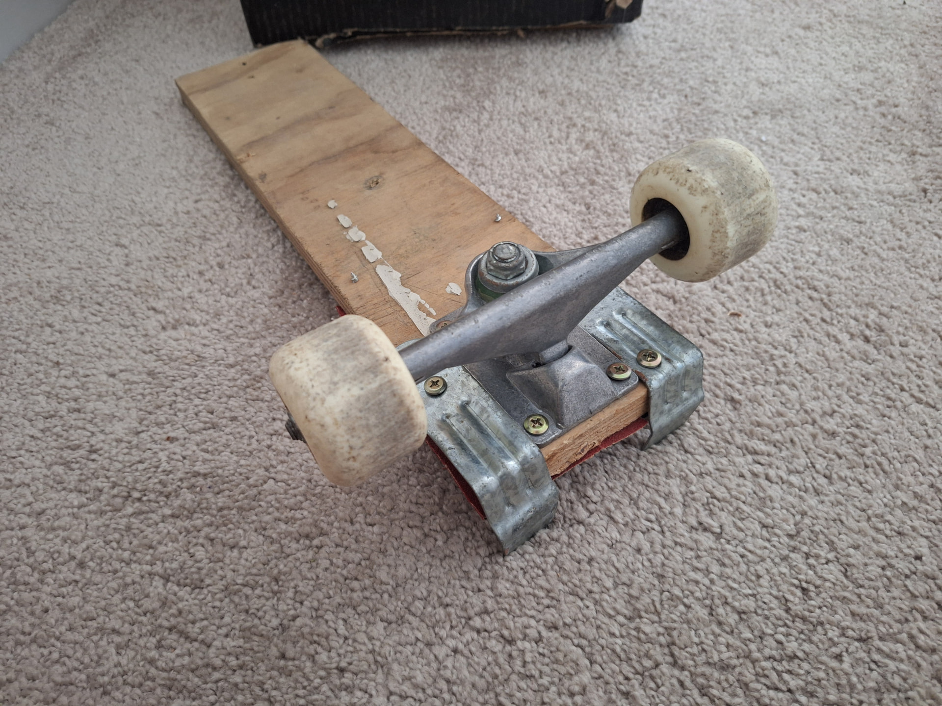

Maybe now that it’s finally snowing I’ll test the breakaway MTB in the TA3 case. Overall, I’m really happy with the case, but the mods I did made a big difference (and were easy). More info on DIY cases here Traveling With a Bike Sucks, Part VI: Another Mousetrap – MAMIL Musings: A Middle Aged Man in Lycra Considers Cycling and here Traveling With a Bike Sucks, Part III: A Better Mousetrap – MAMIL Musings: A Middle Aged Man in Lycra Considers Cycling . Not trying to make a shameless plug to my site, but no sense in re-writing my experiences here. Minor changes to the TA3 case since I made the mods: I added Chris Heerschap’s disc rotor case to the lid (drop rotors in, screw case shut) and put beefier butterfly latches on the case. These mods are all easy and don’t require much more than a chopsaw, drill, pop-riveter, and Basic Energy & Electrolyte Recovery beverages.
