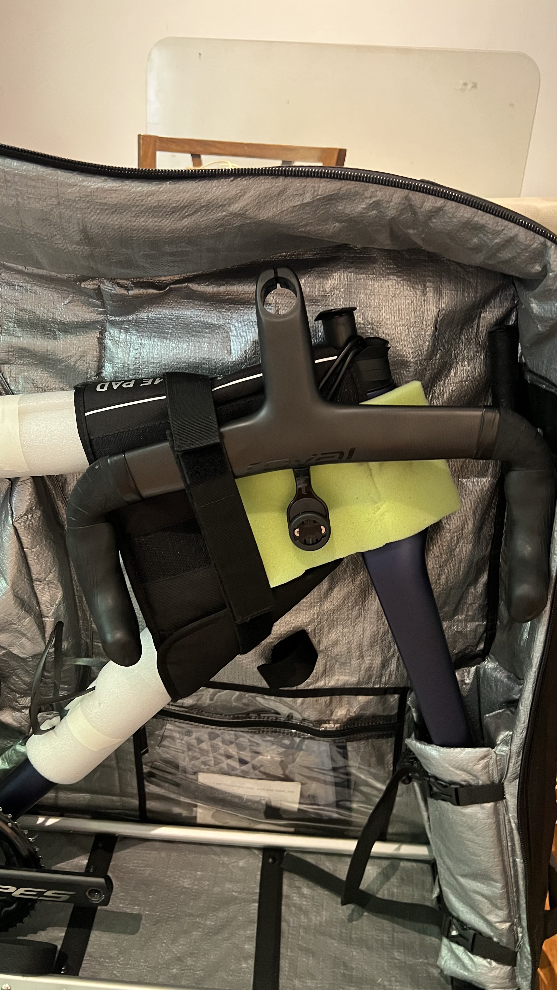

Just got back from another successful trip with my basic EVOC bag + EVOC bike frame from the pro model. This was my first time traveling with a “fully integrated” bike so I had some concerns but I need not have worried. Specialized’s cable routing below the stem made it easy to remove and rotate the bars into the bag:
My traveling companion rented the full EVOC Pro bag, It’s more maneuverable and quicker to pack (the bars stay on) but the bag is so much bigger than the basic EVOC that I still prefer the smaller bag with one extra assembly/disassembly step. Getting the EVO Pro into the back of cars, vans or onto conveyor belts at the airport was just that much harder.
Note that this trip didn’t really require much non-airport transit so I may feel differently if I had to wheel the bag around more.

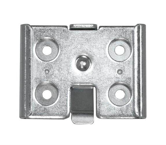

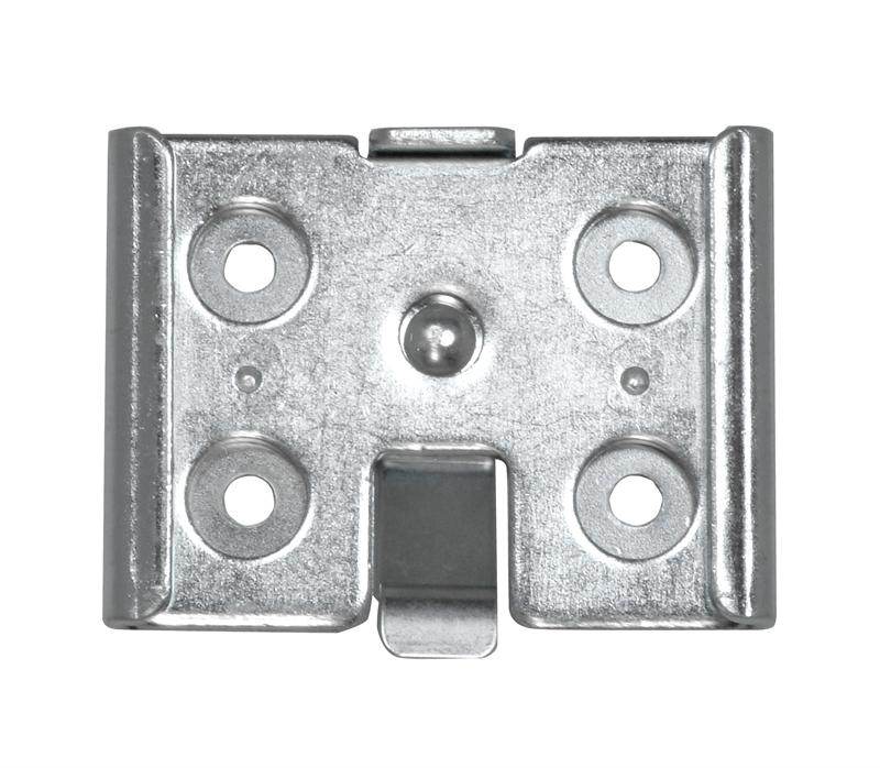

I’ll go one step further. Search for removable casters and you’ll find some nifty plug-in solutions that you can easily DIY install on and hard or soft case. No matter how rugged your casters are, handling systems love to tear them off and it’s the case’s plastic base that is the weak point. I roll the case up ti check in, pull off the casters and toss them into the bag. Upon arrival, plug them back in and roll on. No tools required. I think a set of 4 heavy duty steel cost me about $50.
Reliable Hardware makes a steel bracket that fits 2” casters. For hard shell cases you can rivet the plates on then slide the casters in and out. There’s a spring clip that holds them in place. They work really well but I’ve had 2 get damaged (looking at you, Schipol) so I made dummy filler plates that I pop in before checking the case. A set of 4 plates and casters is under $40 or so.
