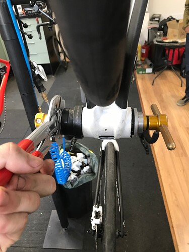

My ultimate go to when dealing with thin flanges often seen on internal t47, Colnagos etc. is to use a bearing press to keep the socket in place. Wood clamp works too - it can be a bit fiddly but it allows you to use any ratchet or breaker bar you wish.
I have a bearing press, I’ll give this a go. Super stuff.

If you use the bearing press tools, just know that you’re essentially loosening or tightening against the press so you’ll have to provide enough tension to keep the tools from slipping, but not so much tension that it prevents the tools from tightening or loosening (if that makes any sense).
