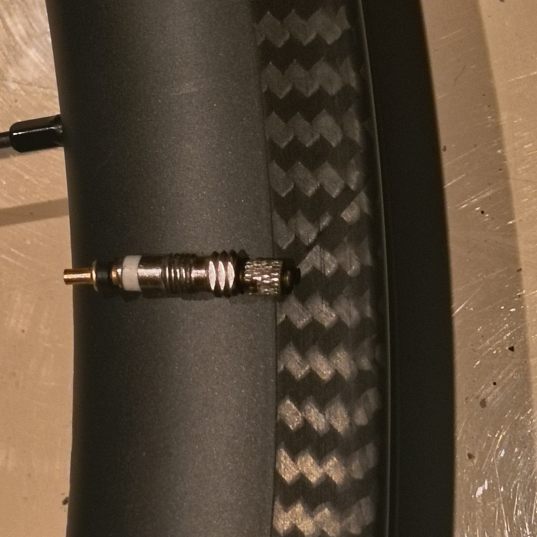

Please help! On my rim brake travel bike I use tubes because it’s not used all the often. The cheap TPU tube on the front wheel was leaking because the plastic stem was cracked. When I took the tube out the valve core fell out inside the wheel and now I’m going insane trying to get it out. It’s a 38mm deep hooked carbon rim with an inner width of 19.5mm. The only access it the valve hole. I can shake it down to next to the valve hole but it’s stuck at the edge valley. If I try to guide it to the spoke side hole I fail all the time because that hole seems to be reinforced with a lip around it and gravity exists.
I’ve tried shaking it obsessively but luck hasn’t been on my side.
It isn’t attracted to magnets, at least any I have.
The hole is too small to open and close tweezers.
I’ve tried some sticky putty at the end of a thin screw but it’s not holding it.
I also tried to suck it out with a straw.
Maybe I could try blasting water through it and hope something happens? I cannot live with a rattle in my wheel and don’t want to buy a new one. Any suggestions?

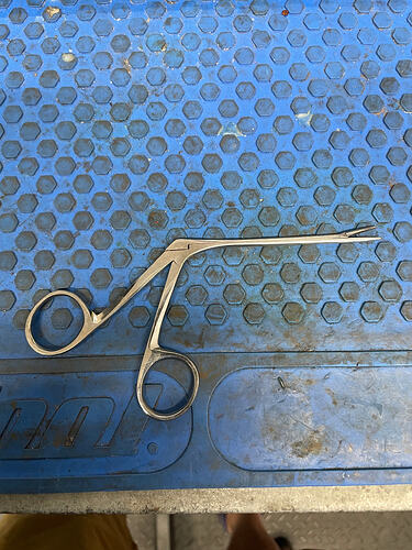

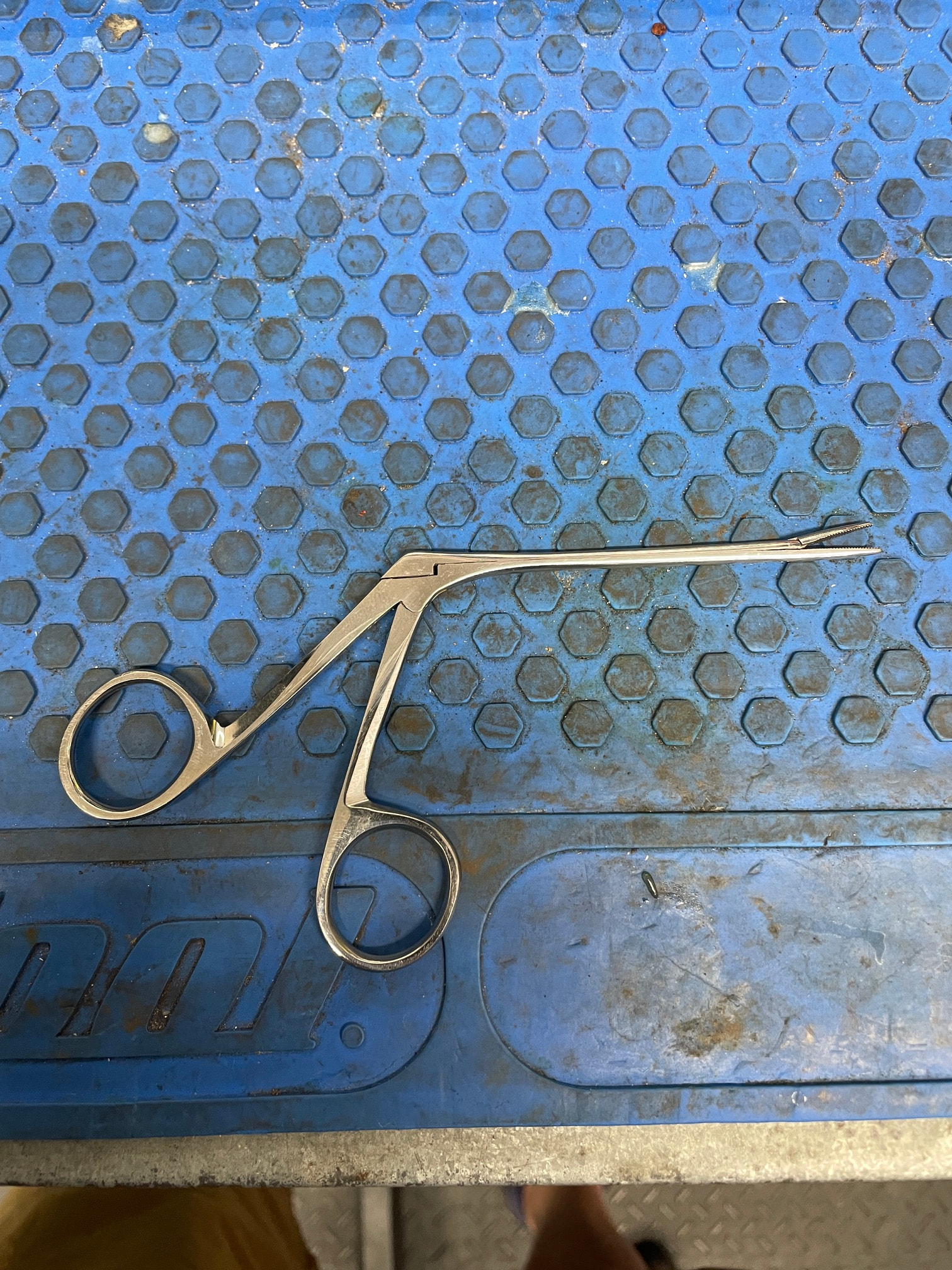

Instead of regular tweezers, forceps may work. When closed, they will definitely fit inside the valve hole. Once inserted, you can open them up fully to grab the valve core. You may not be able to pull out the forceps when it’s clamped onto the valve core, but it will at least allow you to reposition it so that it can fall out of the hole on its own. These are available from Amazon and are Geek Warning certified.
