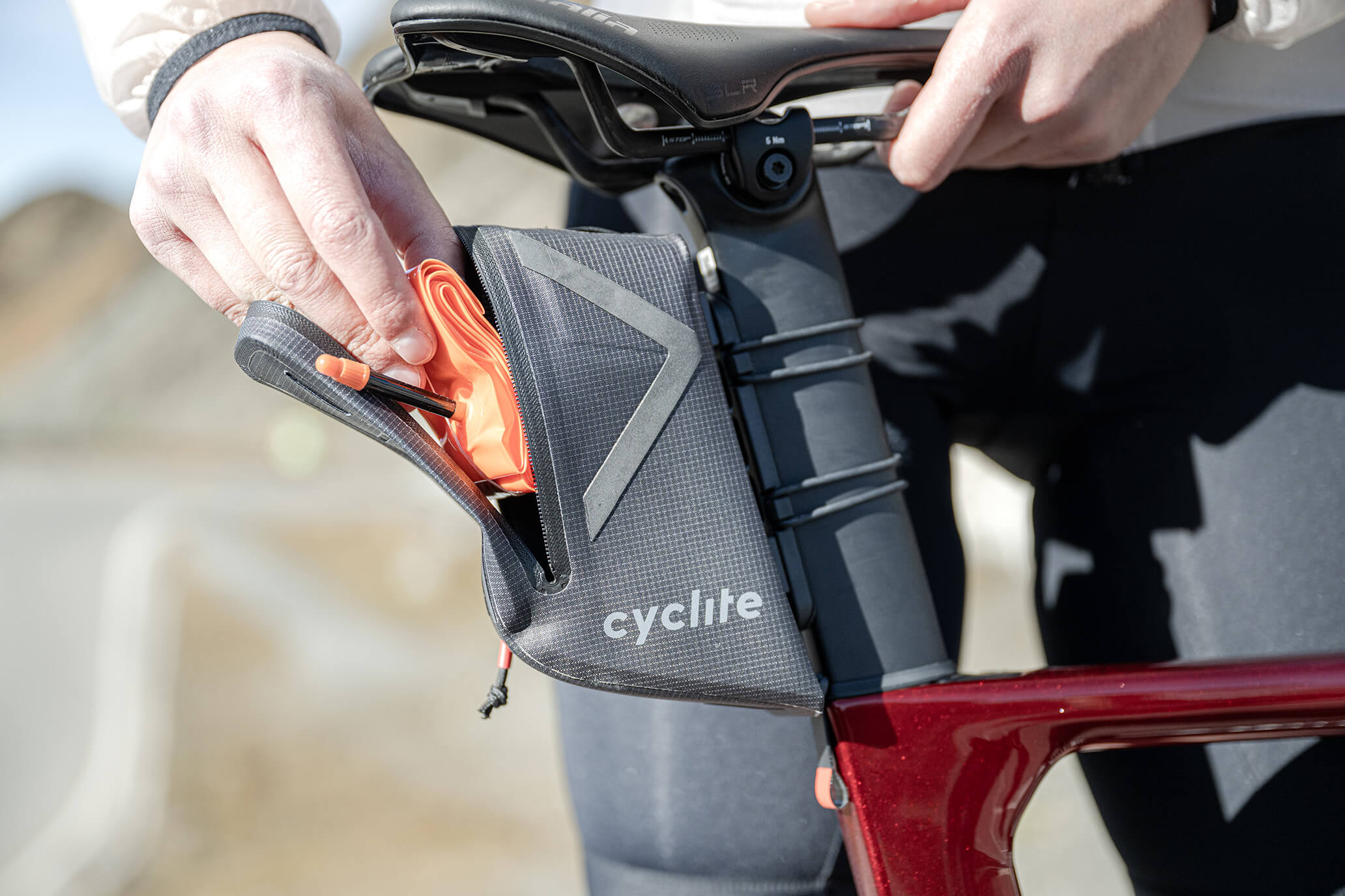

Would it be possible to add threads or bottle bosses into an aluminum seatpost like a Thomson Elite, so that I could mount the new Cyclite saddle bag directly?
I have the skills and access to a metal shop with the needed equipment, I just don’t know if it would be safe to ride afterwards. I’m not worried about the load itself (<200g) but more about material stress.

Hahaha exactly. It’s even worse though - the Cyclite bag is quite small and adds zero functionality to the VéloColour saddle bag I already have. I just saw it mounted on a Canyon seatpost with bosses at Cyclingworld and have been thinking about it ever since.
