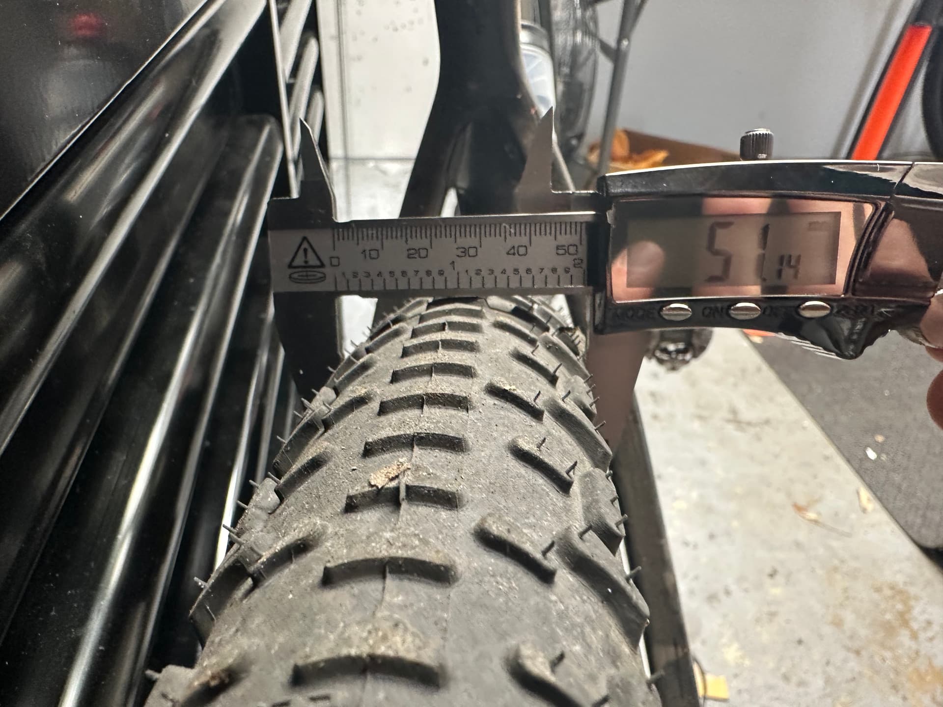

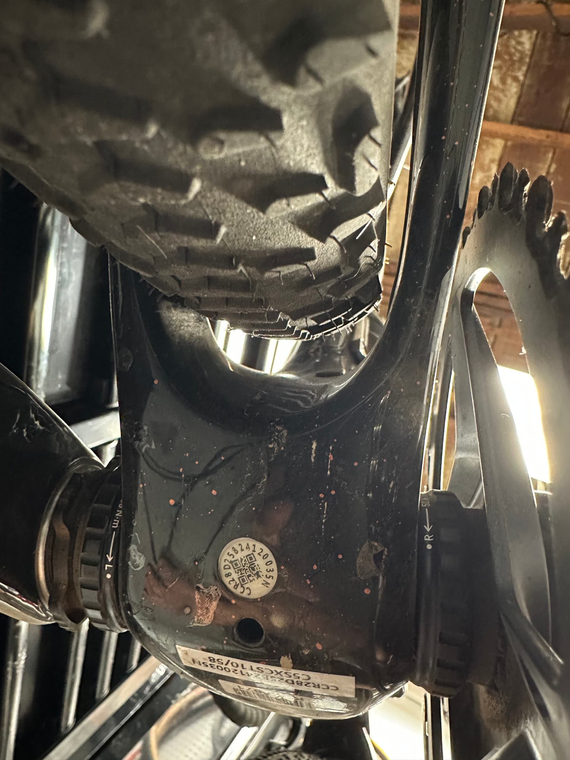

I have the 2025 SuperX and I run 50mm Schwalbe G-One RX Pros with no issues. It’s a lil tight in the rear but I slapped some protective tape on the chain stay and don’t really worry about it.
Can we get a pic of clearance in the rear triangle, from the bottom? I’m intrigued. I’d also love to know the measured width of that tire.
Here you go! These measure a bit wide because they’re on the Reserve 40/44 GR rims, which have 27mm internal width. I have a friend on Zipp gravel wheels with the same tire that said his measure around 49mm.
Interesting….that actually doesn’t look all that bad clearance-wise.
I’ll say I tried Thunder Burt 2.1” and the hairs were brushing on the inside of the chain stay—way too close for comfort
Thanks a ton for those pics. I’m going to procure some fatties now.
