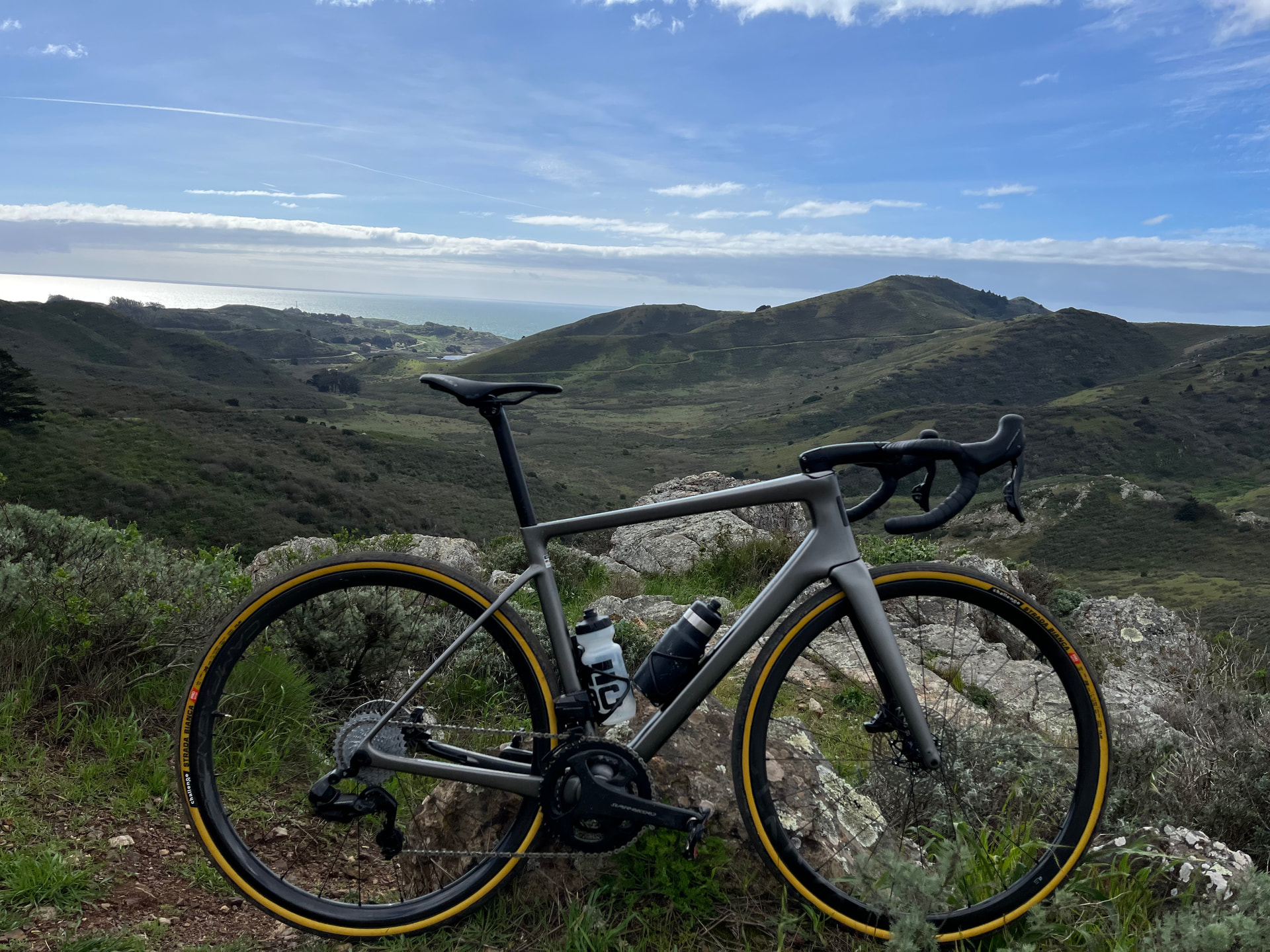

I’ve had it since it was originally released on the bike I ride most often and like it. Nothing is perfect and I too am not racing it, but it’s been good. A pleasure to use for the most part. Reliable. Attractive. Would prefer a little faster shifting, which I believe WRL13 is. I reprogrammed the shifter buttons so top button acts like thumb shifter would, which seems more intuitive to me. Campy app is fine, not great for updating firmware, etc. Seen here in big-tire winter setup on trails, but most miles are typical road use. I have 10-27, 11-29 (SR mechanical not WRL), & 11-32 cassettes to use with it.
