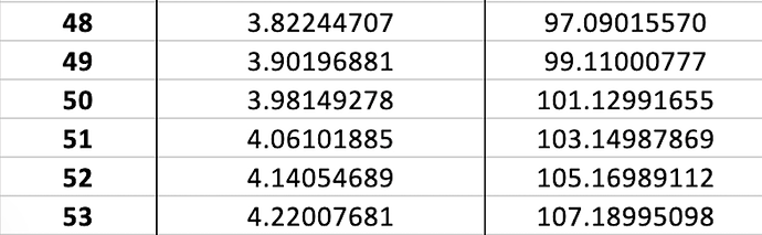

I guess it’s going to depend on the type or age of bike. Here’s a list of chain ring radii. The column on the left is the number of teeth on the chain ring. The middle column is the chainring radius in inches, and the right column is the chain ring radius in millimeters. You should hopefully be able to see if there’s room on your FD braze-on to lower the FD to the right……or maybe more correctly, to lower your FD to account for the smaller radius of the 48T chain ring.
I used to have a Look 595 ( 2008 model year) whose FD braze on barely allowed me to drop the FD enough to use a 50T chain ring. I’m kinda thinking that more modern bikes are more likely to have FD braze-ons that will allow use of a 48T chain ring.
Please ignore all the decimal places. I forgot to format the cells to 2 decimal places for the center column and 1 decimal place for the right column.

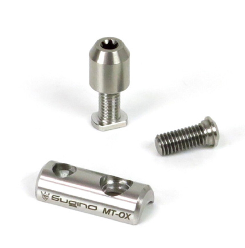

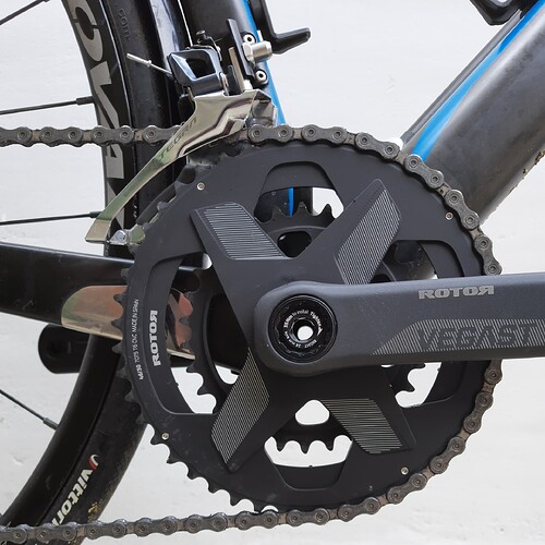

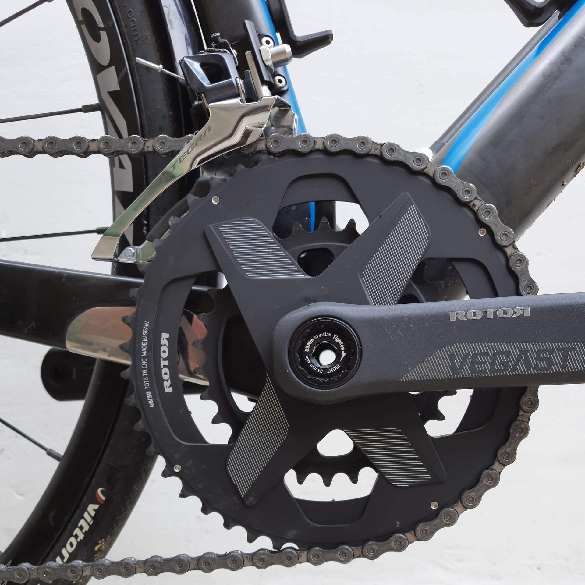

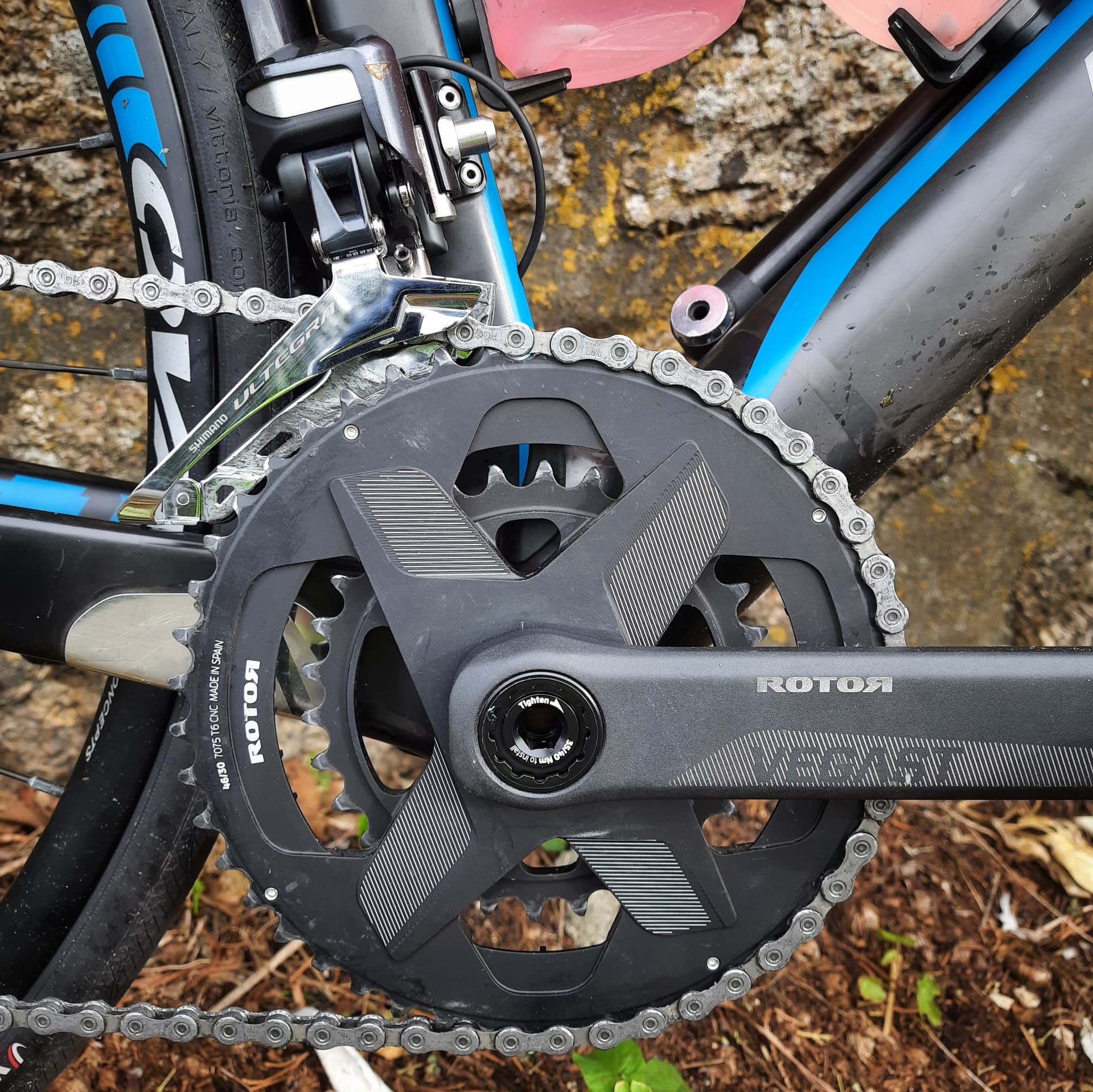

I successfully used the Sugino MT-OX mount adapter to lower the braze-on Ultegra FD far enough to work satisfactorily with my Rotor 46/30 crankset.
Same here. My gravel bike has Ultegra 6800. I bought the Bikingreen 46/30 and it’s working great. My FD mount is the band type that can be moved, fortunately.
