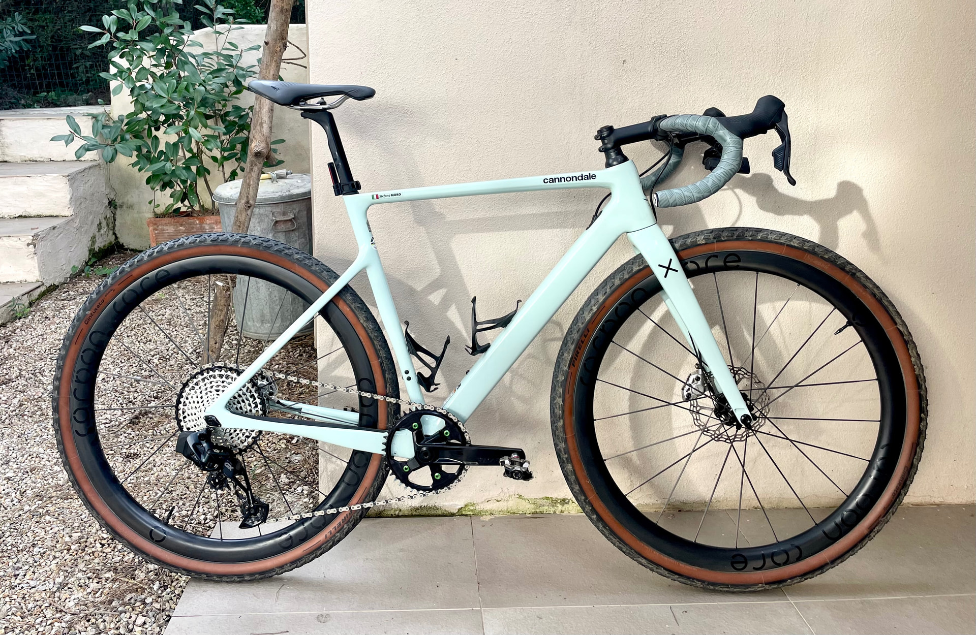

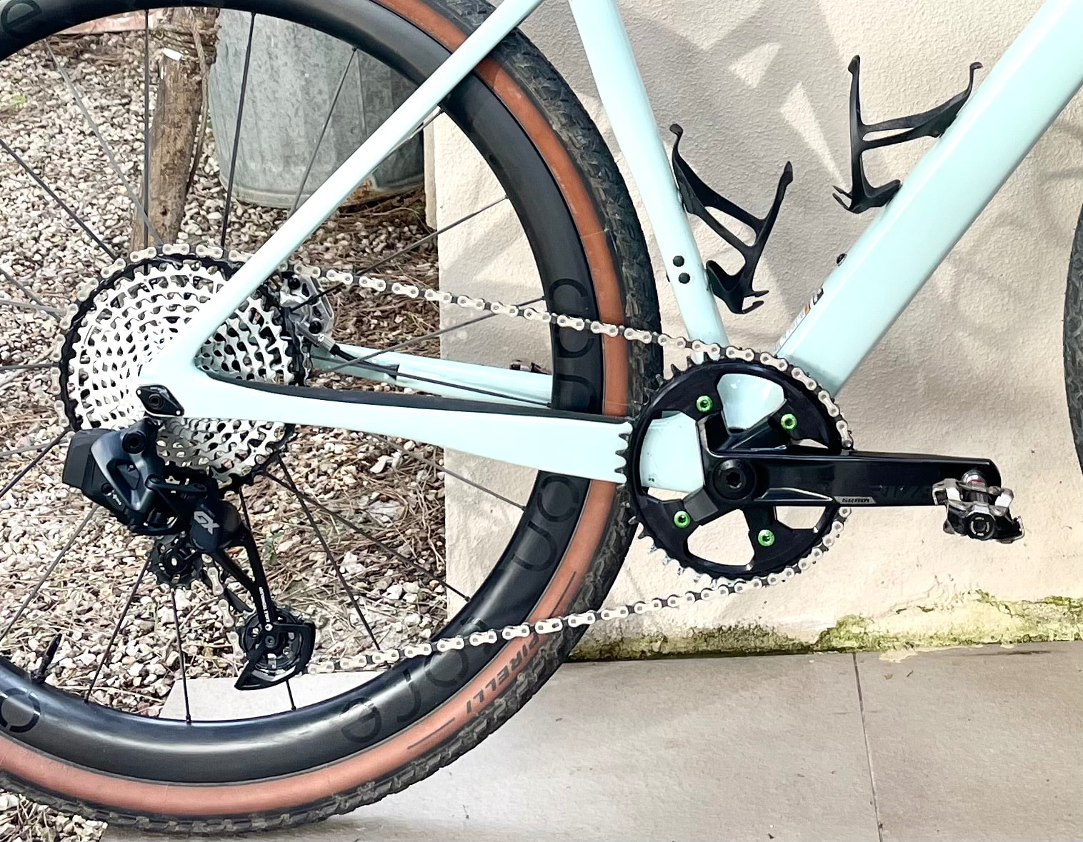

Update for any interested:
Here is where I ended up: Garbaruk 10-48 cassette + 42T CR for 4-bolt Rival spider, Sram Eagle GX AXS RD + Eagle chain. Waiting for Wolftooth chain catcher as the last bit to finish it up.

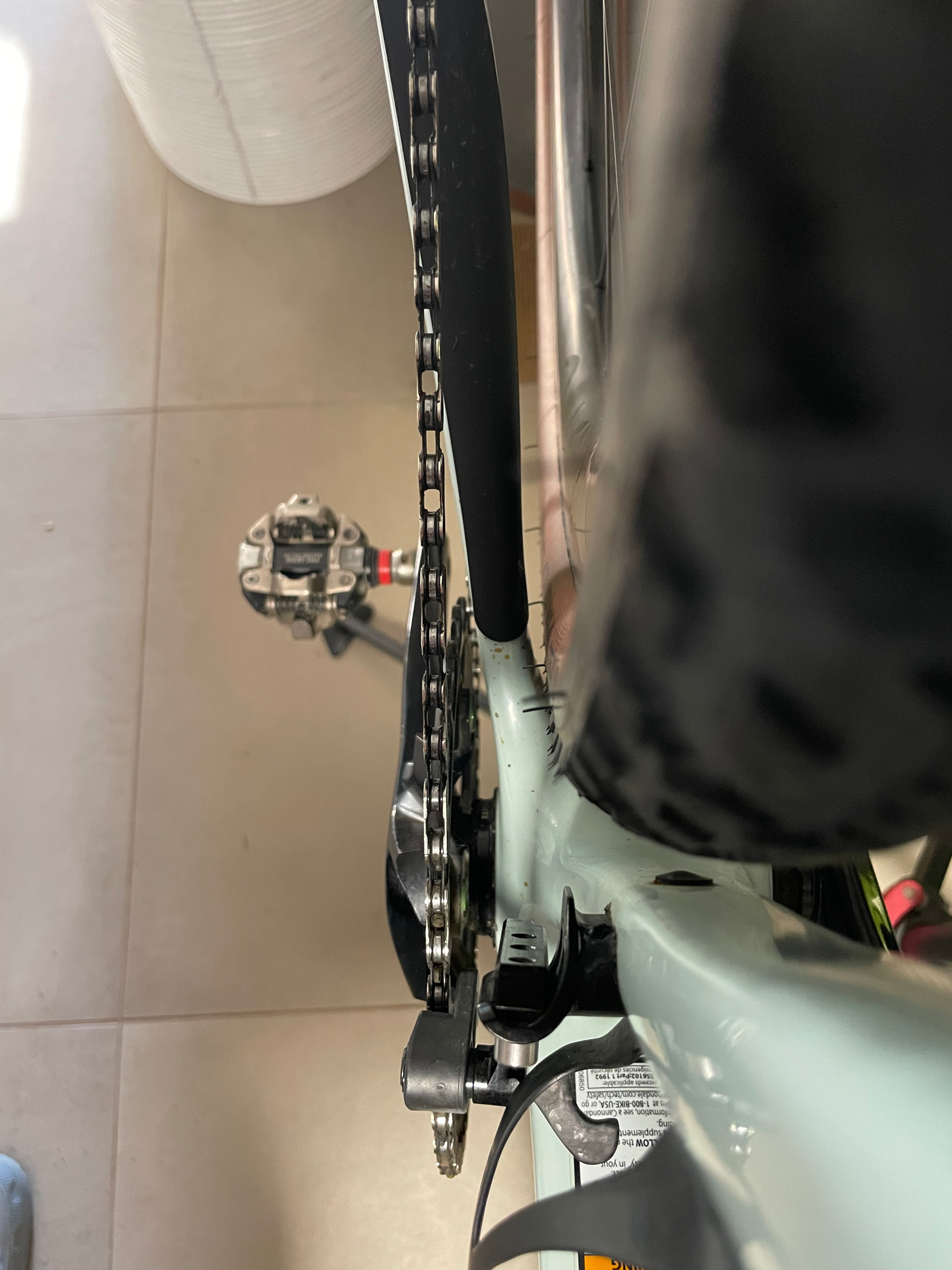

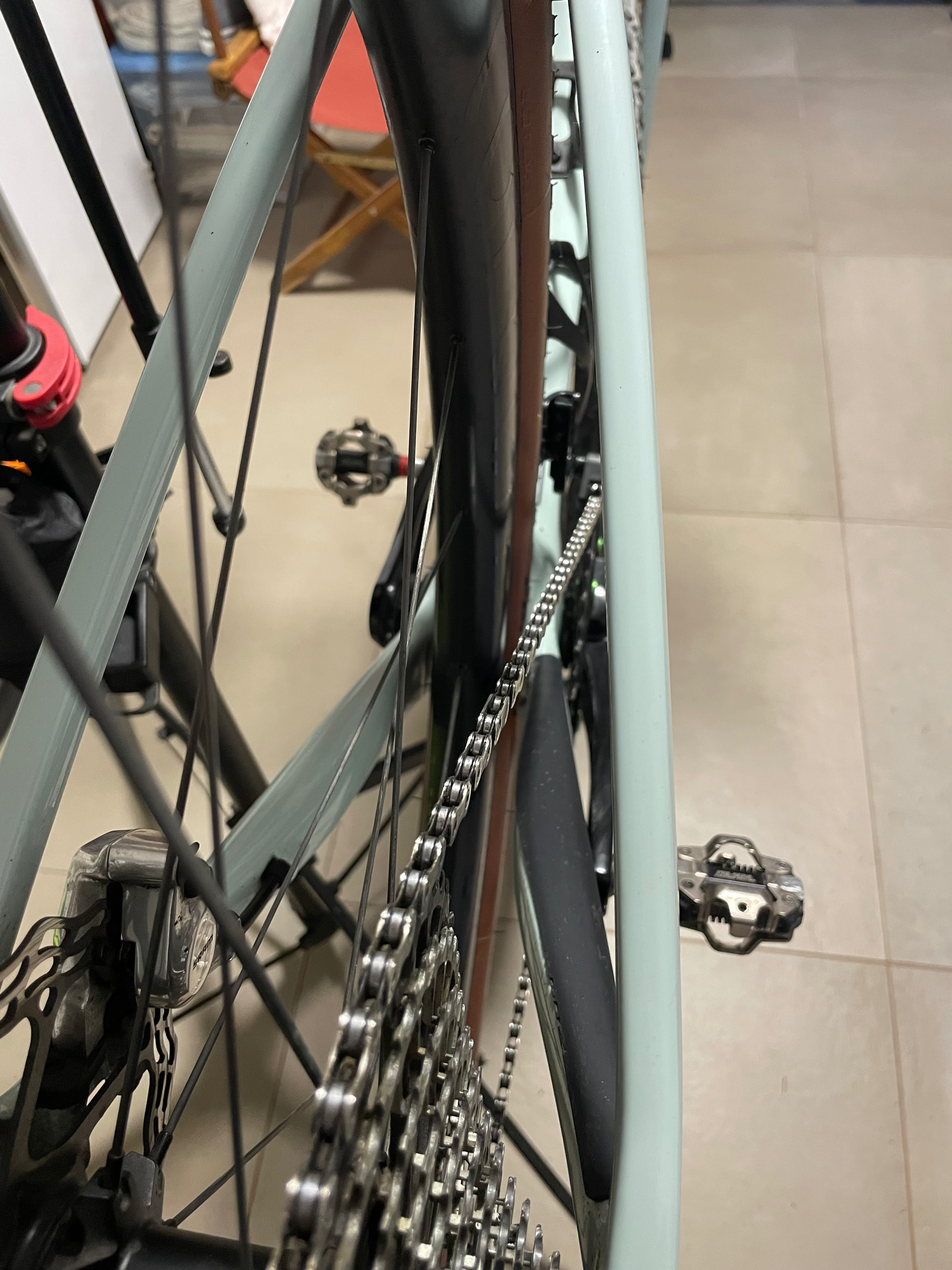

Reviving this old thread as I’m curious how the clearance is working out for you with the Garbaruk ring. I also run a mullet 1x with (out of spec) Dub Wide cranks on the Supersix SE, albeit with a 46t Wolftooth chainring. The clearance between chainring and chainstay is super tight for me. Obviously a combination of relatively large chainring with a crankset that is narrower than the intended Ai cranks…
I’ve been thinking about modifying the setup to something either in spec, or offering more clearance as I’m thinking forward to events like Unbound next year, where that clearance could become an issue. Did the offset on the Garbaruk ring make a noticeable difference for you?
Hi there, no issues whatsoever so far. Plenty of clearance, consider that I am running a Garbaruk 10-48 cassette too. I thought it would be better to run both from Garbaruk. Riding on 47mm (measured) Cinturato M at the moment.
