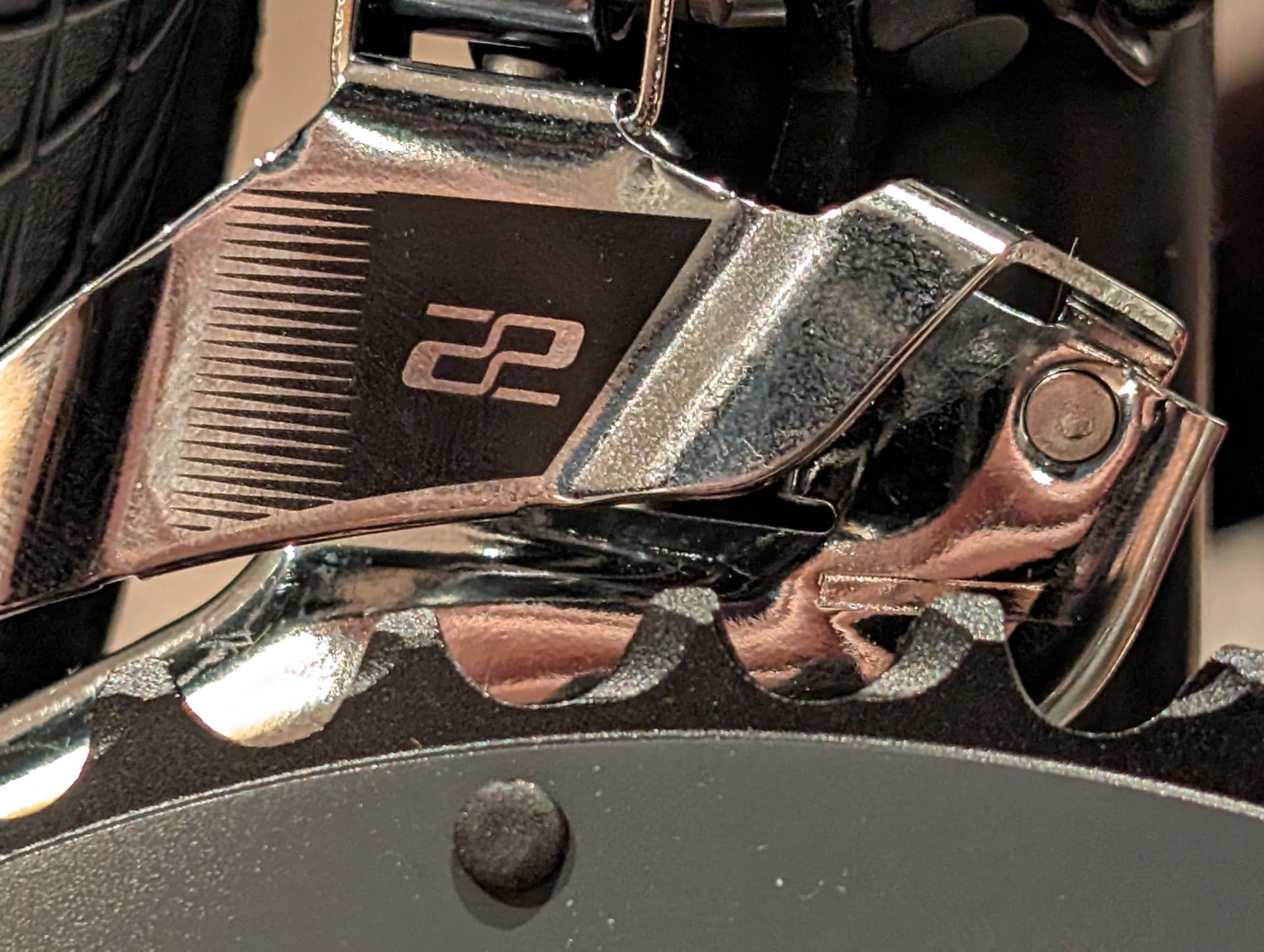

I’m installing a NOS SRAM Force 22 groupset on my bike, and SRAM’s instructional video for yaw derailleurs says to use the guide marker on the inside of the cage for initial setup as long as you haven’t fiddled with the limit screws, but that seems to set the cage too high (5-6mm gap). Should I ignore that and go with the usual 1-2mm that’s also recommended by several other YouTube mechanics for these derailleurs?
Stick with that guidance in my experience - as long as the limit screws end up where they need to be the gap shouldn’t be a problem.

The guide line can only be used the first time because the limit screws are set up a certain way at the factory. Once they’re adjusted, the line becomes useless. SRAM doesn’t help by stating that you should use the 1-2mm method in the written instructions either, and their setup video on YouTube leaves out steps.
Leonard Zinn has written a good article about it. https://velo.outsideonline.com/road/road-racing/technical-faq-breaking-down-the-setup-for-the-sram-yaw-front-derailleur/
