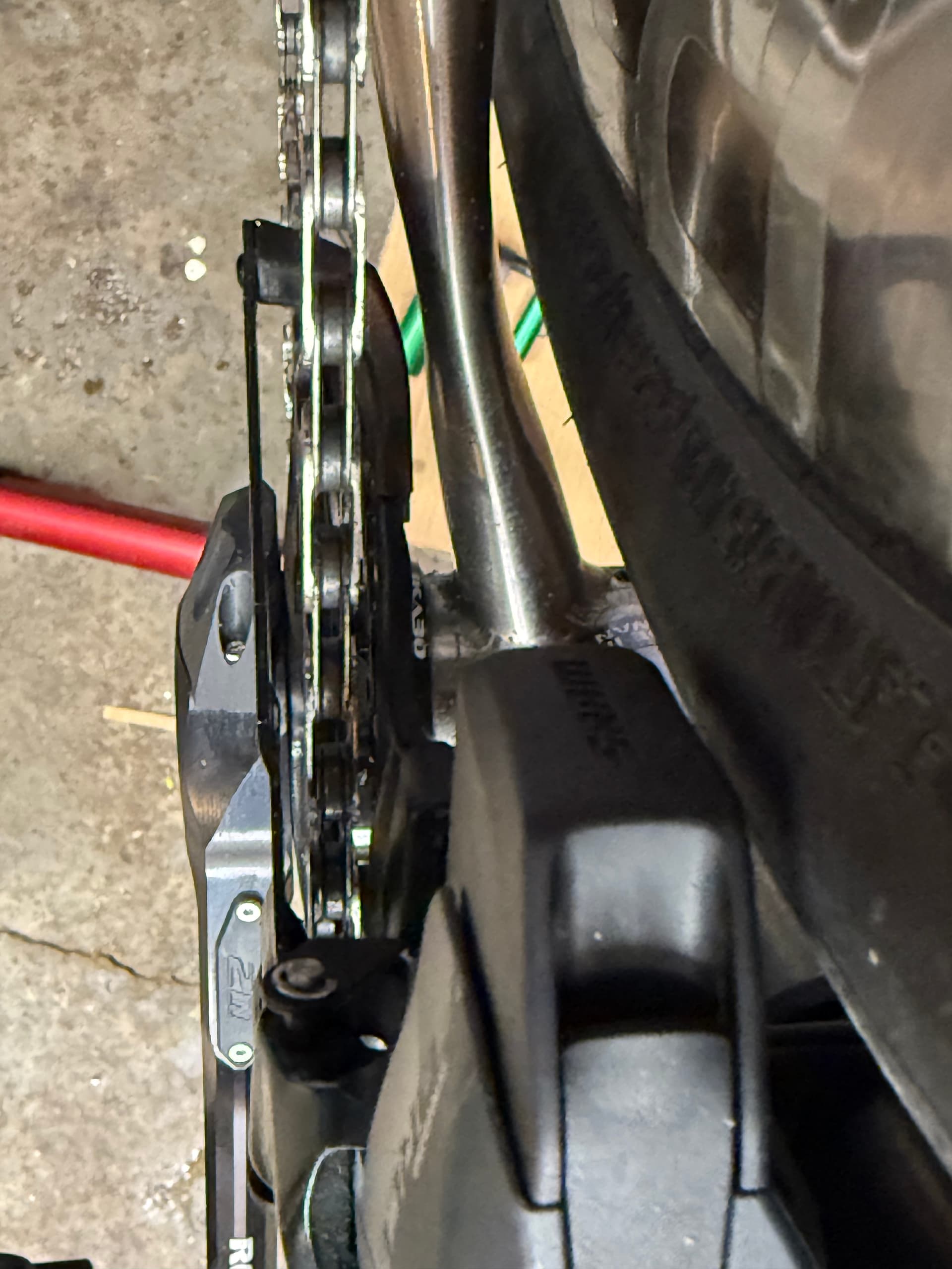

I have a Foundry Flyover with Sram Force AXS. I installed a Rotor 2INpower crank with Rotor 48/35 AXS compatible chainrings. I CANNOT get it to shit up into the big ring. The high limit screw seems okay:
Here’s video of it not shifting
I used the SRAM FD setup tool, I verified the chain length is correct, if I move the high limit further out it hits the crank. Also, the rings are brand new, so there shouldn’t be an issue there. Any help greatly appreciated!

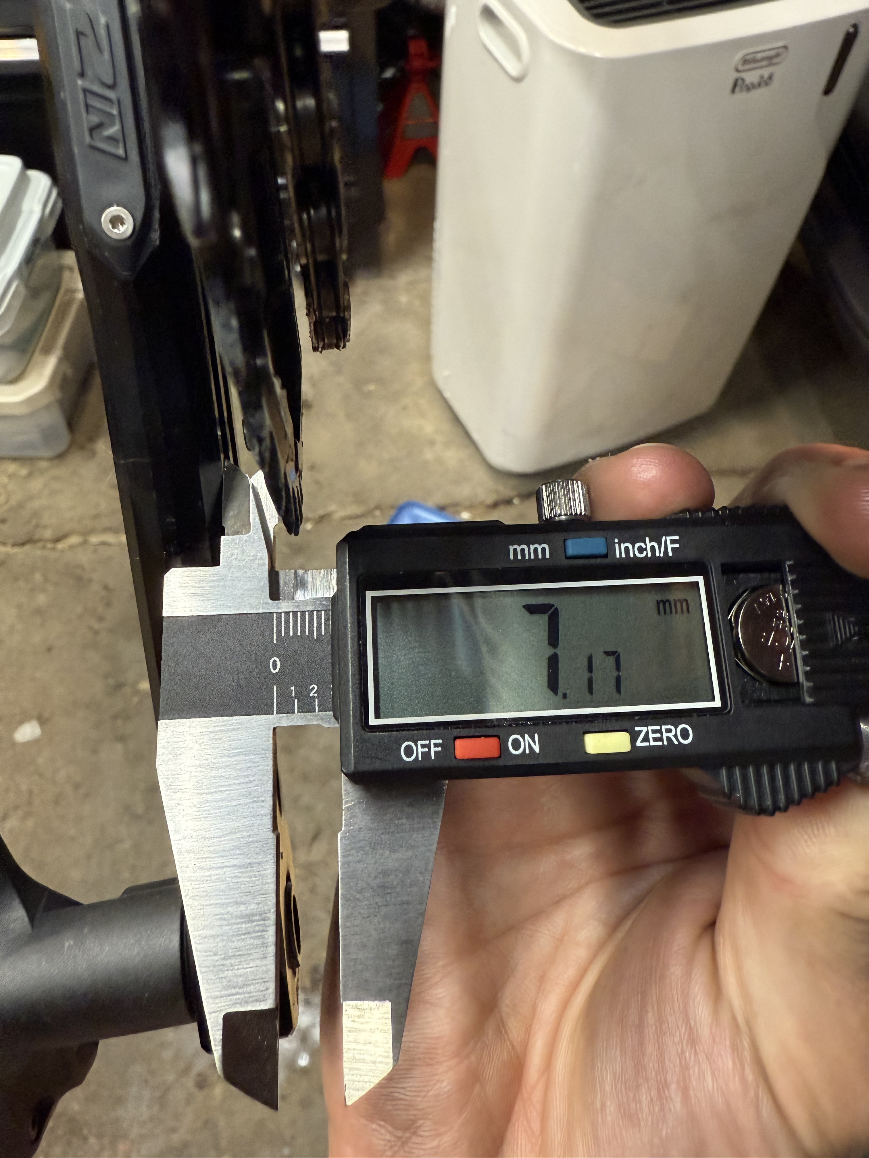

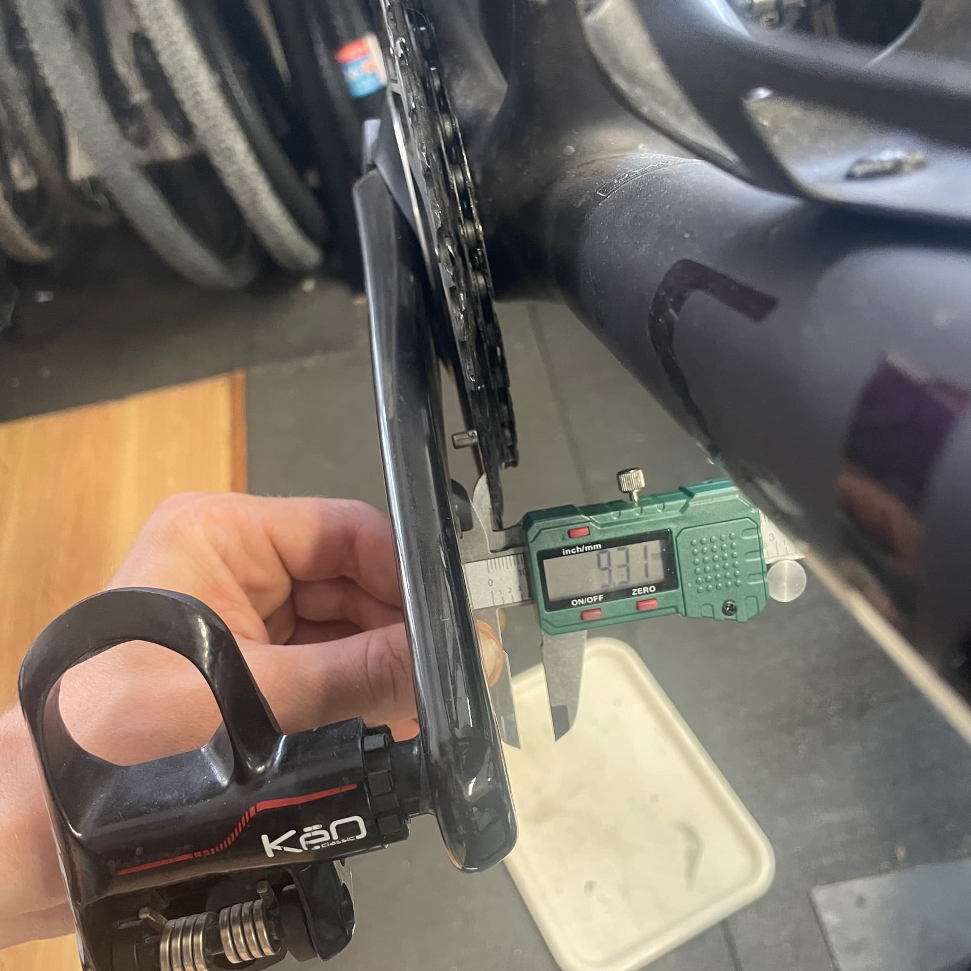

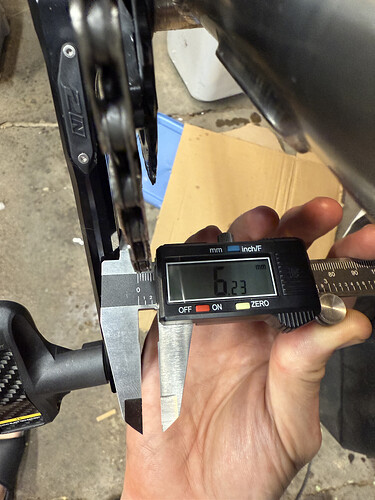

Did it shift before the crankset swap? Can you measure the distance between big chainring and the crank? The rotor chainrings were never the pinnacle of shifting but usually they at least shift.
It shifted fine with a SRAM crankset. Which part of the chainring to the crank?
Without the chain on the ring
Do you have the spacer correctly installed that slots between the FD and the frame?

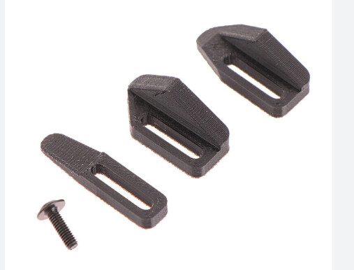

The FD is mounted on a clamp. I didn’t need any wedges with the SRAM crankset, do you think that would help with this?
When the FD pushes the chain over, the force requires can flex the FD back towards the frame, which leads to shifting issues, maybe not even able to get the chain in to the big ring. It could be that with the SRAM crankset it had enough ‘help’ from the chainring design, but it needs a bit more juice with the rotor.
The spacers stop the FD flexing under load, and are pretty much mandatory.
Cool, I’ll give that a shot! Any advice on choosing between wedges, or is it just trial and error?
Completely depends on you frame, you need to pick the one that fits snugly. I’d imagine there’s videos on youtube.
Tried all 3, still no change
