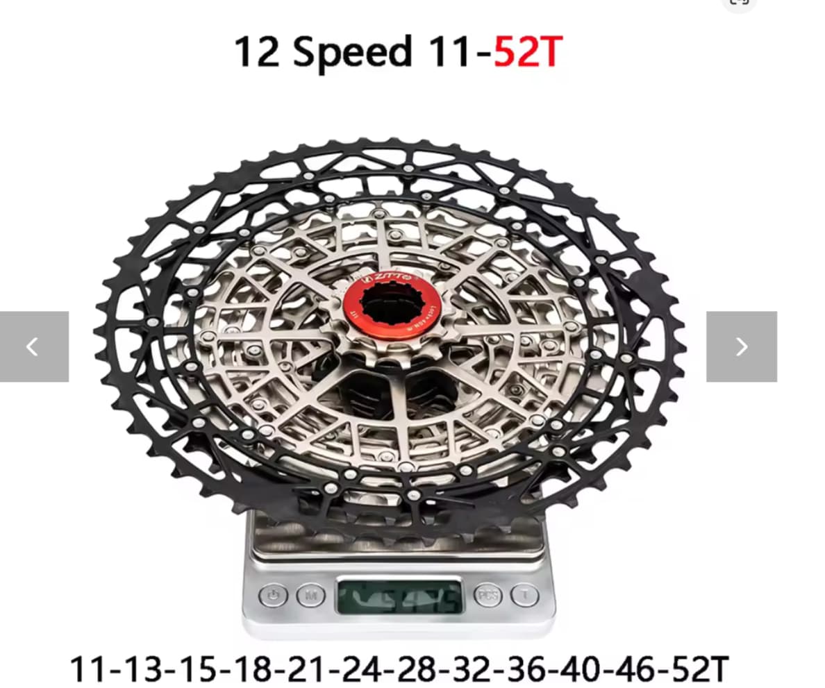

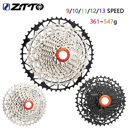

@ Mark: Is 11-39 a typo?!? If not, do you have a link please?
Made by Ztto:
They also do an 11-40 and 11-42 but they don’t have the 12t sprocket, which I am not keen on. Seems to be shifting okay on the stand but I will give it a good test over the next two weeks whilst on holiday in France.
