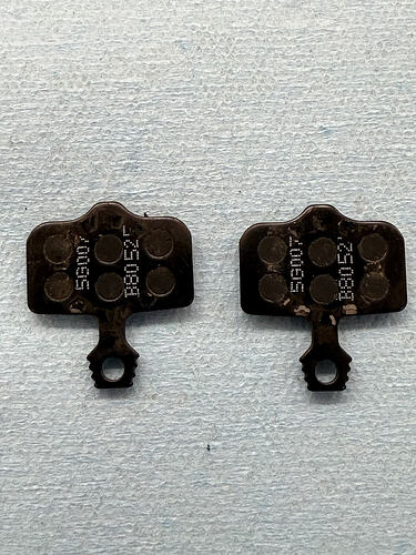

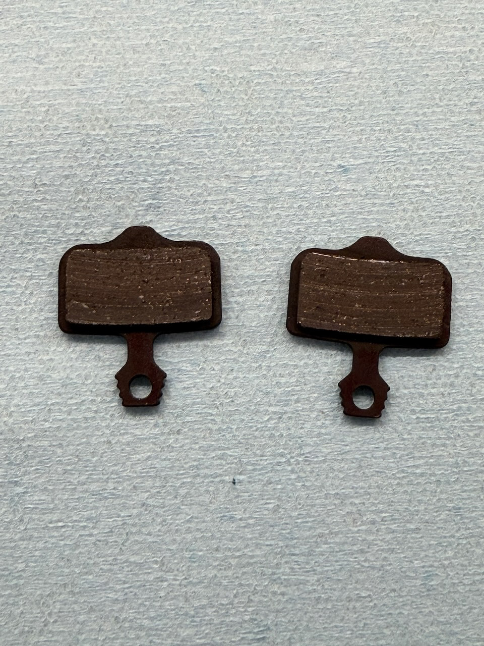

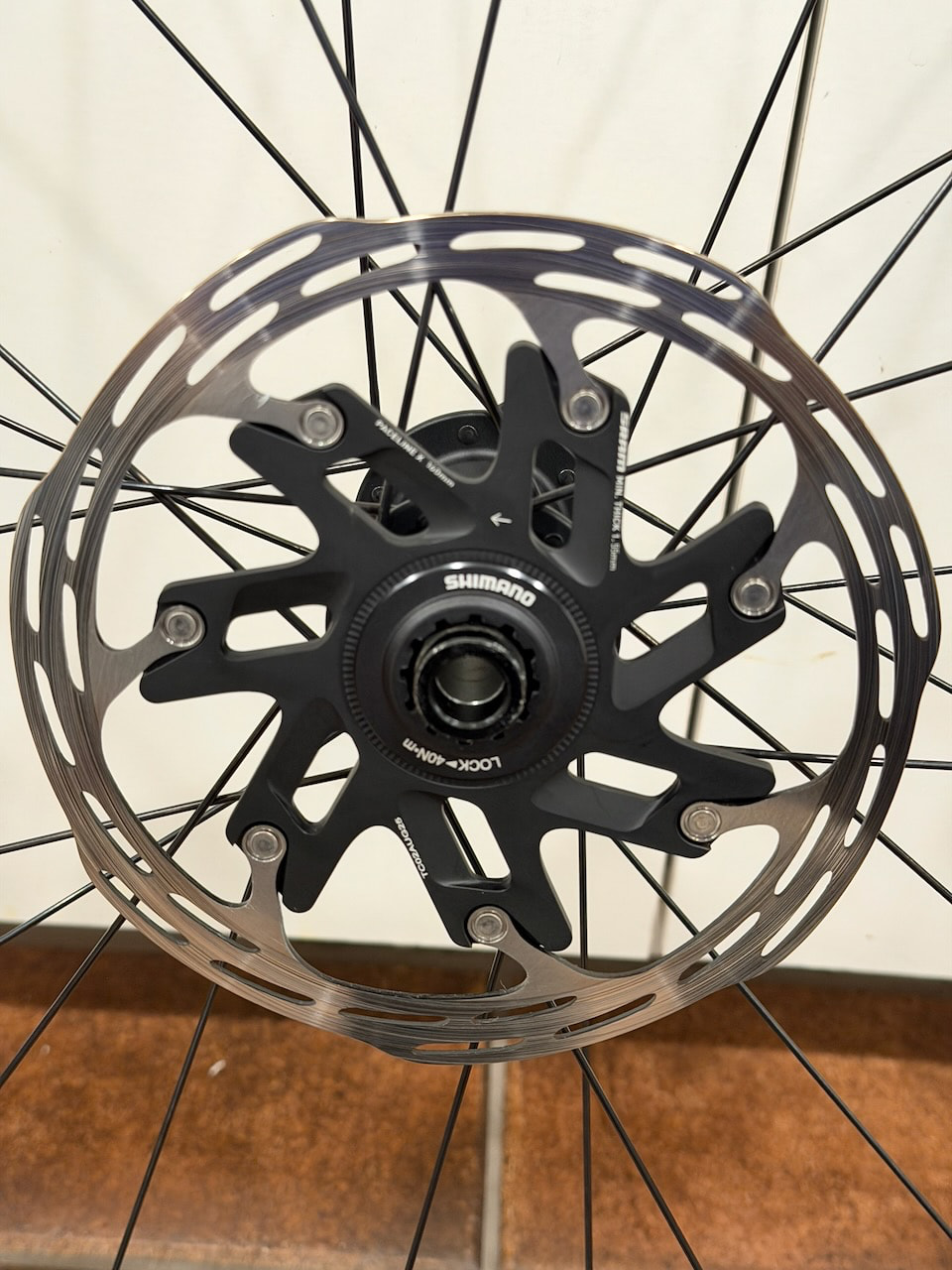

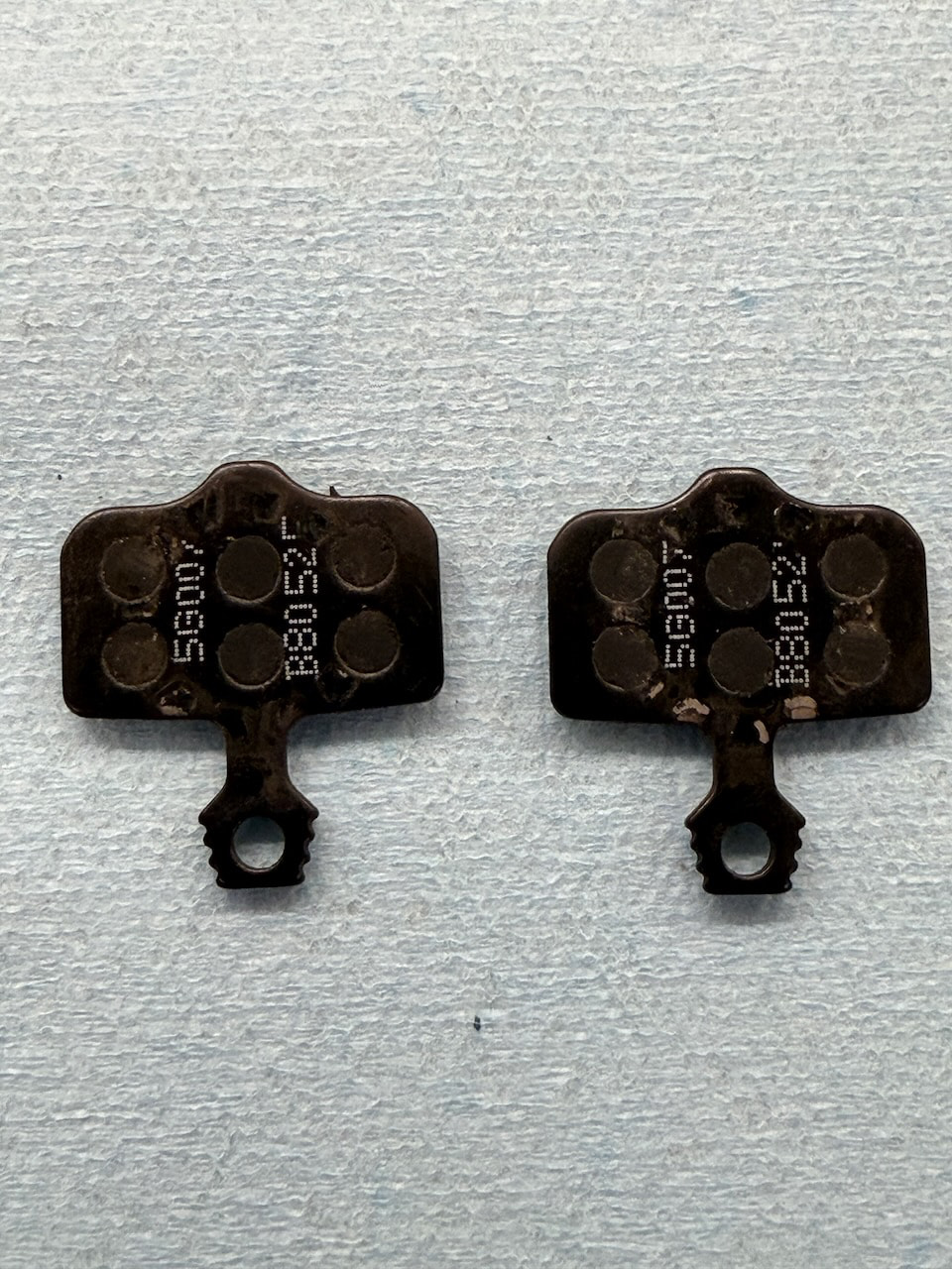

I removed the pads yesterday and there was no indication of leaks on the back of the pads. I’ve attached photos of the pads and rotor prior to cleaning them with isopropyl alcohol - would love some confirmation if they look ok or if there’s an obvious issue. After cleaning and reinstalling, the noise was still there. I didn’t try sanding pads or rotor this time, as I decided to order new Galfer pads, a new 180mm Centerline disc (decided to size up in case that helps with heat) and adapter.

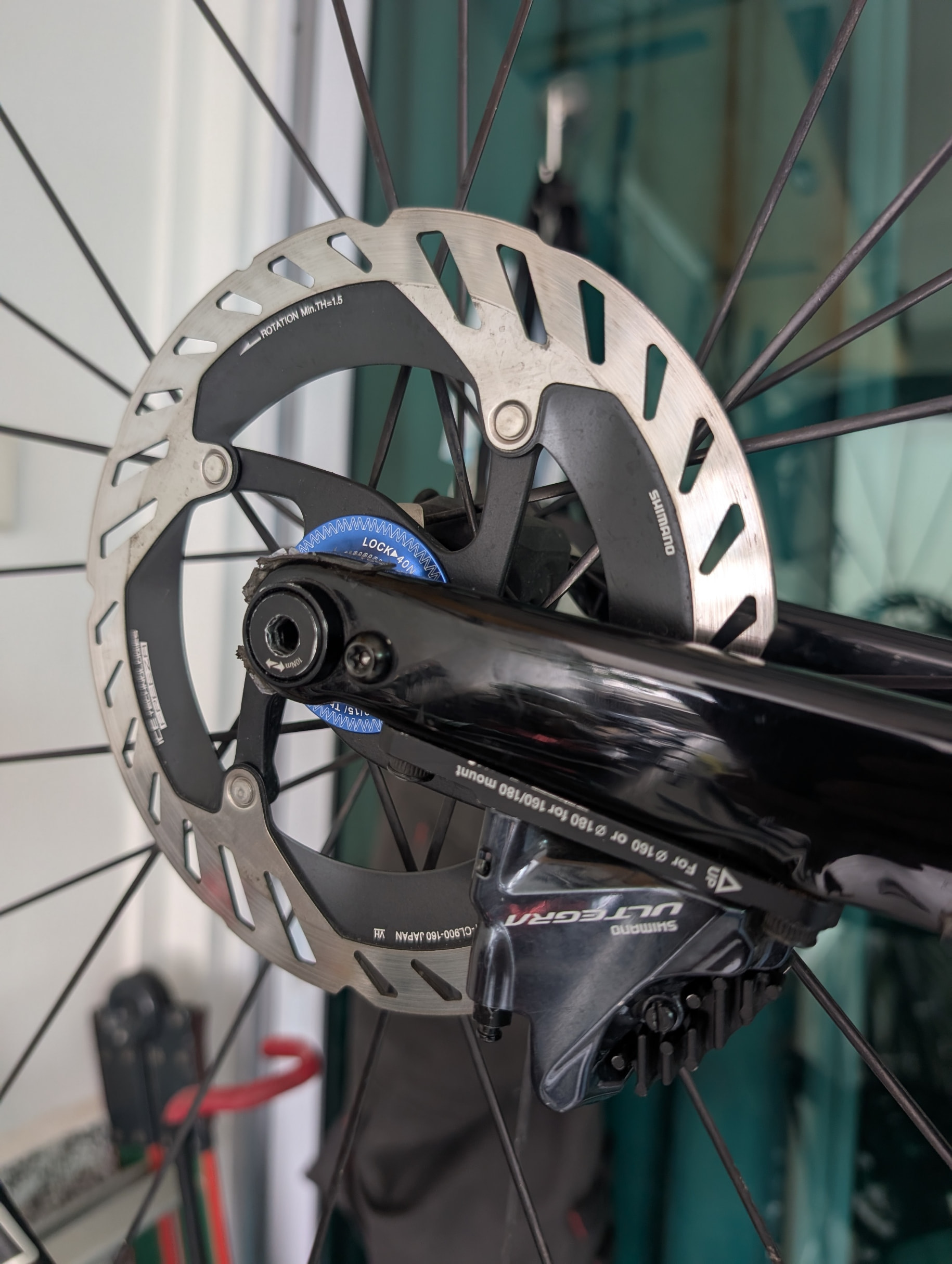

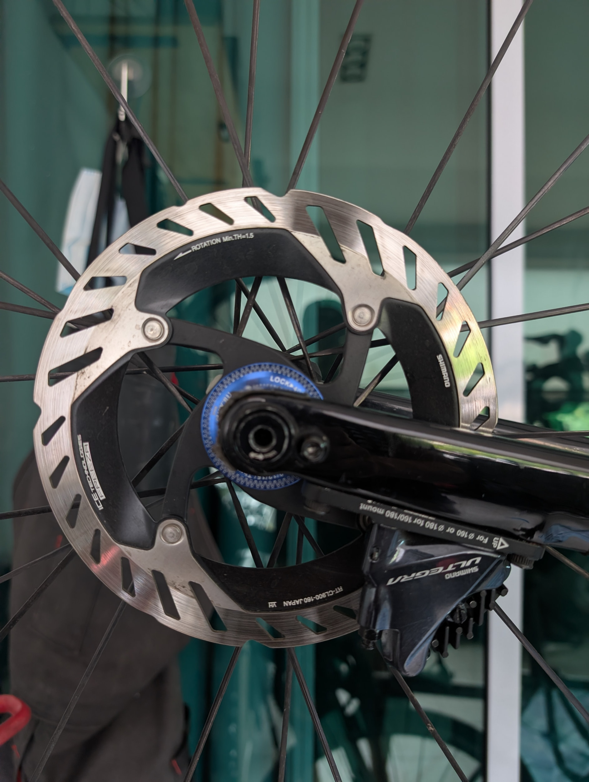

I got similar noise on my 12-speed Shimano Dura-Ace brakes occasionally and they go away after I clean the rotor and pads with Silca’s drivetrain/brake cleaner (I just spray onto the rotor and into the brake caliper and wait about 5 minutes before hosing it off). On my gravel bike with the Force calipers, I only get that sound immediately after washing my bike, when the pads are still wet.
@LAStu, can’t really tell the conditions of the pads on account of poor eyesight, and the colour of the backing plate.
The rotors however, look a little contaminated. Looking at them, from the 9 o’clock position to the 12 o’clock position, you can see how there are gray-ish streaks along the circumference of the rotor. I’ve attached images of mine, for reference. You’ll see how they’re cleaner with near zero streaks around the rotor, where the pads contact the surface. Some streaks are fine, but yours look problematic.
If you’ve swapped out the pads and rotors, I’d take the added step of running a clean, dry finger around the back of the pads, calipers, etc just to be doubly sure that there aren’t any leaks of note.
