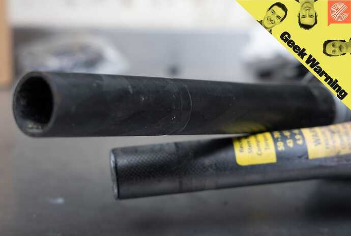

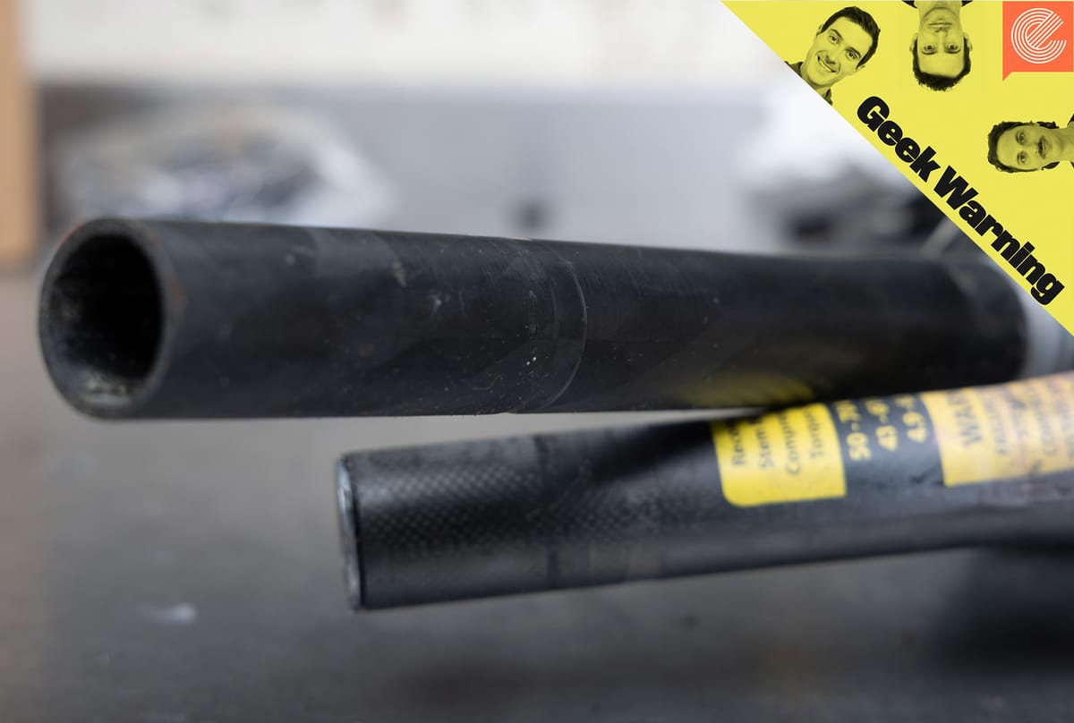

Have you checked for the ring of death…?

ooo! I just had this happen in my chris king headset. I had been getting an uncomfortable extra knocking sound going over bumps but by all the things I checked nothing seemed off (everything tight, no vertical play). Finally noticed the fore/aft wiggle upon riding up a small grass hill while picking up my car from the shop. Upon bringing the bike home and troubleshooting more and dropping the fork out of the head tube (exposed hoses FTW, made this way easier) I discovered and attribute the noise and motion to a sorta spacer-y metal retaining ring was not snug between the steerer tube and upper bearings creating just a couple mm of play. Upon cleaning everything up, re-greasing and reassembling with attention to making sure that ring was snuggly in place and torquing the headset bolt properly before the stem bolts were torqued everything came back together well and has been solid and noiseless ever sense. Also lucky that there were no worrisome marks left by the issue as “ring of death” had come to mind but thankfully my Enve fork is tougher that that or the problem not old enough to have caused any irregular wear.
In my case, it was thankfully not steerer damage but worn headset bearings on my Specialized Venge. If the brake hoses on your Aethos are not routed through the headset bearings, it would be easier to check for worn bearings. With hoses routed through the headset bearings, I let my LBS take care of it.
