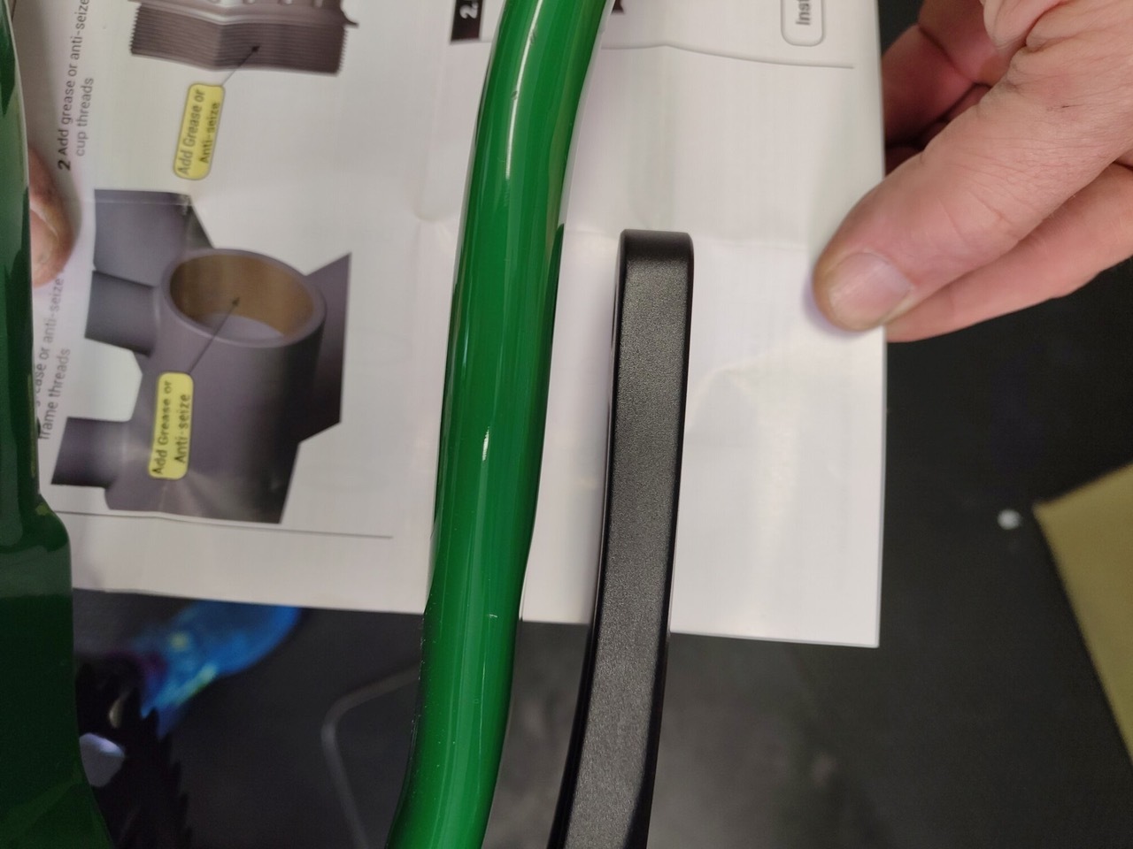

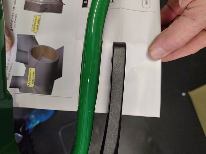

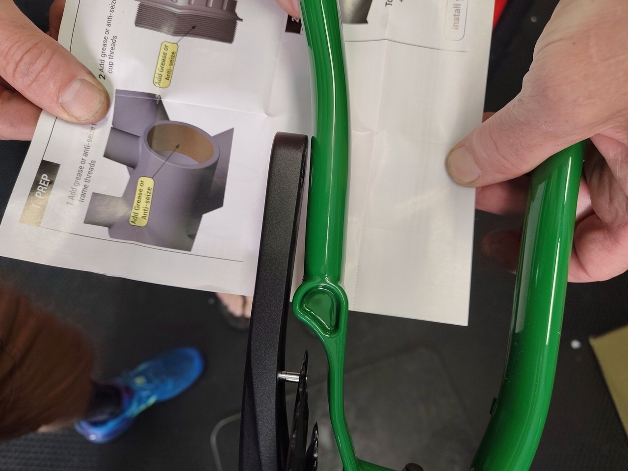

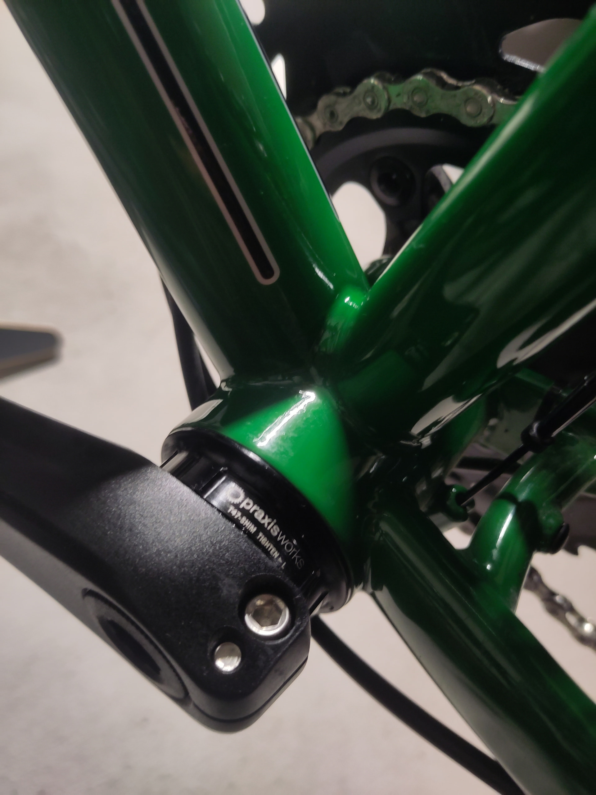

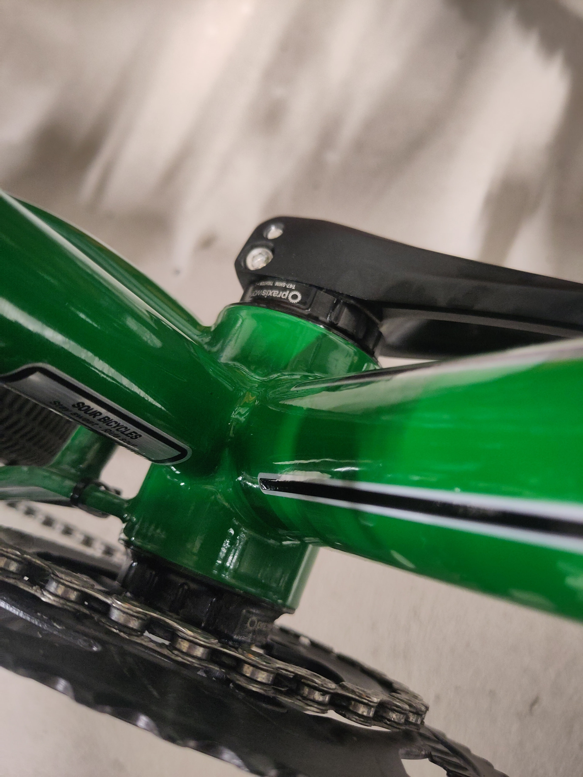

Unfortunately, when I had the frame built up in my local bike shop, it turned out that the chainstay on the drive side is so close to the 170mm crank arm, that they had to shim it to make sure they don’t touch, see pics below. It would also be very hard to install a longer crank arm and I would not feel comfortable reselling the bike should the time come for it. This kind of soured (pun intended) my new bike day feeling..

If you want warranty service, I guess it needs to go back to Sour. But I’d think inspection could be done by any (willing) frame builder, who could also advise about options if they find that the frame is out of alignment etc.
The LBS can easily check alignment. They may have already. I wouldn’t go bending anything. If it’s misaligned you need to go back to the mfg and figure out if you have the correct BB axle and if it’s a mfg error they need to replace or correct.

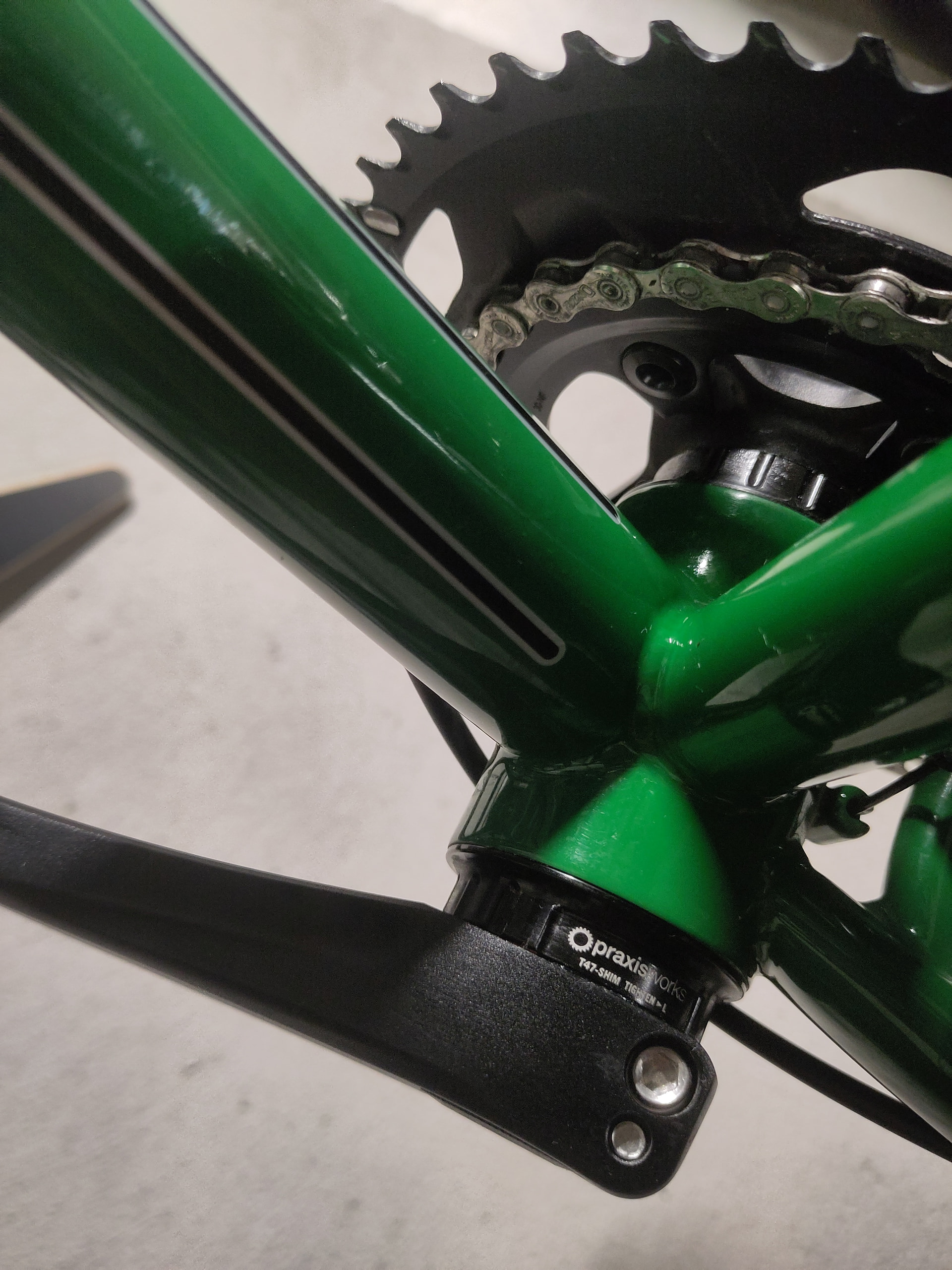

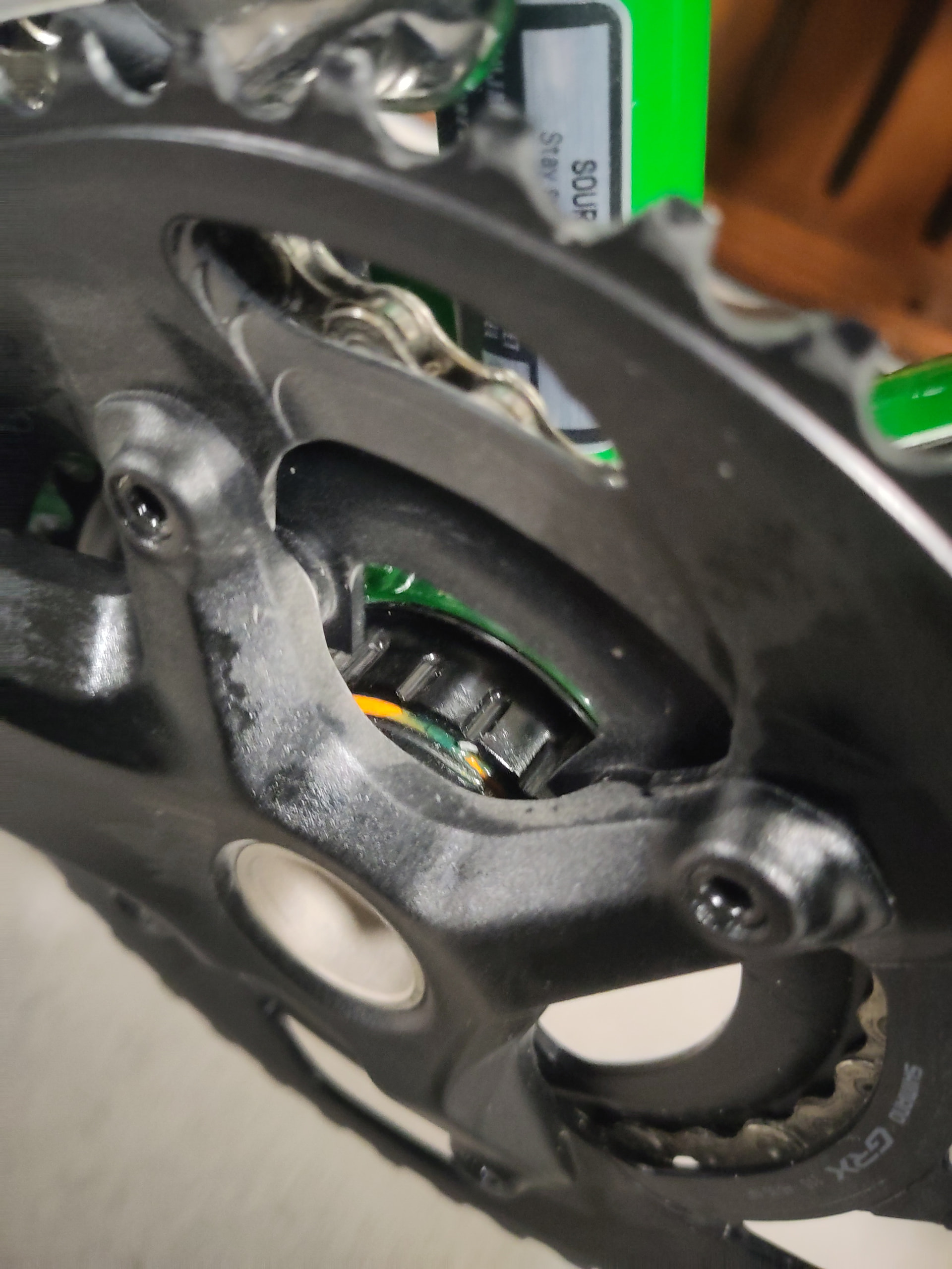

Can you post a picture of the crankset and BB? I don’t want to cast aspersions on the shop that fitted the parts, but it’s not impossible it’s the wrong crankset or BB, or that they’ve been fitted incorrectly.
Will do, was told it is a standard T47X68MM bottom bracket and GRX crank

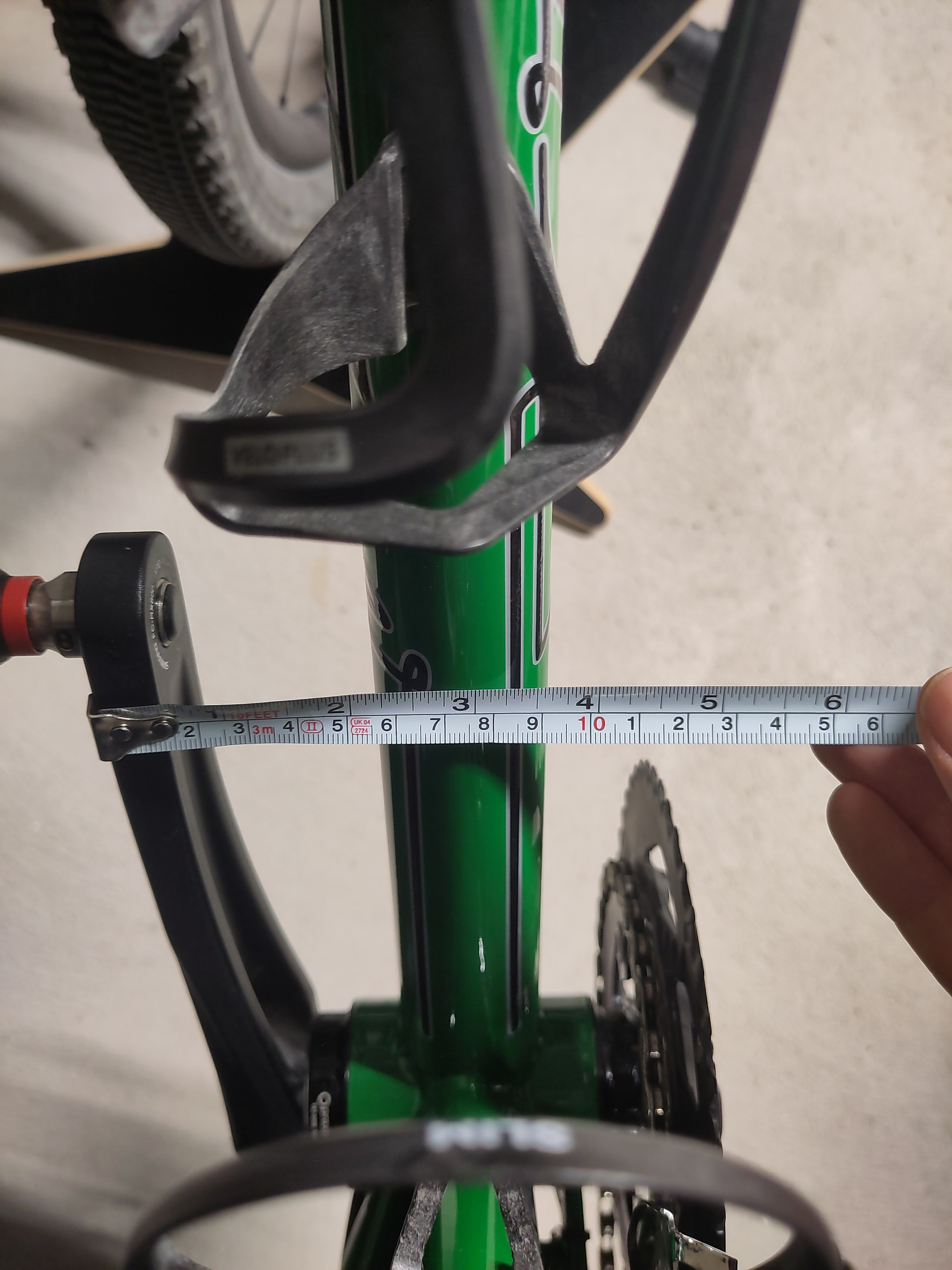

Also, have the cranks been measured from the centre line of the frame to check if they are sitting where they should be? i.e. measuring of the position of the crank end from the centreline? Tricky to do, but worth trying to check.

Looks like they might have put 2 spacers on the non-drive side BB cup when it either needs one on either side or none at all.
I second the request for more pics of the BB area.

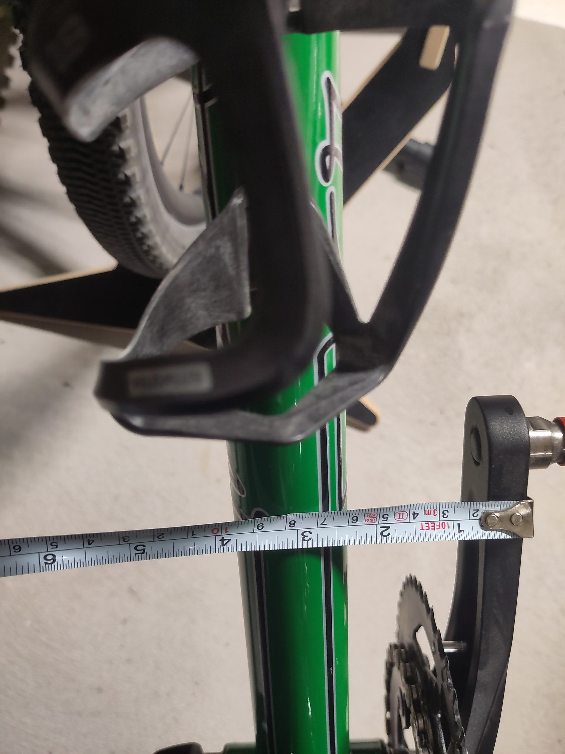

Try rotating each crankarm up until it is parallel to the seat tube and then measure the gap between the seat tube and the crankarm. That should tell you if the crank is centered in the bottom bracket.
This is assuming that the seat tube is on centerline, which is true for most frames. You want the pedals at the same distance from centerline for symmetry.
