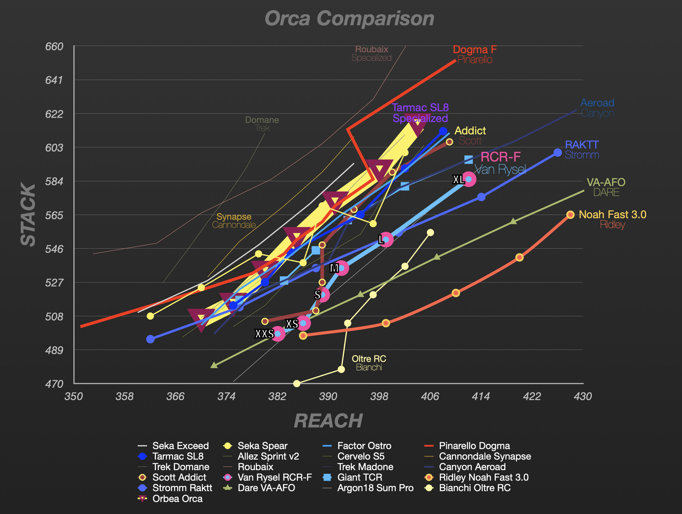

Okay…
49cm Orca Geo (assuming 2025)
Reach: 375
Stack: 515
And sounds like what’s required is 47 Orca’s Reach with +2cm Stack, which is roughly the (51cm Orca)… which looks like…
Proposed Target:
47cm Orca Reach: 370
51cm Orca Stack: 533 (+1.8cm)
Took a look at Orca 47cm vs 49cm and the only other Fit related thing that jumps out is Seat Tube Angle (STA°) which are 74.5° vs 74° respectively, with 47cm being 0.5° steeper (larger number). Not sure how much that impacts wife’s fit. But with that…
Easiest solution looks like any of the Big 3 Endurance models.

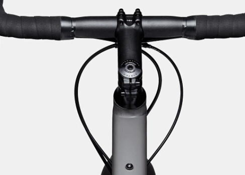

  • Dale also has external hoses on entry level. Can definitely play around with 2-piece frontend to fine tune fit.

dale synapse

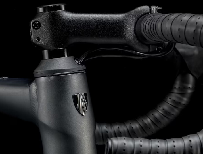

trekka domane
Sorry for the eye chart but this is how the Quick & Dirty thought process went. By digging around more, could prolly find something else.
If your wife wanted something ‘racey looking’ she could also go with these other two that are ‘above the line’ from the Orbea Orca in her size, but she would give up ~1cm of raw stack which could be a deal breaker… Secondly these frames would ideally be built Frame-Up in order to have a platform for fine-tuning Front End. The advantage of frame-up is of course, you can choose your cranks, seat post offset, bar width, and order a couple stems for your project. And carry over your preferred saddle and finishing kits.
  • Pinarello Dogma: (525/372)
  • Seka Exceed (528/371)
  • Proposed Target (533/370)
None of this took into account mandatory spacers and top-cap.
But I hope it’s somewhat helpful…

  • The Trek Domane, depending on spec level, may come with traditional round spacers and regular stem, or with an RCS Pro stem (proprietary stem+spacers, but hoses run underneath the stem not internally). Either way, you can still get a normal 40-ish mm of actual spacers. The RCS Pro stem is available in either -7° or +7° stems as well.
