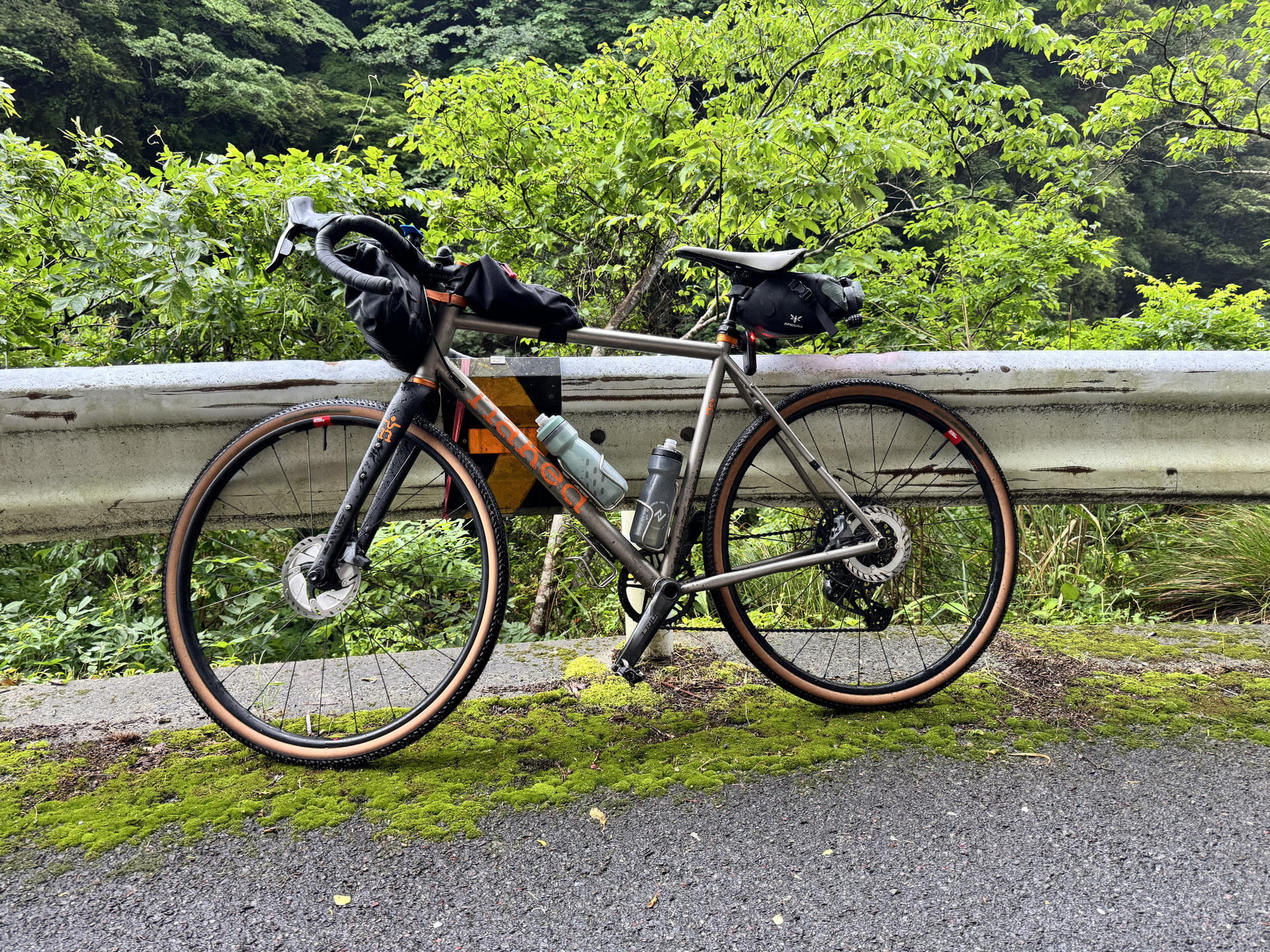

After years of touring with a Surly LHT, I’ve upscaled to a Ti designed, imagined & created Naked. Built on tiny Quadra Island, British Columbia, I’ve toured Naked across much of Western Europe, Korea, Japan, western US & Canada (home). Next up is Morocco, Spain & Portugal. Built with Z couplers, I can fly with my bike as regular luggage. An exceptional build!

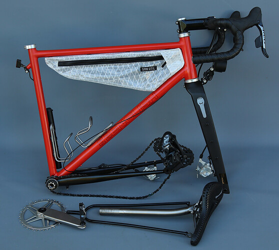

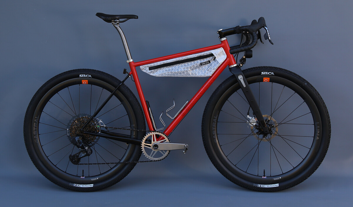

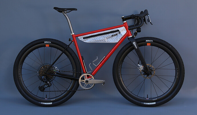

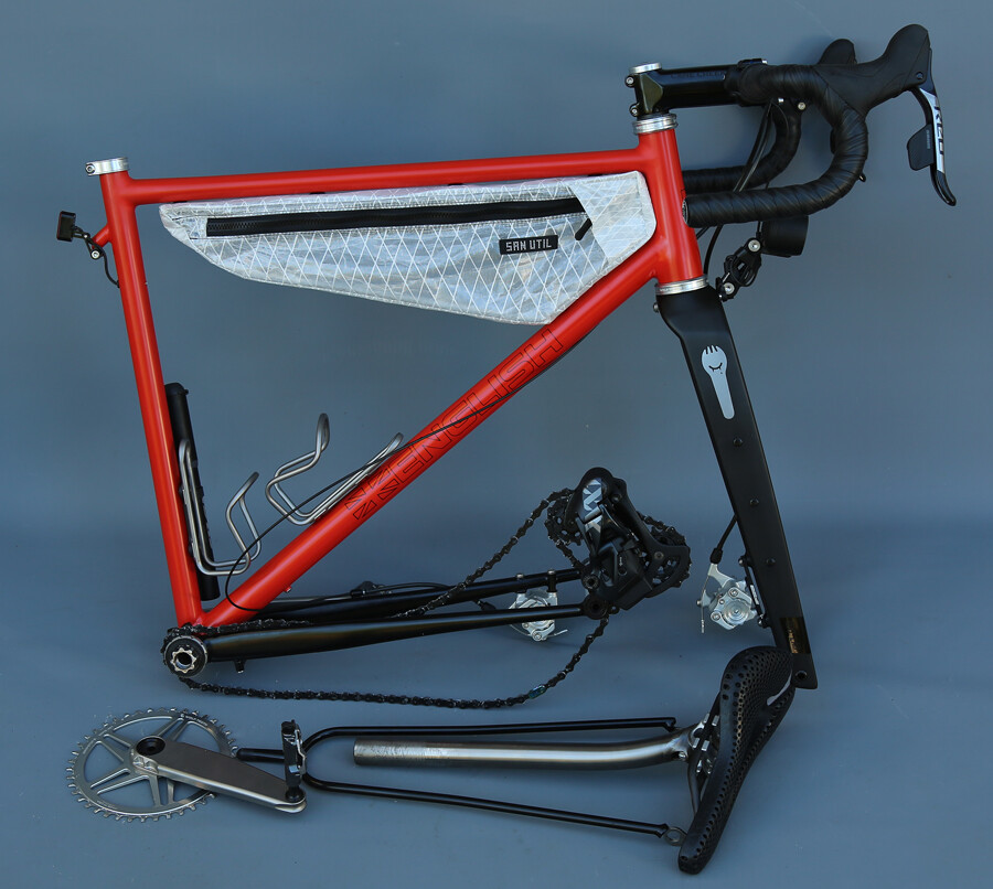

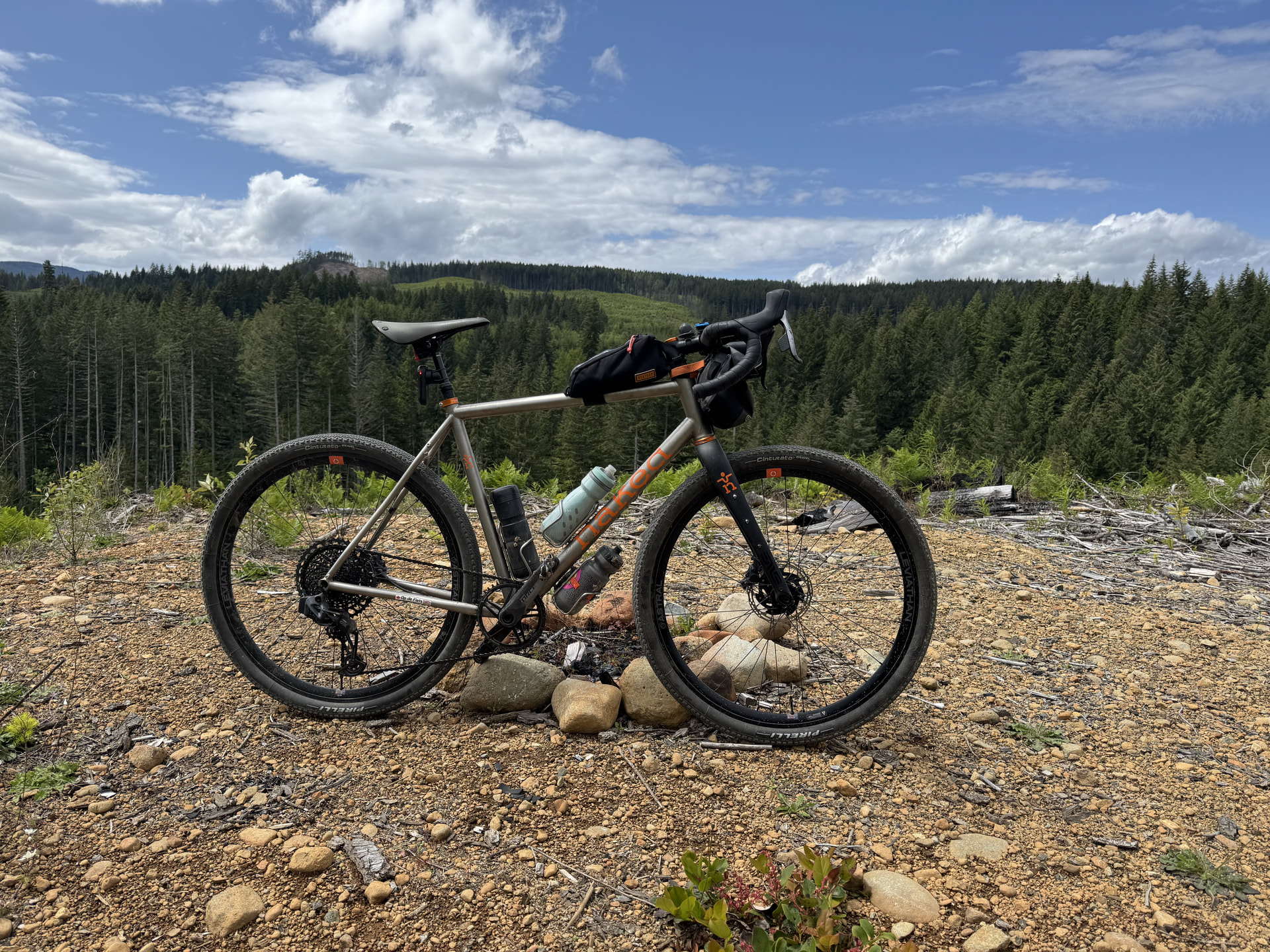

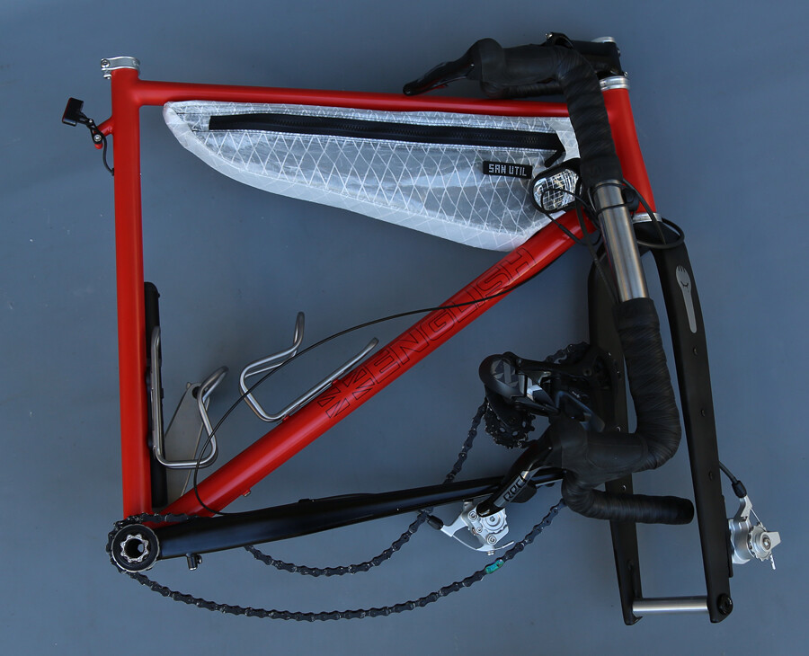

Fun to read this thread - always makes me happy to see some Naked photos :slight_smile: Just thought I would share my solution to bike travel, which adds a folding component to a conventional frame. For packing, it requires removing the driveside crank (but not the pedals), then the frame, fork and stem fit into the case as one-piece, so there is less to move around compared to a de-coupled frame. No need to disconnect hoses either, there is enough slack for the bars to tuck in place. The system adds about 150g to the frame, with no change in the riding properties. Here are some photos of the latest Folding Gravel Concept bike, built for Josh Weinberg who is currently riding it in Japan…

Thanks for sharing, Rob. This is somewhat reminiscent of the Bike Friday folding mechanism in as much as it folds near the bottom bracket, with the rear triangle folding under. I thought about incorporating this into my Douglas Adams/Hitchiker’s Guide bike you built for me…but other design aspects took priority. That, and I already had two Bike Friday folders and several other coupled frames….
Can you elaborate on the details of the rotation mechanism? Is there a bushing? Is there a retention tab or clip to keep the rotating part locked onto the BB shell with lateral stress?

Hi Scott,
The rotation mechanism is a simple clamp with pinch bolts on each side. So once the bolts are tightened it is effectively a solid one-piece structure. No bushing needed as once the bolts are loosened the chainstays are free to rotate.
