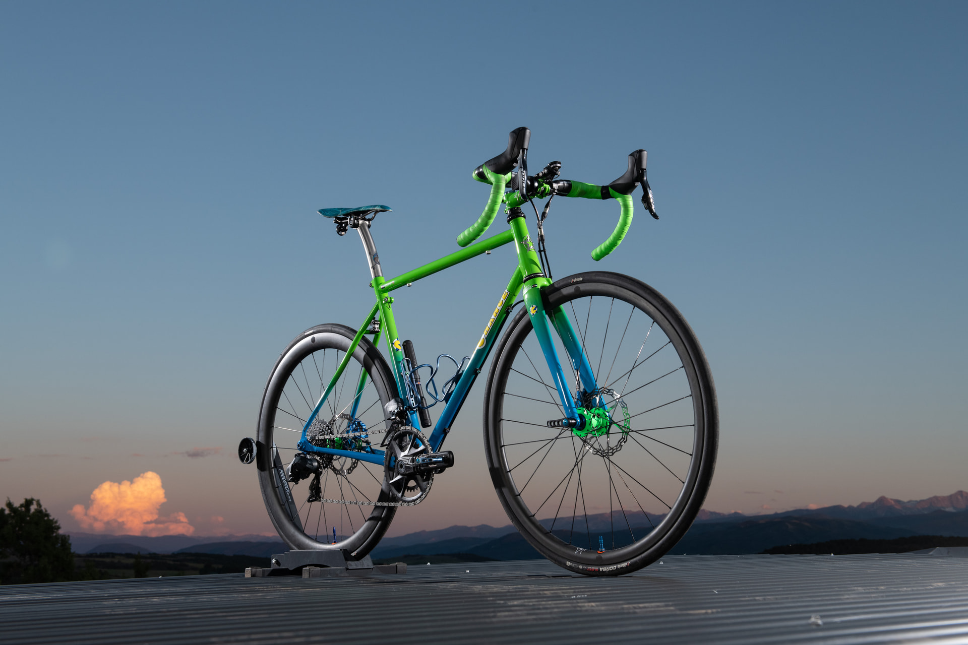

Grey man here, I ticked the “No publicity” box so there are no pictures of me with my bike. However, fellow Canadian Wade reached out and asked me to post a picture of my Canadian made customer Naked travel bike. Luckily Sean asked to take a picture of it in Takayama so here it is.
It’s a Naked Bicyles All road Titanium model. Highlights are standard Paragon Works Z Couplers, colour coded carbon fork and stem, SRAM E1 Red drivetrain, Zipp 303S wheels and custom covered SLR saddle. I’ve now ridden it on three continents and thanks to the S&S hybrid case I’ve never paid a penny in luggage fees and easily negotiated subway escalators, high Belgian train steps and sub compact car trunks.

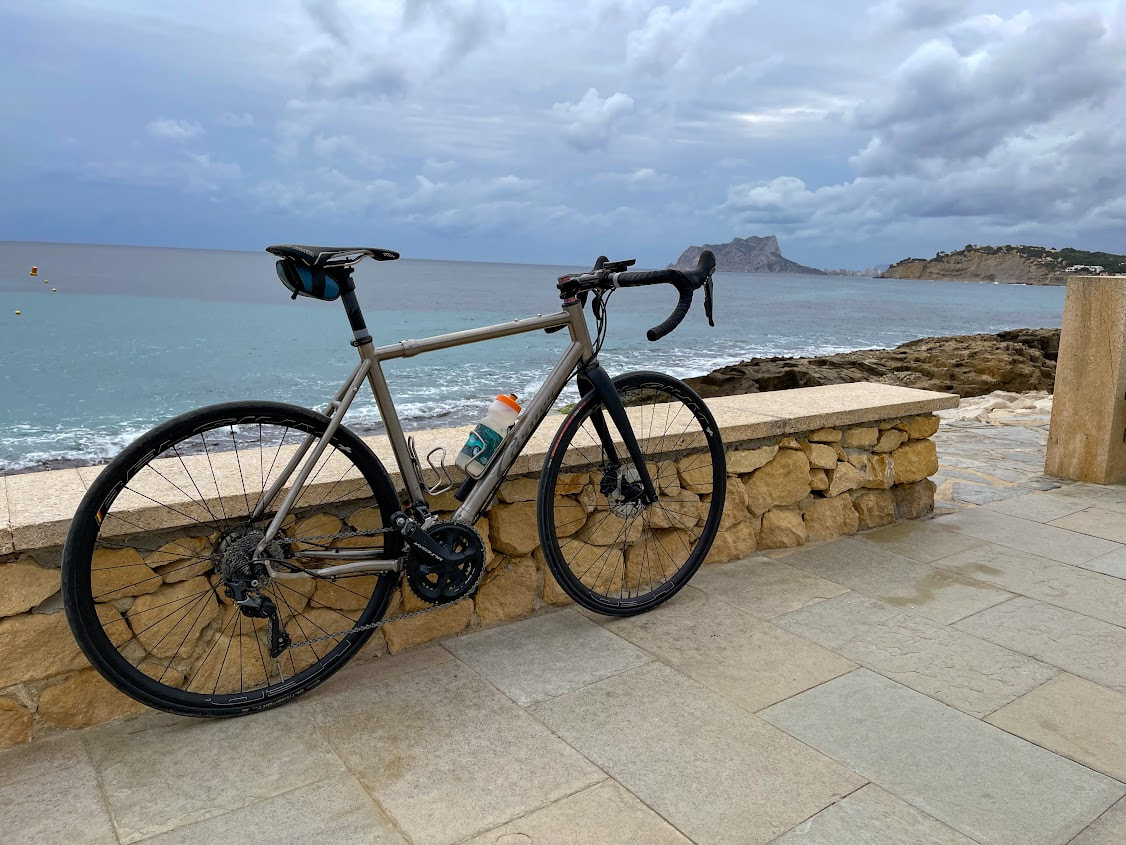

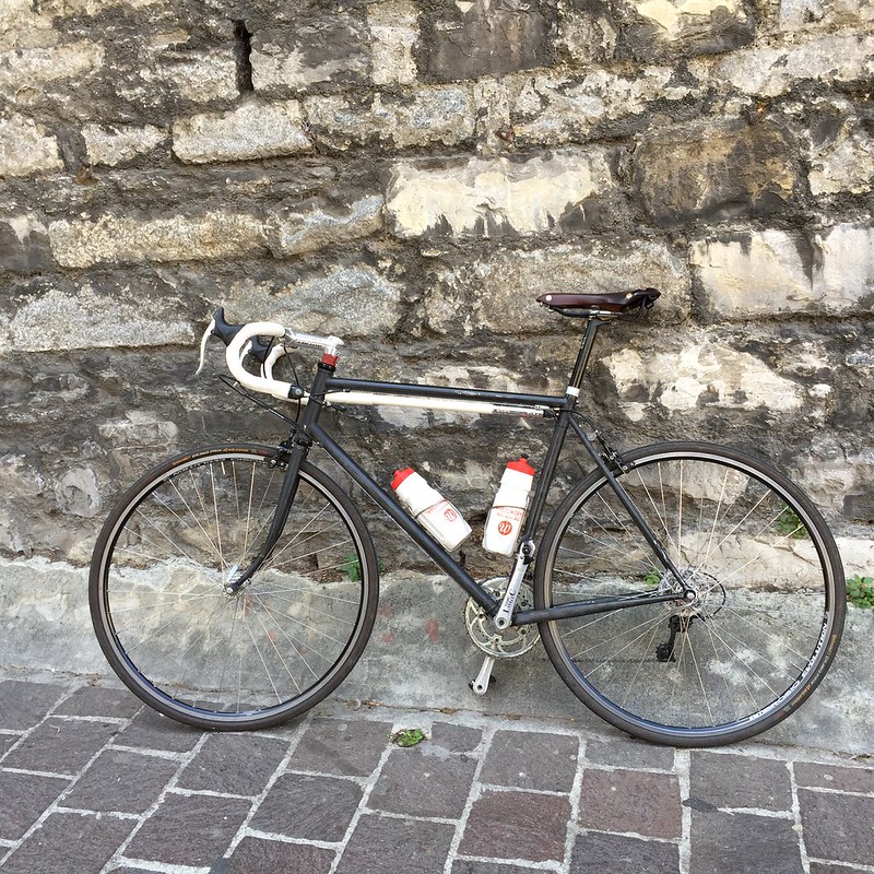

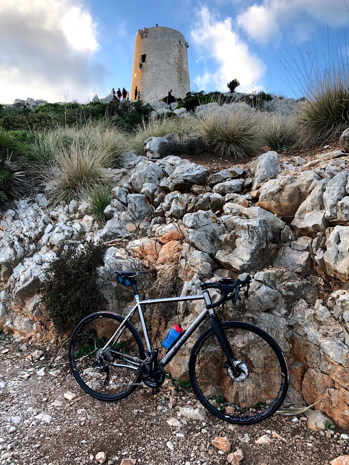

Built about 9 years ago. It has been on numerous trips through the US, Europe, and now Japan. I keep looking at getting a No22, but this one keeps rolling…

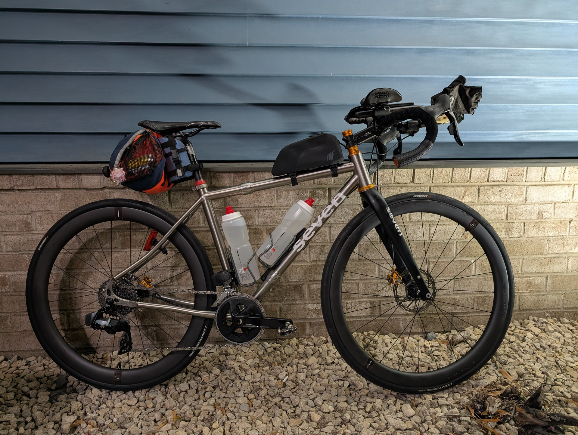

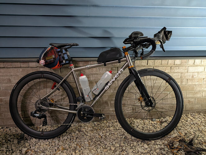

My travel bike (and only bike), a Seven Cycles Evergreen.
That’s a lovely Seven, Robert.

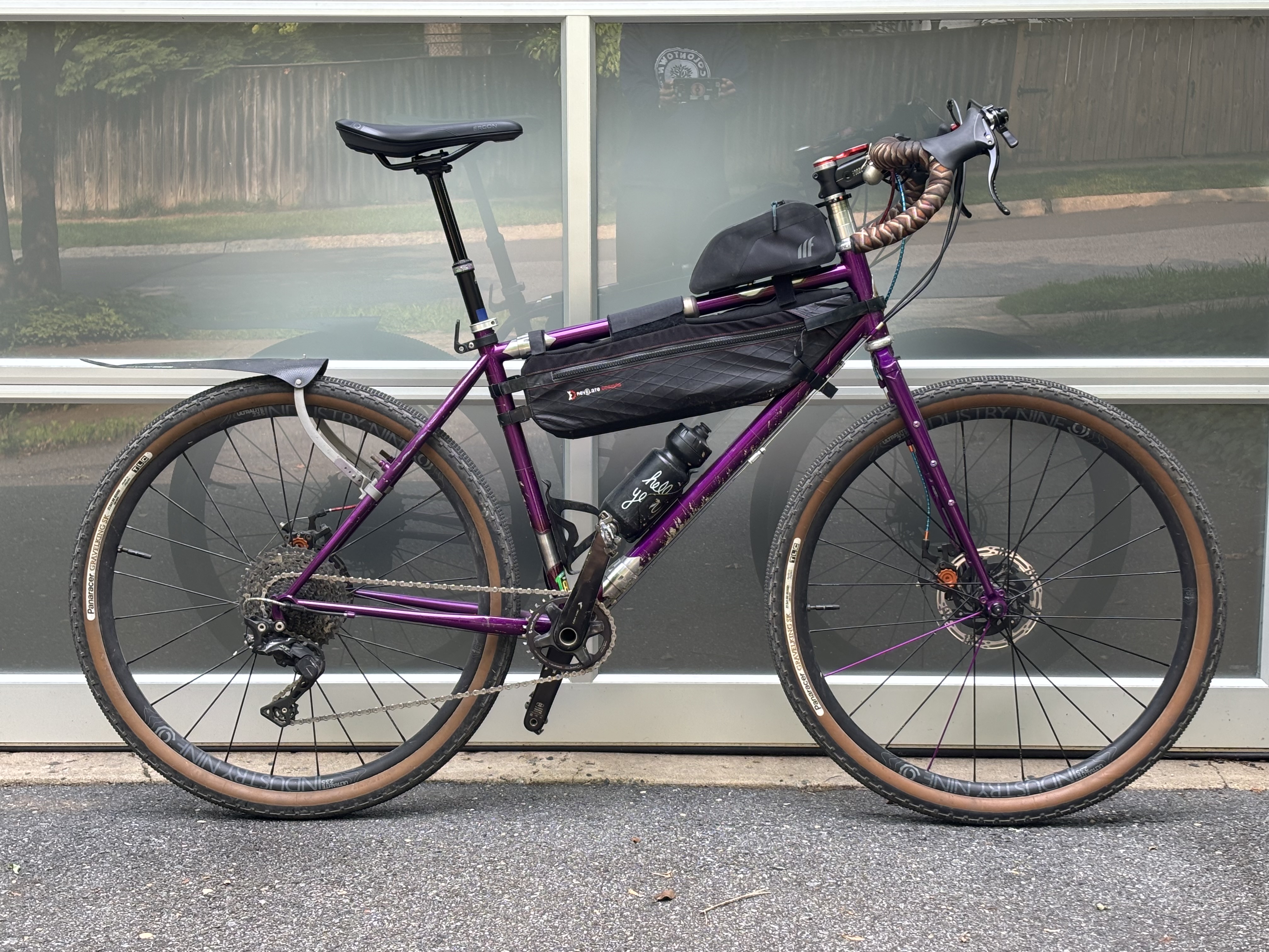

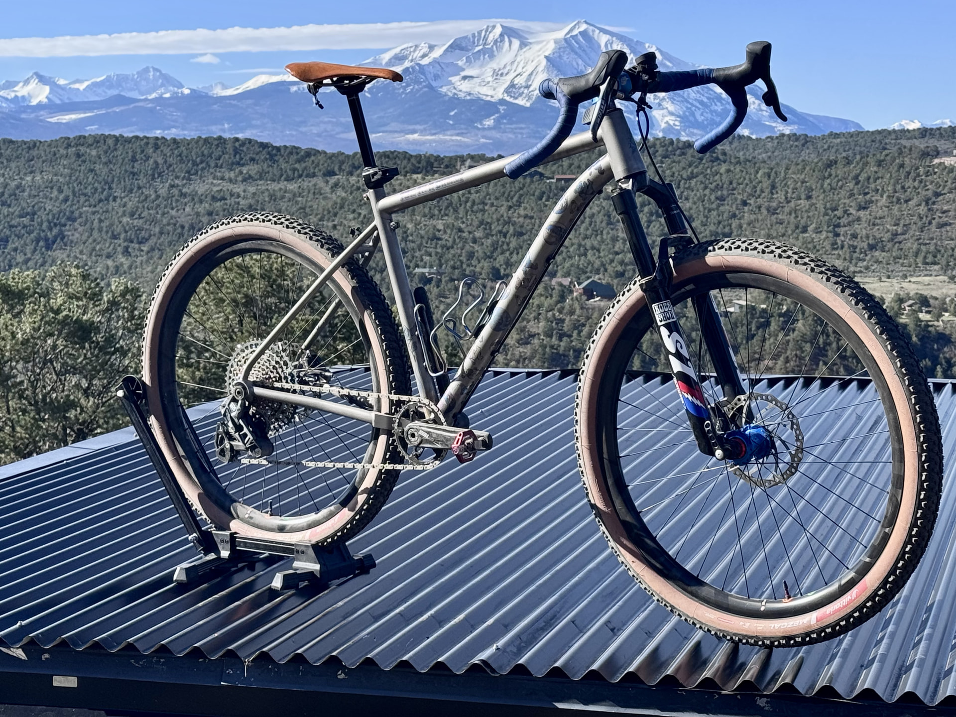

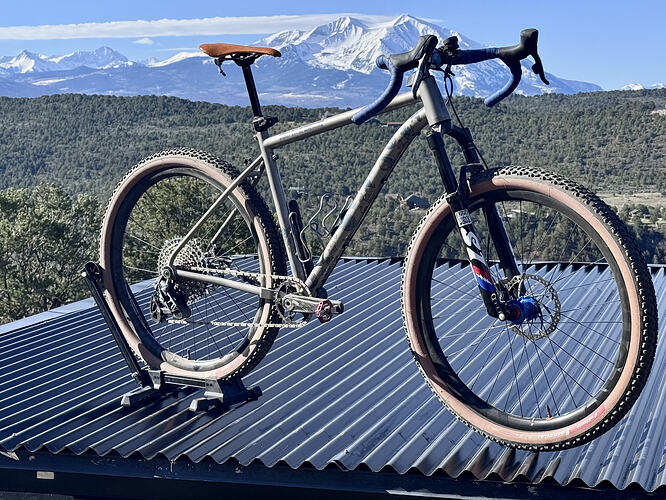

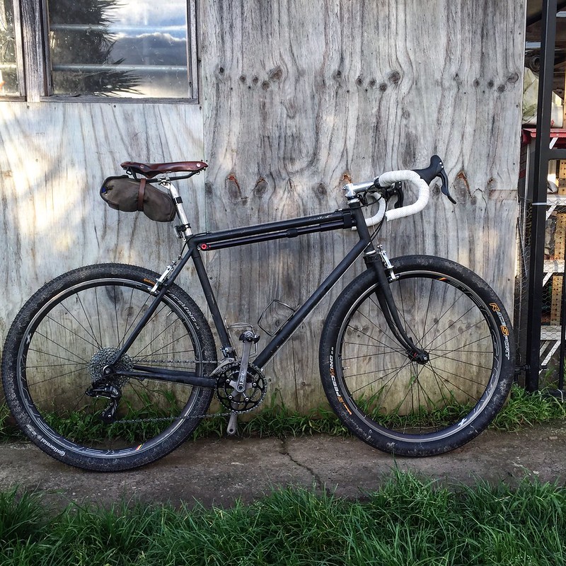

I have several, with retrofit S&S couplers. This is the gravel/bikepacking one. Originally an early 2000s IRC hardtail made with Reynolds 853. Couplers and fork by Steve Bilenky in Philadelphia. Internal dropper and top tube bag fittings by Gibson Cycles in DC area, with clearcoat over the bare steel in the spirit of kintsugi. The frame came with disc brake and canti mounts, which made 650b easy.
I use an aluminum hard case S&S used to offer. Same dimensions (26” x 26” x 10”, which meets standard airline check-in requirements) as their fiberglass cases. Bike + case < 50 lbs. I do remove the disc rotors.

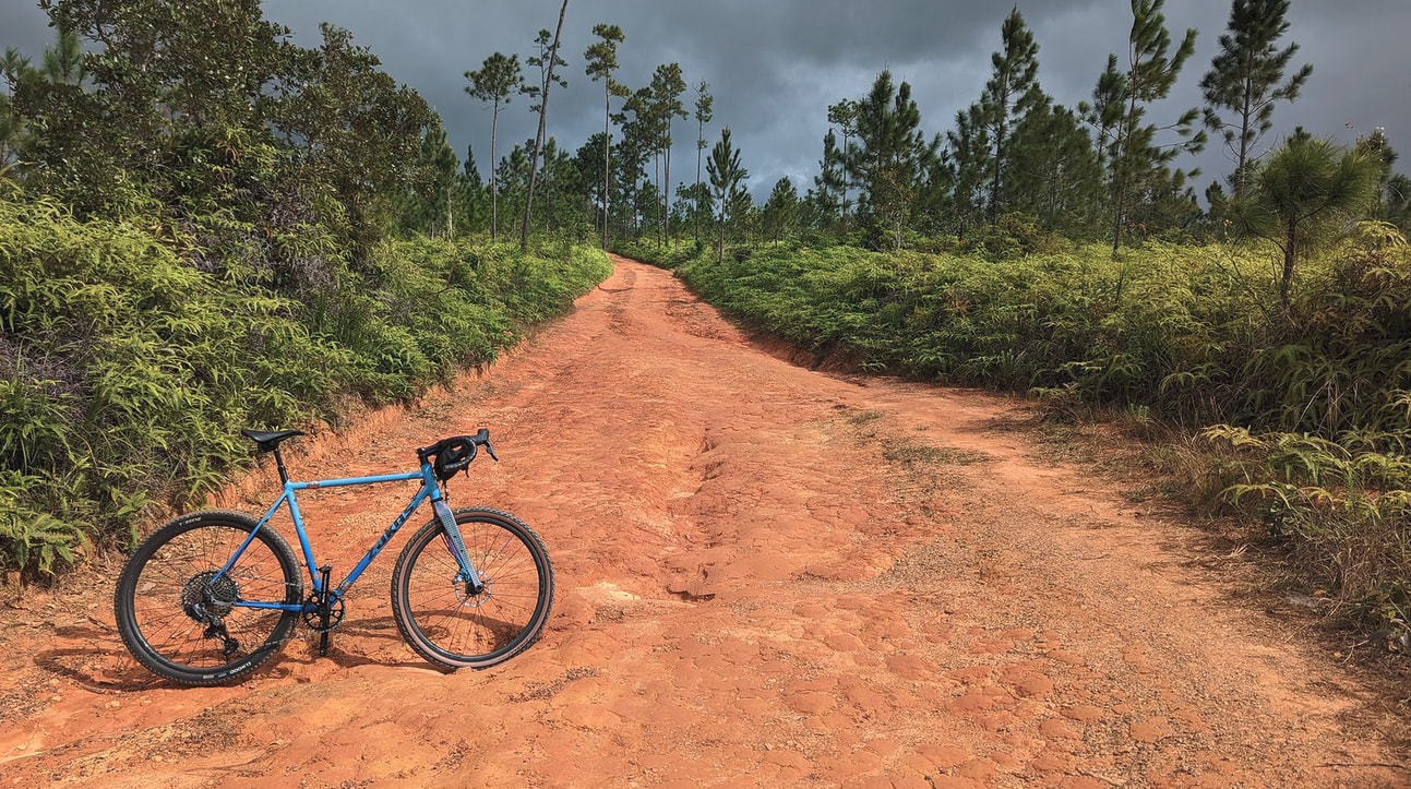

Somewhere in Belize. This bike has had the shit kicked out of it by the airlines and keeps on going. It was built for 27.5 wheels to make packing it in an S&S case easier with larger tires. I wish the frame could handle bigger tires but maxes out around 47 on MTB rims.
As for carbon wheels, I have never had and issue even when the frame has been dented and had the front derailleur knocked off.

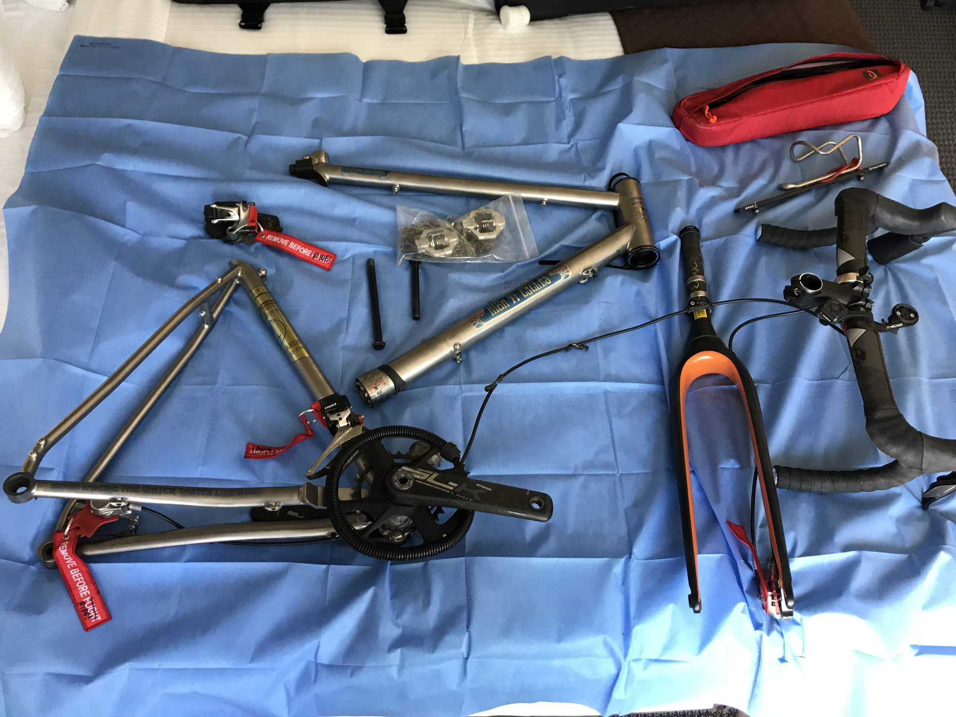

Wireless shifting and hydro-couplers really changed the packing game. On this trip I had the gen 1 Zeno couplers with that tiny clip. Mine didn’t come with the little rubber band keeper on the clip. Of course I lost one while assembling the bike in the grass. One brake only for this trip.

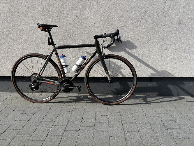

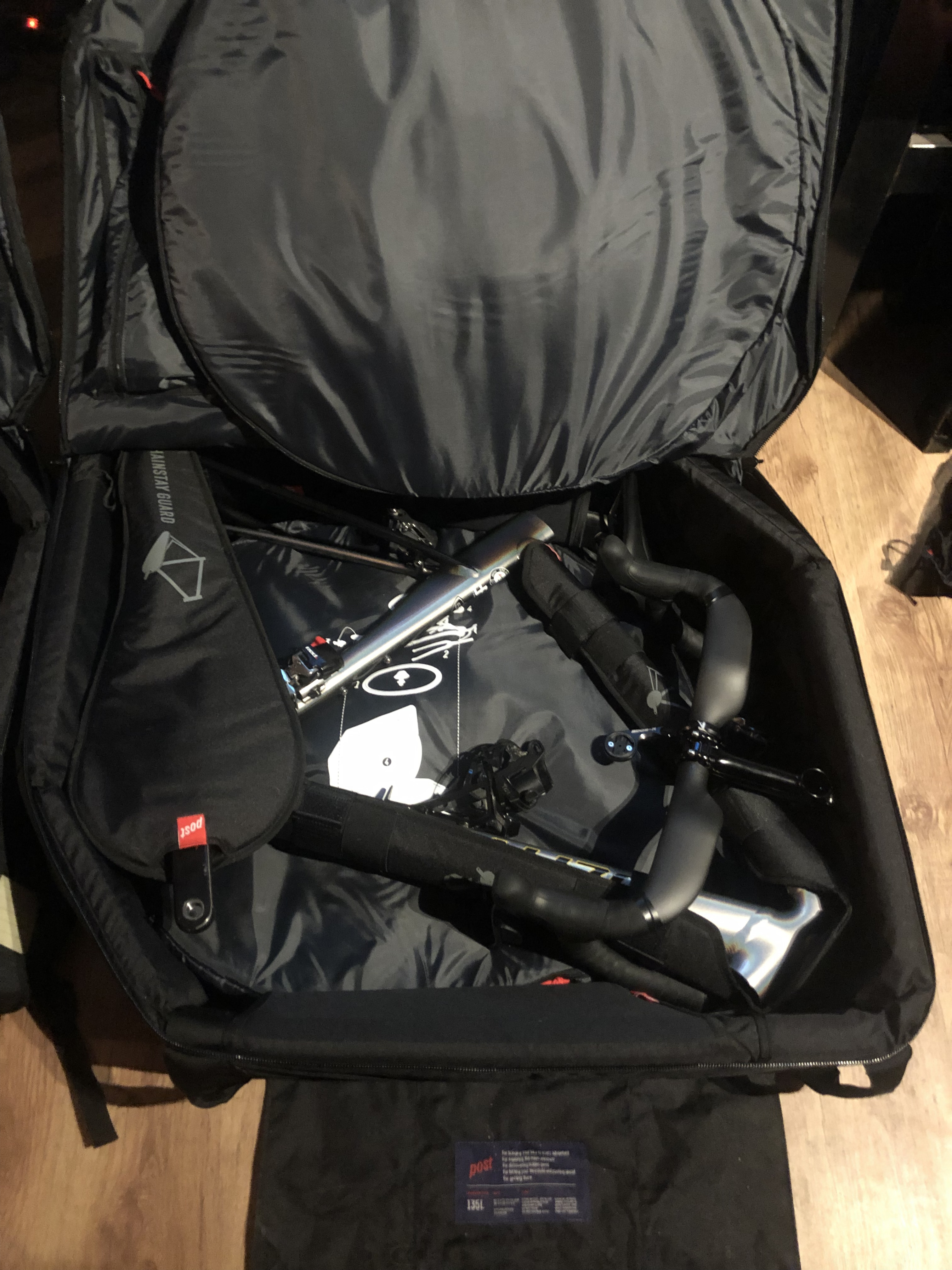

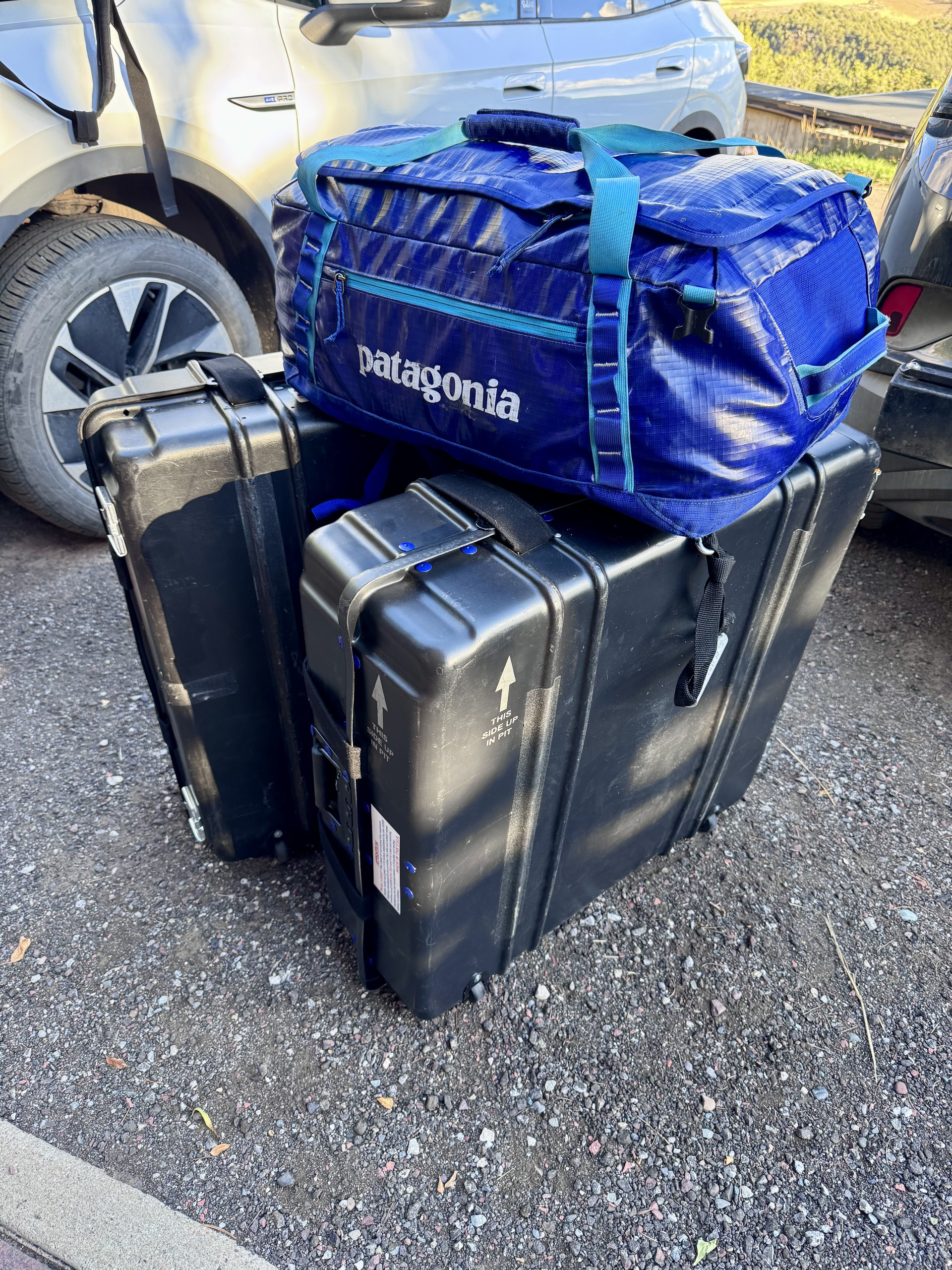

My travel setup is a Standert Kriessage (rim brake) paired with a Post Carry Co Transfer Case 135L. If you run SRAM AXS, it makes for an easy travel setup if you are mechanically inclined. You can also pack most of what you need for a trip in the bag and still meet the 30kg weight limit, I typically land around 25 kg.
Between this setup and my previous bike, Allez Sprint (rim brake), I’ve done 15-20 trips and everything has held up really well. It also ensures the bike sees frequent maintenance. I’ve also traveled a few time with my gravel bike, a Niner RLT steel (Disc), It has the Zeno couplers v1 and the work a treat for keeping things easy to break down and rebuild.
My Wife and I each have a transfer case and it takes about an hour on each side to breakdown and rebuild both bikes when we travel.
I’m in the process of building a custom disc brake road bike that will leverage the Zeno couples to travel the same way.

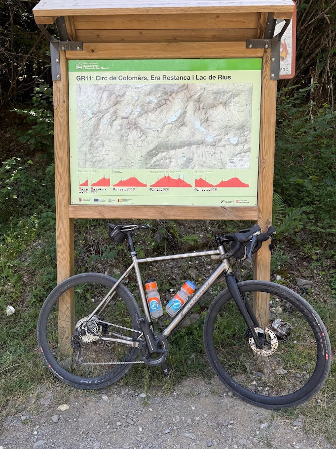

A long time ago @caley_fretz had an article on his first Mosaic and then every trip I made I would think about it. Mosaic is too $ for me though so it became this Carver ti (bikeman.com) build. Custom geo and couplers were cheap adds when I had it built in 2019. It has 2019 era gravel geo and fork, I have used it for everything from road racing with 25mm tires to gravel with 38mm knobs. With couplers and straight gauge tubing it’s not light. All cabling is external, on the down tube. Components were almost entirely sourced from my garage (practically a free build!). I think it’ll go to XPLR 1x soon for further simplification. I use an Orucase Sub 62 (now discontinued).
