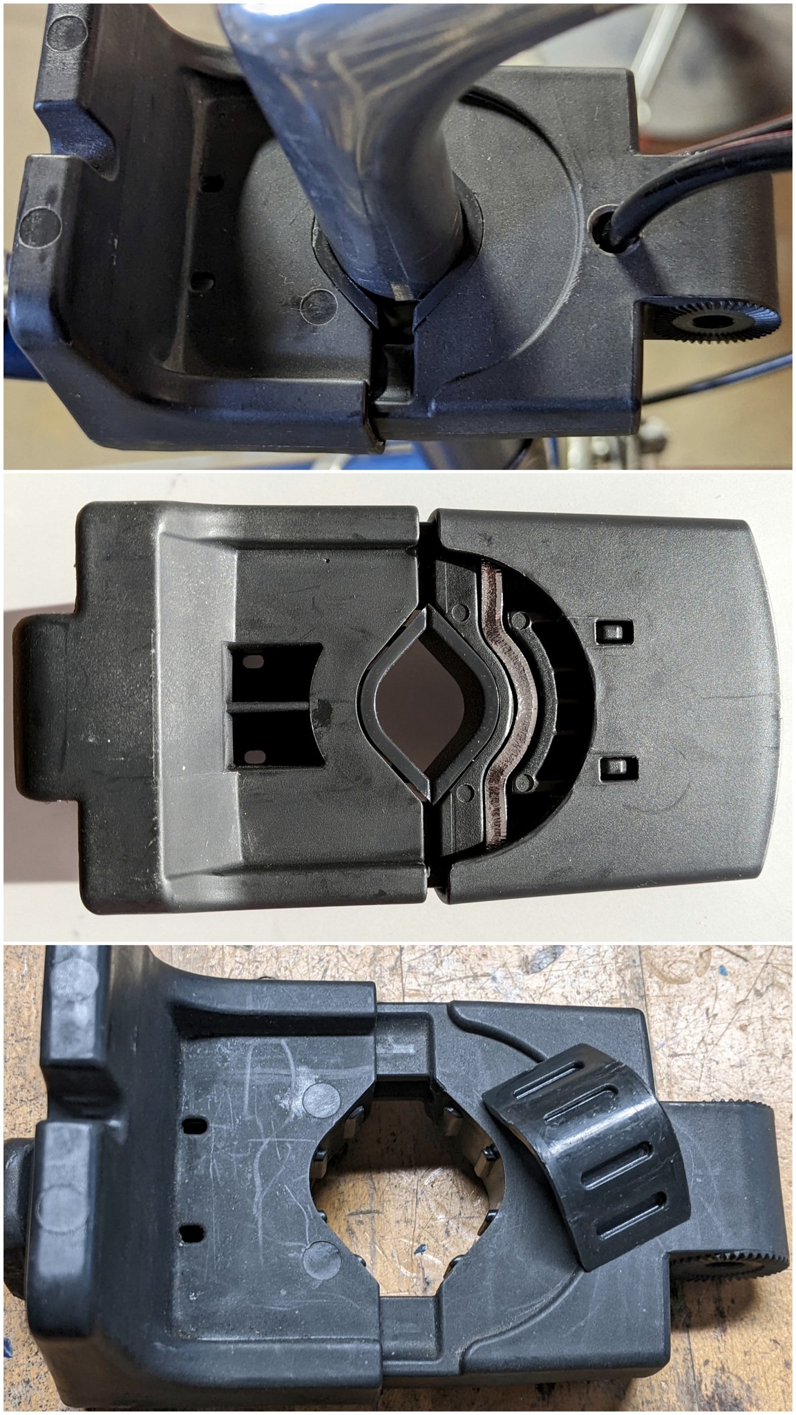

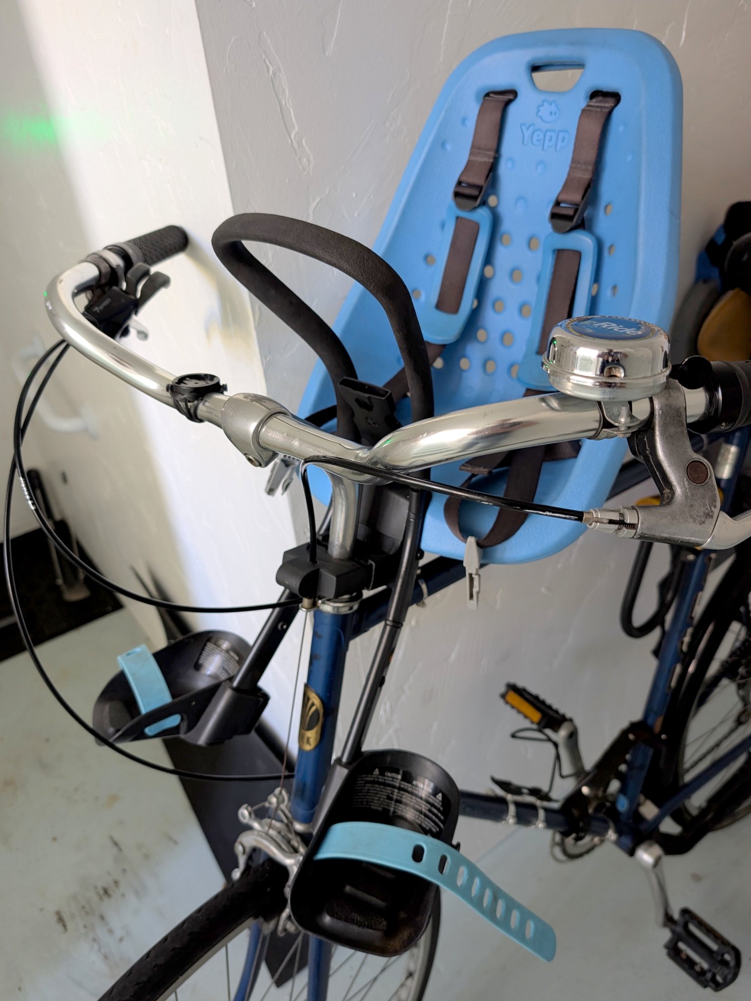

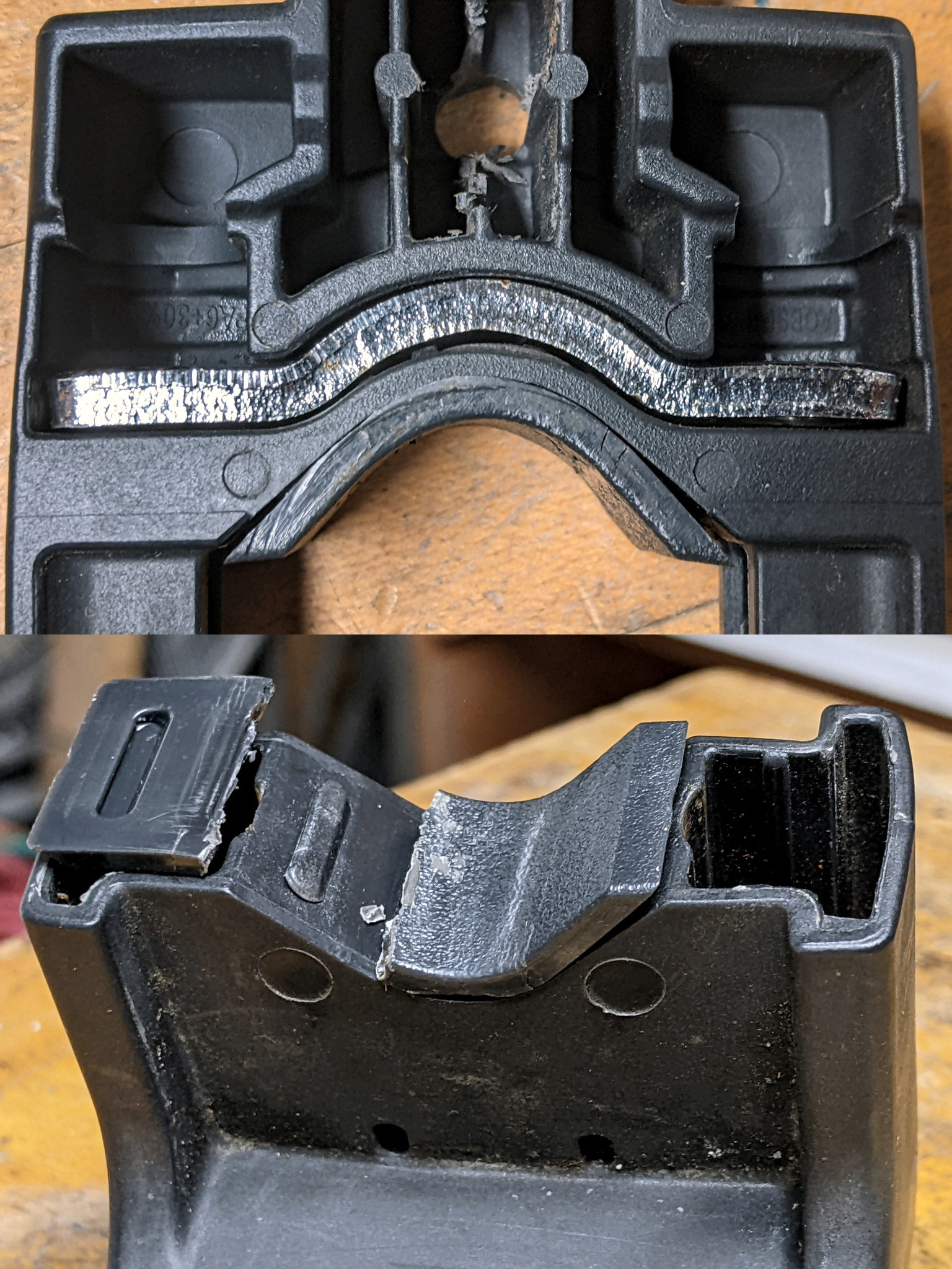

I used the Thule Yepp Mini (the colorful one, not the polystyrene Nexxt version) for two years with our first kid, and now I’m reinstalling the mounting-bracket so I can use the seat with our second kid.

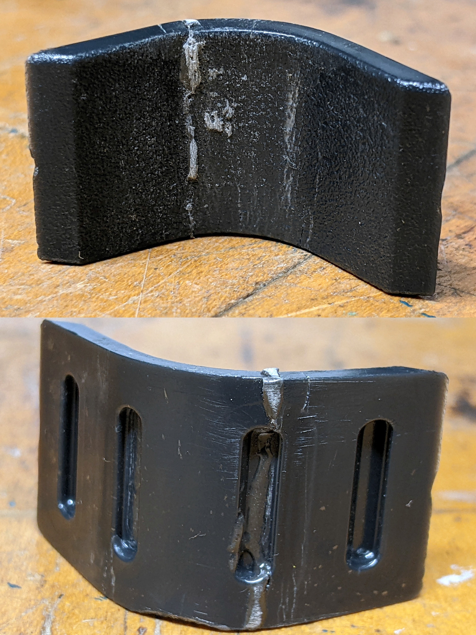

However, I’m missing one of the plastic shims that clamps around the quill stem. I remember it was cracked when I removed the bracket, although I thought it would still work and thought I’d kept it. But, can’t find it.
Thule doesn’t appear to sell spare-parts like this, although it’s possible that they do to bike shops. Is there any way to get one of these? It appears they’re designed to be replaced, so maybe dealers can get them?
OR is there some material that would work as a replacement? There are specific fitment lines (see bottom pic in the collage) that align the shim to the bracket body, and I’m skeptical that some rubbery silicone would be stiff enough against the compression involved here.

So I’m back to searching through my bike-work/parts area (I thought I’d kept the original cracked shim with intent to epoxy it), or figure out some replacement shim material.

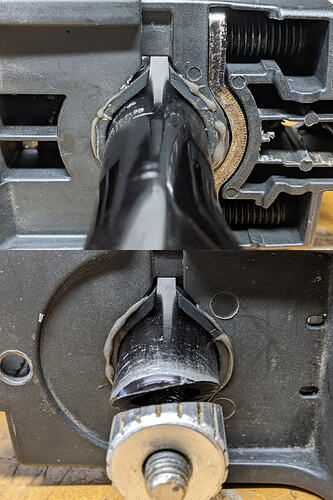

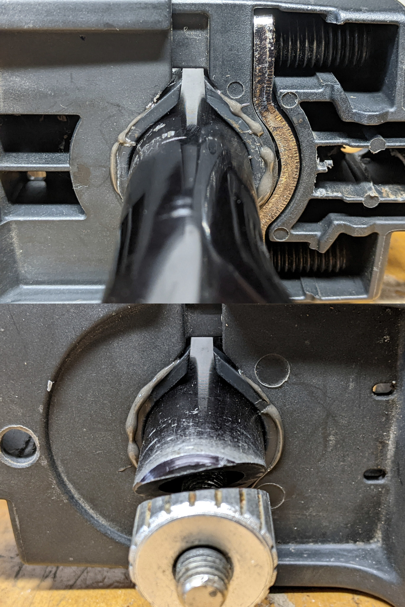

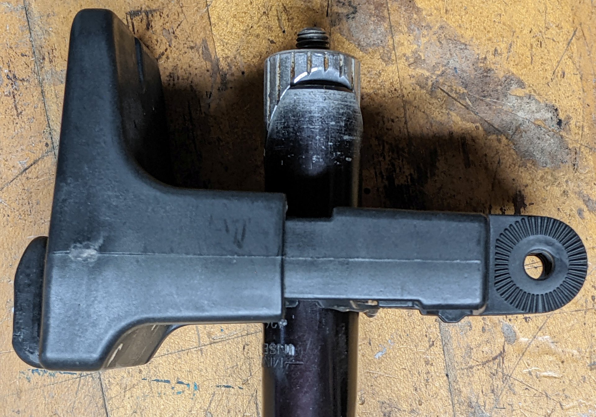

I did find the cracked shim, glued it back together with epoxy, couldn’t get it to mate with the ridges in the adapter, and so will epoxy the shims into the adapter (and bolt to a quill stem while allowing to cure). Hopefully this will allow the adapter to be re-used by someone else after my 2nd kid has outgrown the seat.
