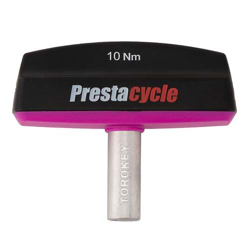

I use the presta cycles ones. I have no problem hitting 10nm one handed. Also, unlike others, these can be used to loosen too. Good product!

Another vote for Prestacycle. Good for 5,000 uses IIRC, my set have been in daily workshop use for 5 years and are still bang on the money. Yes, you can comfortably get 10NM out of the smaller handle if you hold it like a knuckleduster (ie in your fist) instead of forefinger / thumb.
