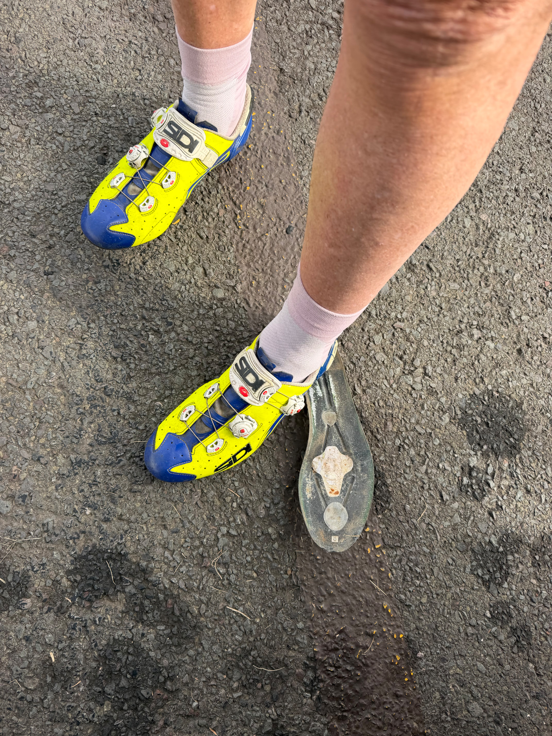

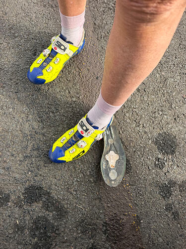

So today I am racing in the weekly Waratahs Crits, enduro event so 90 minutes. I win the race after a sprint finish , roll back to the car and the sole of my shoe slides off …
WTF , if that happened in the sprint I would be on be eating road
Is this thing ? Shoes are probably about 6 years old but only used on occasional Sundays and of all my cycling stuff get looked after the best ( in a bag with wooded shoe inserts and kept inside)
Do I even try to get these repaired, would I ever trust them again ??

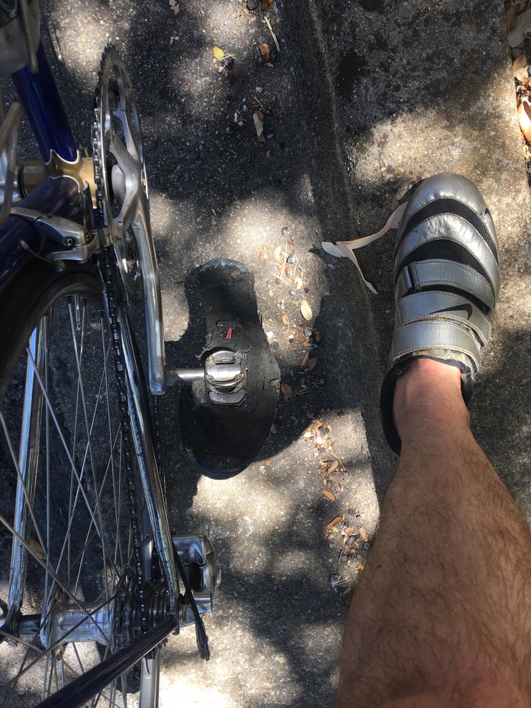

OH… that happened to me with a pair of old Giro mtb/gravel shoes, I ripped the sole right off bunny hopping a drainage channel. It finished with a very lucky save, my heart in my throat and a bodge of a fix to end the ride with bits and peices of everyone’s repair kit. When my foot released from the pedal it took a few seconds for my brain to catch up with what happened. Scary.

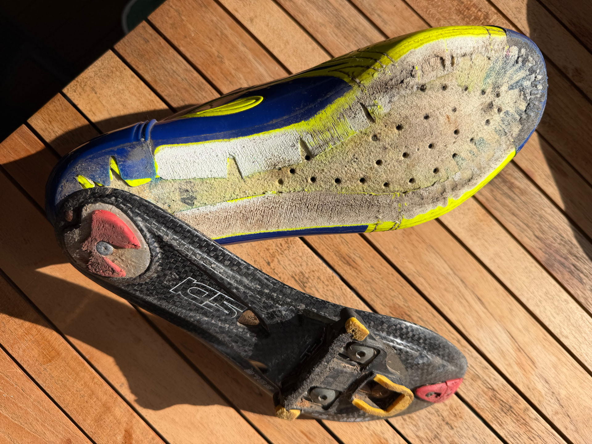

Update : As suggested I wrote to Sidi .. “ materials have a lifespan depending on care, storage etc …… it’s not indefinite…” also nicely offered 20% discount on a new pair
So , got me thinking , with no way of telling externally that the glue was about to fail should soles have secondary attachment method to avoid catastrophic failure ? .
Looking at some other shoes I have with carbon soles (glued) they have a toe cap that wraps around the bottom of the sole on the front …. would this keep the sole in place when the glue fails?…
Other shoes probably wear out before the glue fails so not an issue, but for some shoes (race day only) the shoe “looked” in great condition but the glue had exceeded its life. There was a single nail at the back of the sole plate but no secondary attachment method at the front ……
