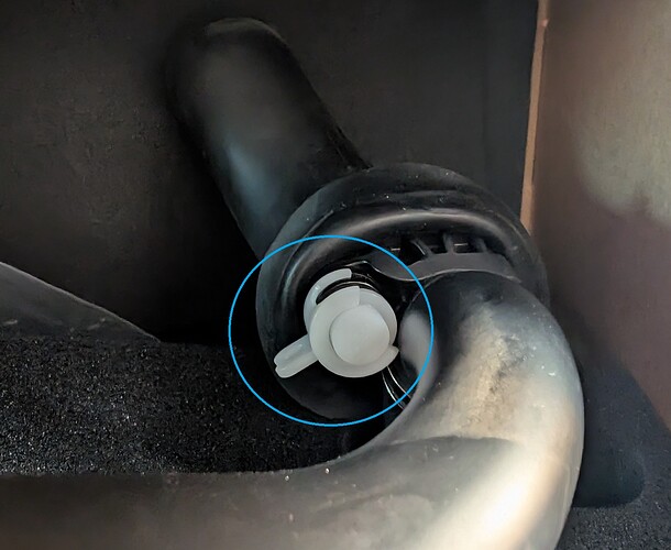

Hi @Colin_Caskie, current hydraulic brake hose setups typically require the following 3 bits at the hose/component interface (see attached image);
  1. Brass olive (see below),
  2. Steel insert (barb), and
  3. An 8mm flange flare nut (at the brake lever) and an 8mm flare nut (at the caliper)
The R8170 groupset you have would already have the hoses installed at the caliper end, as you’ve seen. You’ll need to route this to the brake lever, which may require you to shorten the hoses depending on the size of your frame/fork. If so, you’d require additional barb inserts for the hose after you’ve shortened the hose. You’ll then need to slide the flange flare nut (kept in place by the white clip thing in this image) over the hose, followed by the brass olive, which is actually housed in the brake lever. To get at the olive, you’ll need to remove the white clip, pull out the white plug and it should be in there.
To tighten the flange flare nut, I’ve found the Park Tool MWF-3 that @Alan_L mentioned to be the best suited for the task, given that the spanner contacts the nut on 5 sides, as opposed to the 2 of "normal” spanners.
