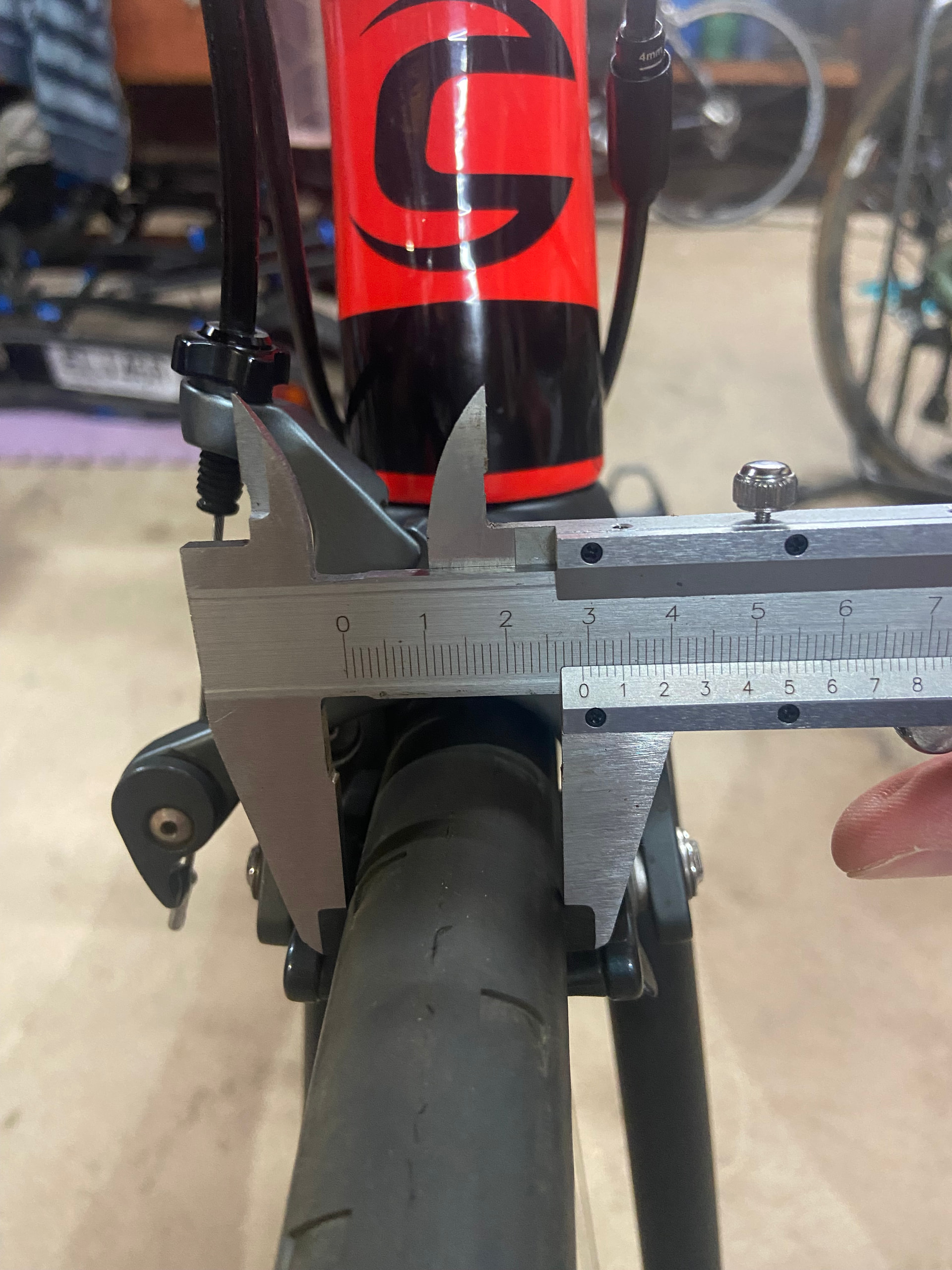

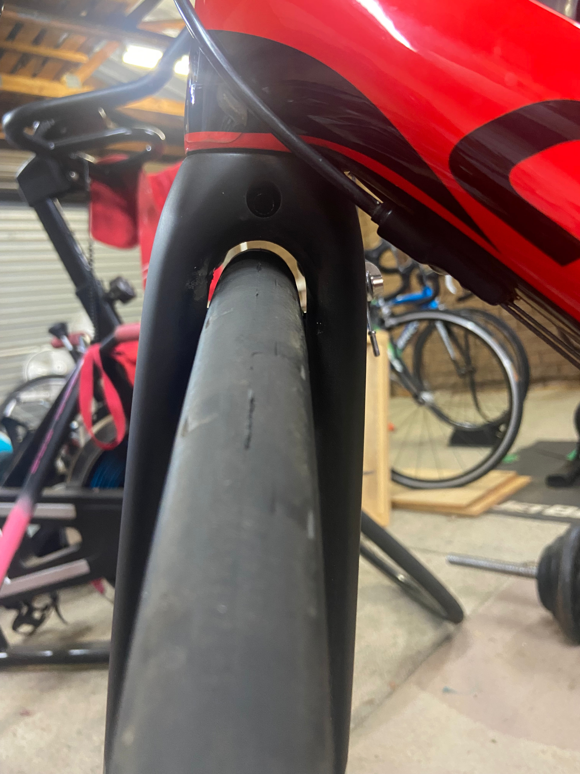

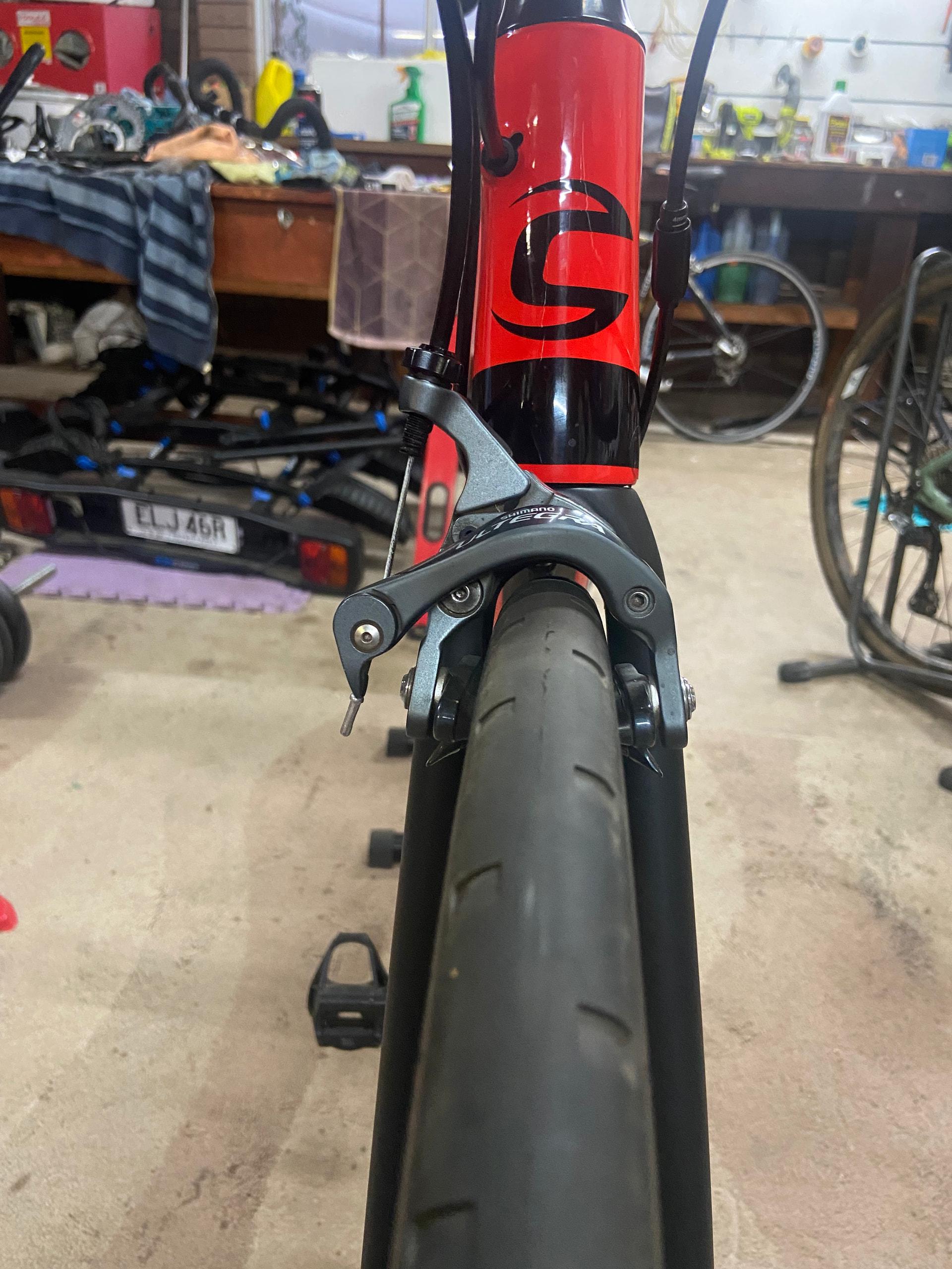

Yo, I have a 29mm measured Conti Aero111 in my Enve 2.0 (replacement on a SuperSix from around the same time). Fits fine. Could run a 30 I think (so a 28mm GP5k on the same rims) but I wouldn’t go any bigger.
Measured width is the most important thing. If you already have the tyre-rim combo then just measure and you’ll know. It’s trying new tyres that’s hardest for those of us still riding rim brakes.
Many thanks for the reply, the photos are really helpful - it looks like a safe 3mm all round. I have the same Ultegra calipers and on my CAAD12 fork, this is what limits tyre size - the “28mm” tyres measure 27-27.5mm with a minimum 3mm brake clearance, and 6mm to the fork itself.
