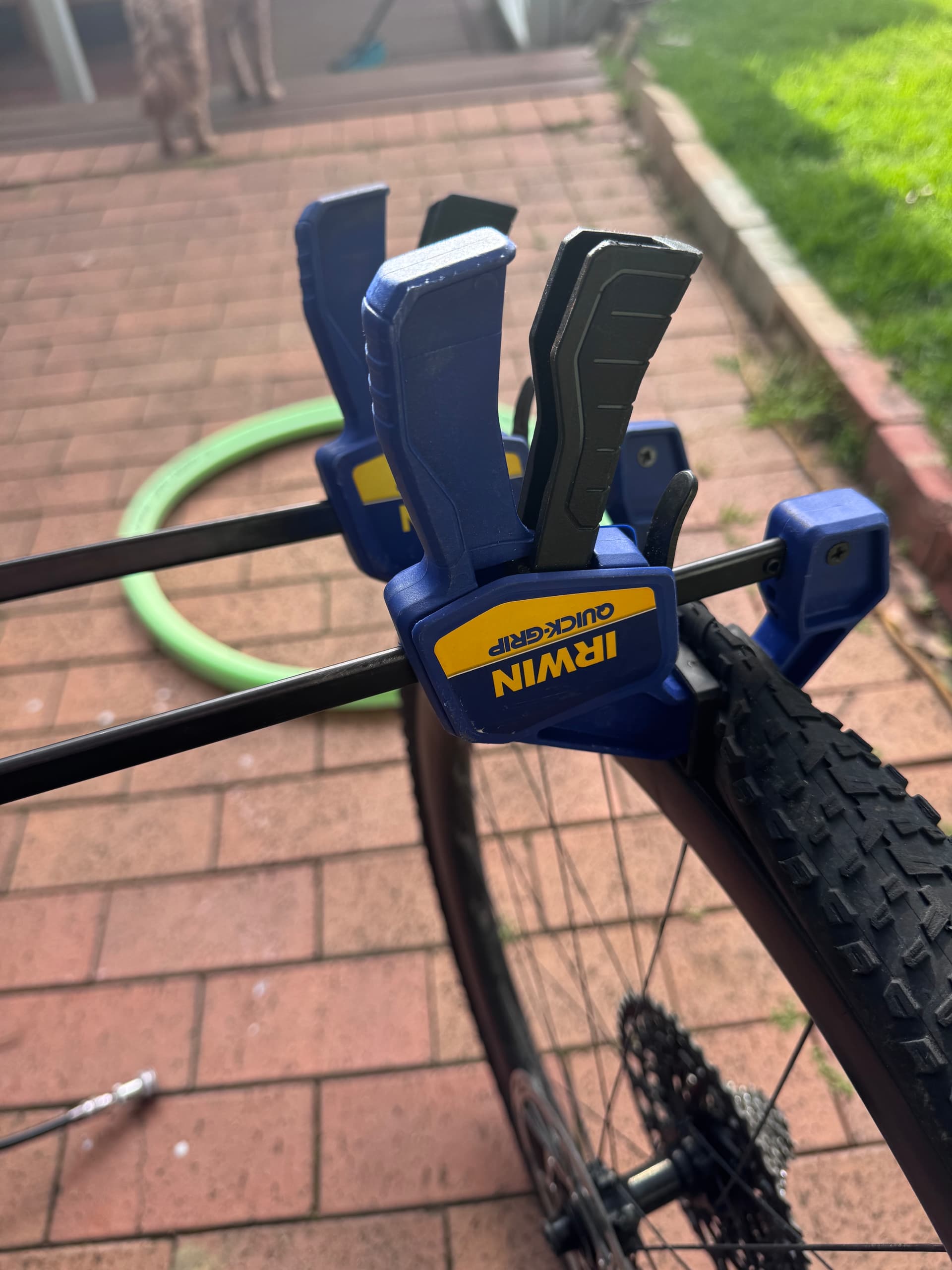

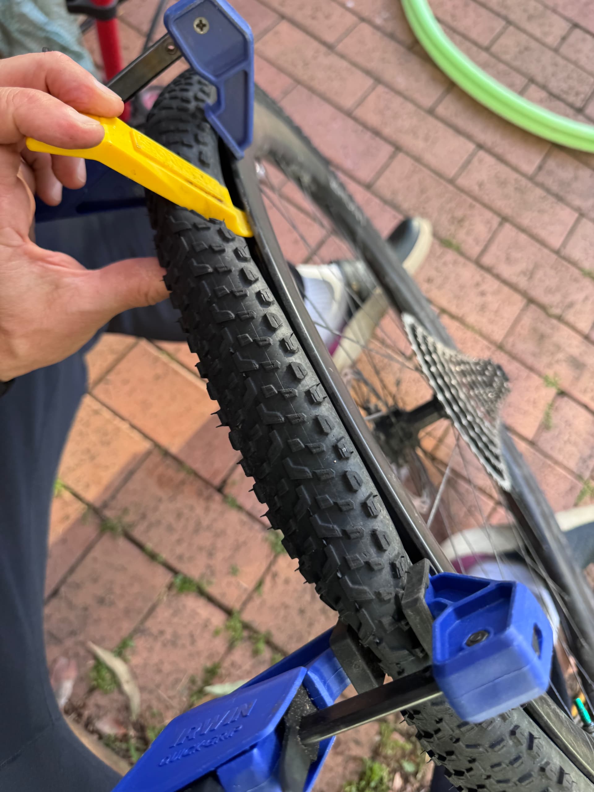

@wade_wallace - Pro tip I learned from @Dave_Rome …. in a pinch you can clamp the tyre in a bike workstand clamp and then rotate the wheel to separate the bead. I had the same issue unseating a tyre with an insert and this approach did the trick.
My mate just tried something like this and he said that the lack of rubber grip on the ends made the tire keep slipping out. As you say, the printed feet would make it work.

My biggest mistake at the start of this process was trying to hook the tire with the lever and remove it the same way I’d removed hundreds of tires in the past (i.e. hook it and lift it over the rim). But what I eventually realised is that breaking the bead by pushing it into the middle of the rim is the right technique. It still made a grown man cry a few times though!
