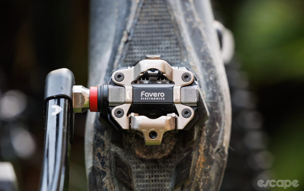

Direct contradiction to your second paragraph, but depending on frequency of road pedal usage, I’d just get a pair favero assioma pro mx-2, and then a set of the road bodies.
more expensive, yes? But they easily work on ALL your bikes.
When I started using Trainerroad I wanted to start recording power usage off the trainer as well so trainerroad could use all that data. Pricing spindle, spider, or crankarm meters for the bikes very quickly overshadowed the cost of faveros.

Agree with this, I have it Rallys with SPD and SPD-SL bodies (bought them before Favero had the option).
Otherwise, I’d email the folks at Power Meter City and they’ll get you hooked up with your options.
Oh I didn’t realise you could swap the bodies on the Faveros. That’s a very compelling option then!
Edit - okay I looked into it. Seems great! Only concern from my side is that the road pedal bodies are shimano-based and I have Look pedals on my road bike. But that’s not an insurmountable issue.
Has it changed? My Favero assioma duo’s (road) are look/expedo pedal bodies.
The SPD Faveros are the MX-2s and the Road Pedal Bodies that fit on those are Pro RS pedal bodies which are shimano based.
As far as I know the Assioma Duo’s don’t have interchangeable pedal bodies. Also I would want the MX-2s spindles without the little power meter pod tbh.

FWIW, right now the Favero PRO RS-2 power meter pedals are $809 US and the PRO MX pedal bodies are $139.98 (for a left/right pair). The total for all of that is still less than the Garmin Rally RS-2 power meter pedals. That’s no slight against Garmin but rather a statement about what a gobsmacking deal the Favero pedals are. When I bought my Assioma Duos at the end of 2023, they were $759 dollars at Power Meter City.

I bought the Faveros (dual sided) in the end. I was able to get a reasonable deal but not quite as good as the annual sale. They’ve been great and no regrets. They are a bit more expensive than some other options for sure but it’s hard to beat the simplicity and portability.
About 2 weeks after I bought them they released that firmware update that dramatically extended the battery life which felt like another win.
So they’re more expensive that some other options but worth it in my opinion. You could save a little money (compared to me) by getting single-sided also.

No, just the SPDs for now. I’m not sold on riding gravel on 3-bolt cleats just yet.
But it’s nice to know that if I want to do some extended road riding on my crux I can just swap the pedal bodies. I’d most likely consider that for traveling purposes if I didn’t want to pack my Tarmac. For example, I took my Crux to the Paris-Roubaix sportif a couple of years ago.
Any hunch on when the review of these pedals might be forthcoming? Ronan wrote an In for Review article about 14 months ago, but I haven’t seen anything since.
I have the MX pedals, not the road bodies. The full review of those is here:
