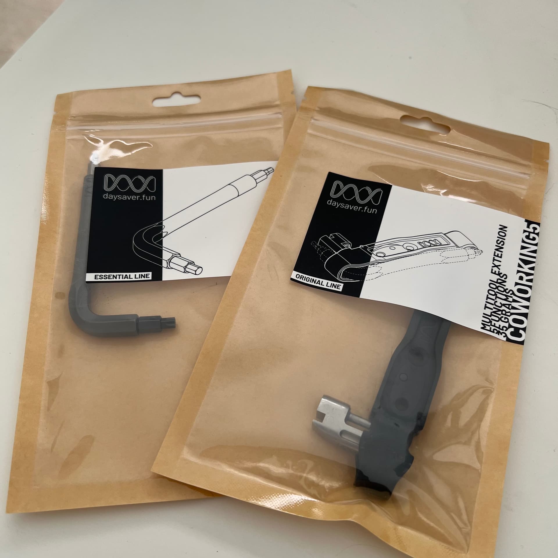

Finally… Took a looong time to arrive
Ooh nice… I hope you never need to use them…
+1 for the Daysaver tools, and +1 for the protection case. Not only does it give a place to hold small parts when doing a roadside repair, the cavity allows you to carry a few small spares as well, like an extra cleat bolt. Also, the case makes it easier to slide in and out of my seatpack with minimal unstrapping/unzipping.
