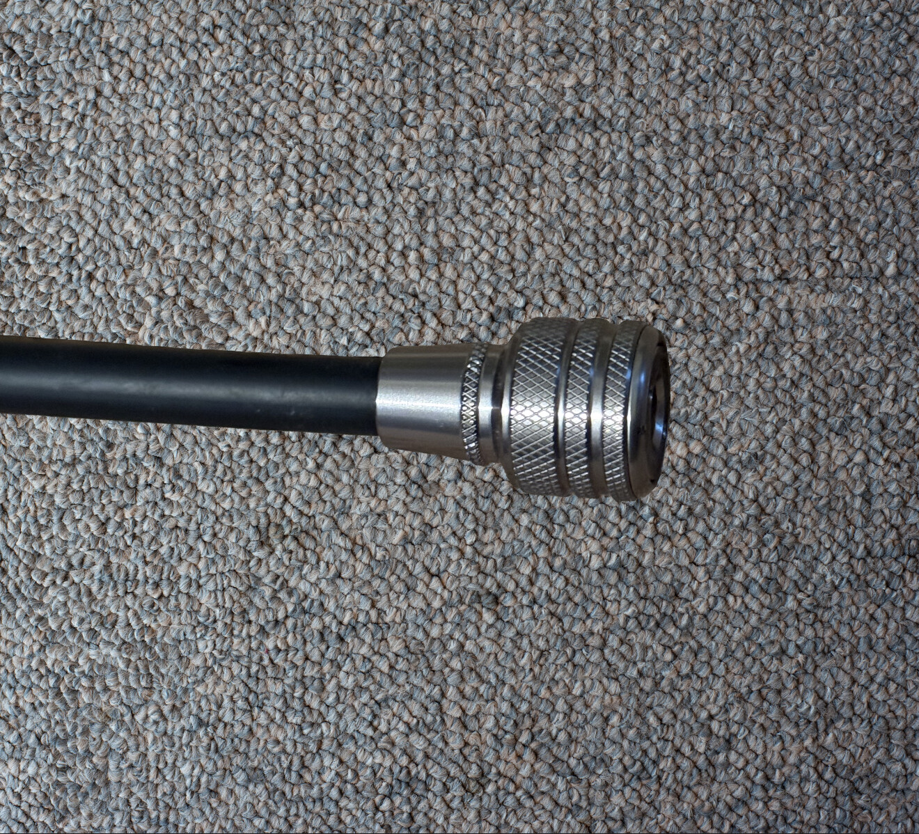

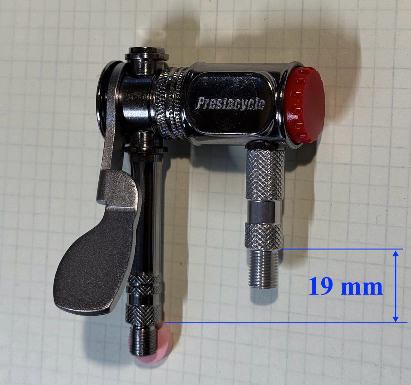

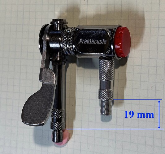

I have a Silca Super Pista Digital pump. I just bought a Prestacycle Pro Presta Head to replace the Hiyo head on the Silca pump. I like the Hiyo head, but it’s a bit hefty. I don’t like that way it hangs off of my Fillmore valves. The Pro Presta Head is lighter and it goes on and comes off a bit easier since it doesn’t have the large locking lever that the Hiyo does. I have a couple of questions:
  1. Does anyone have any idea what the thread spec is on the stem of the Prestacycle head or the Silca head? They seem to have the same diameter, and the thread pitch is identical.
  2. Does anyone make a small extension to screw on to that stem on the head?
Someone gifted me an STL file for an attachment that would include a magnet so that the Presta head could be stowed where the Hiyo head is magnetically stowed. An extension for the stem on the Presta head would solve my problem. With the Prestacycle head attached it’s 30-40mm short of where it ideally should be to use the 3D printed solution.
FWIW, both heads plug into a push to connect fitting on the end of the Silca pump’s hose.
