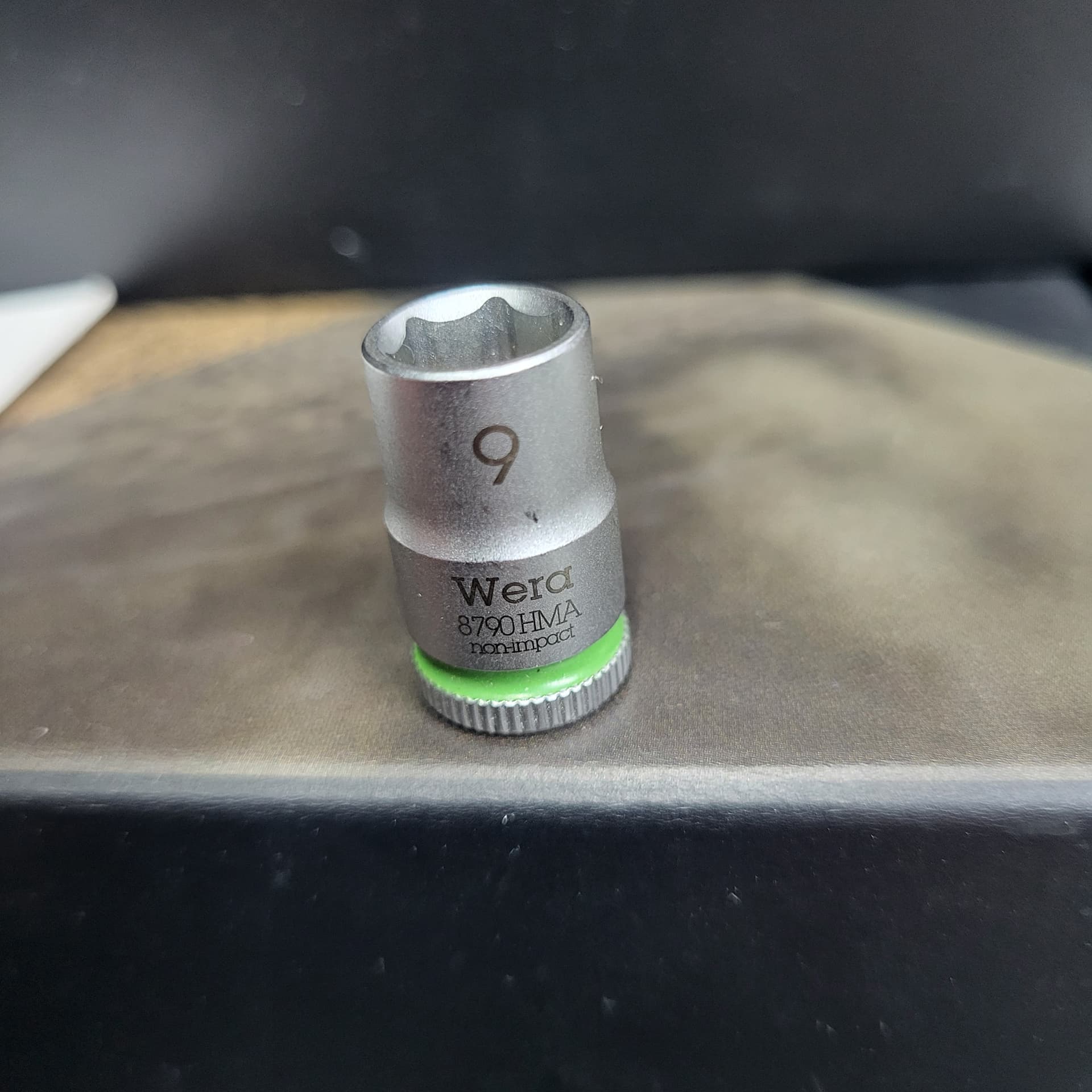

Note - some of those bearing kits say you need a special 9mm socket. If you have a Wera Tool-check Plus, or some of the Wera 1/4 sockets, the 9mm one works and fits perfectly.
Good tip on that tool. Have those at home and only the Park Ones at the shop I was last at.
The park one worked fine after a quick spin against the bench grinder :joy:
