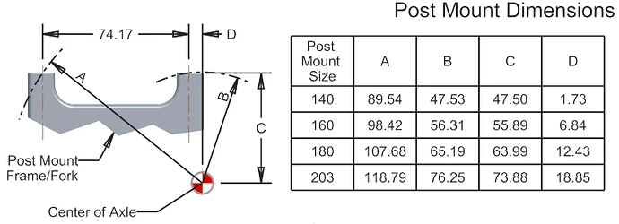

Hi,
I have a postmount fork but want to use a flatmount caliper. Fork is setup for 160mm disc as standard and I want to use a 180mm disc.
I know Wolftooth makes an adapter that very conveniently adds the 20mm I need to go from 160mm fork to 180mm disc; https://www.wolftoothcomponents.com/products/post-to-flat-mount-brake-adapter.
Who else makes quality postmount to flatmount adapters?
