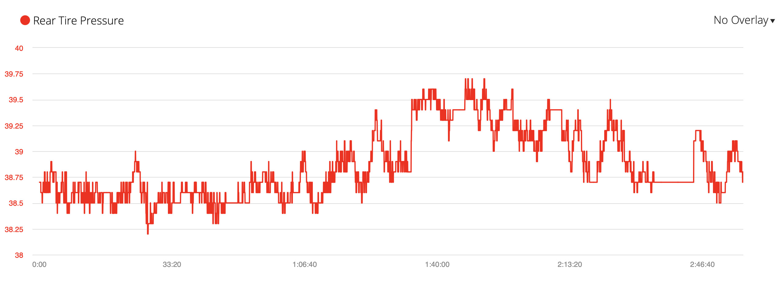

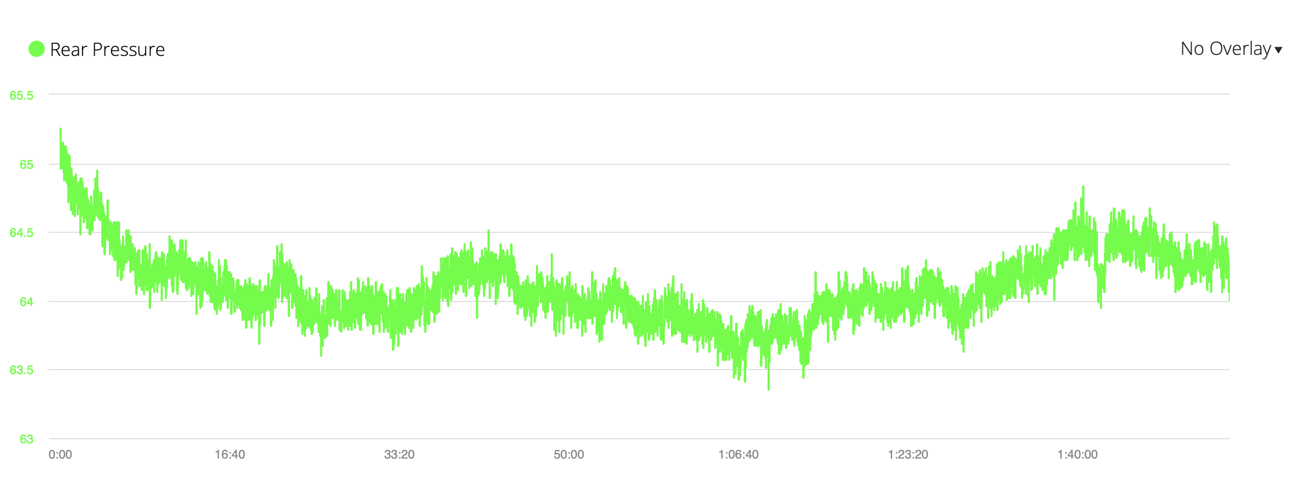

This may not be such a big deal. The Outrider sensors seem to update the bike computer less frequently than say the TyreWiz, or the Outrider ConnectIQ data field is less frequently updated. I have both so I am able to compare.
Here’s one from the Outrider sensor:
Here’s one from a TyreWiz 2.0:
