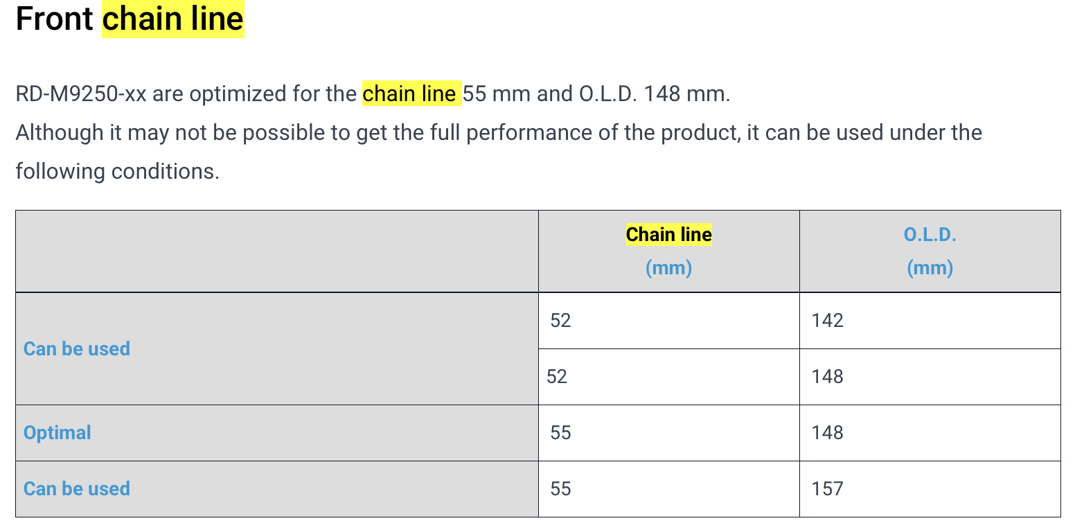

So I just found out in the derailleur manual that the XTR Di2 9250 SGS is optimized for a 55mm chainline, while the GRX crank has a 49.7mm chainline. My understanding was that the GRX 1x derailleure (827) was just a rebranded XT derailleur, so interchangeable - but could it be that there is actually a difference between them, being the chainline? Unfortunately I can’t find the information regarding the recommended chainline in the Shimano GRX 827 manual.
If there is a difference in chainline between the XTR and the GRX derailleur, I guess I need to change the derailleur - or is there a way to bring my existing crankset from 50 to 55mm chainline?

RE Derailleur chainline, don’t forget that the XTR rear derailleur will be designed to work with a 55mm chainline (measured from the centreline of the bike) when fitted to a Boost 148mm frame. If you’re mounting it to a 142mm rear end, that will move the derailleur 3mm inboard relative to the centreline, so will also permit a chainring which is 3mm further inboard…
If the issue is noise in the largest sprockets, moving the chainring further outboard will likely make the noise worse - the chain will get noisier the further away from straight it becomes (effectively like cross-chaining a 2x drivetrain). Running a wide-ratio 1x drivetrain with a large chainring, on a bike with short chainstays will ultimately lead to the chain running at extreme angles when in the largest sprockets, no matter what you do.

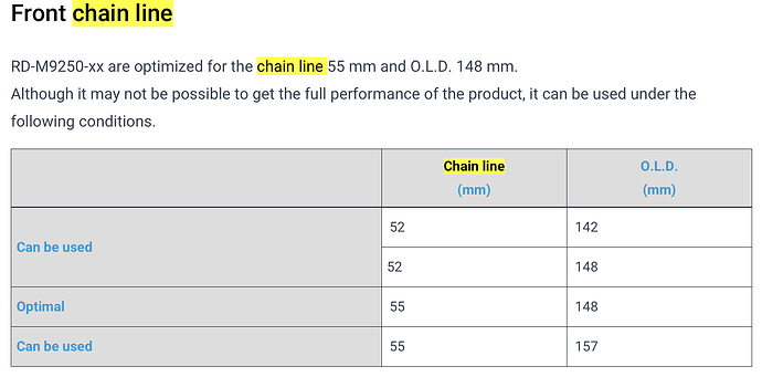

Good idea - unfortunately I haven’t found that information. What I have found, though - “RD-M9250-xx are optimized for the chain line 55mm and O.L.D. 148 mm”. It can work on other configurations as listed below, but may not be optimal:
For the GRX827, I can’t find the corresponding information - but, as the system is optimized for the chainline of the 1x system, it should be optimized for the 50mm chainline and therefore different than the 9250?

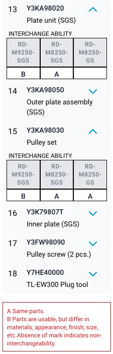

Ok, so I did find some more information on this (this is from the exploded view of the GRX 827):
Does that mean they are functionally identical? “B Parts are usable, but differ in materials, appearance, finish size etc.” leaves quite a lot of options, from being functionally identical but optically different to actually being different in size etc. But: the XT and GRX derailleur cages are identical based on this information, which should mean the two should also be identical from a geometrical point-of-view. I can’t imagine the XT derailleur is optimized for a different chainline than the XTR derailleur, though, which would then in turn mean the GRX derailleur can be used with a chainline of 52mm on 142 O.L.D., but is not optimized for it / nor the GRX chainline of 50mm? Probably I have a logical error somewhere and I’m pretty sure I’m overthinking it, but it doesn’t add up in my head :grin:
