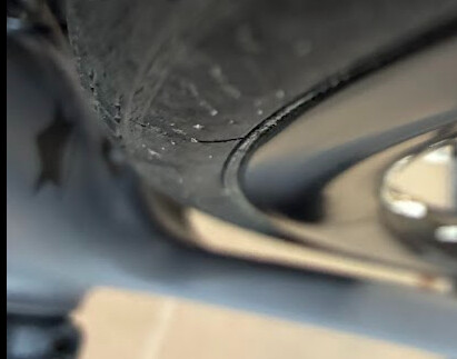

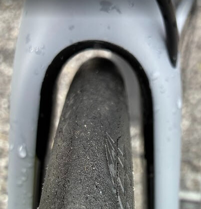

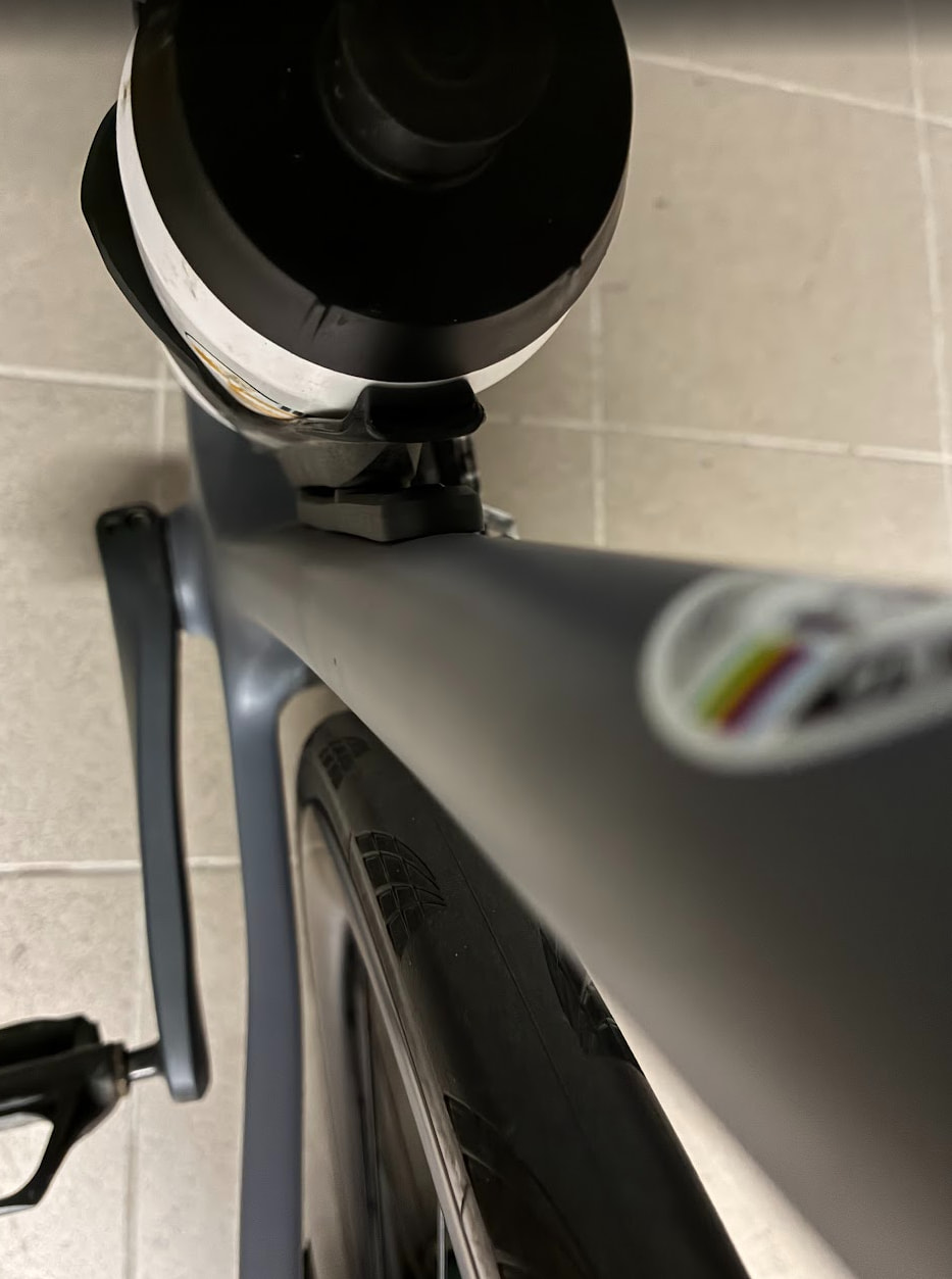

Here is a picture of tire clearance on the current frame (25 mm tires on a 19mm inner width rim).
Do you think moving up to 21mm or even 23 mm would cause a problem with this frame (tire would than have to be a 28mm, off course).

Couple things. That current rim & wheel set up looks very close to maxing out the frame. You could throw a wider tire on the current rim and see what that fits like. Even at his age you will have the possibility of the rim loading up and potentialy rubbing on the frame.

Going by the pictures a 28mm tire on a 23mm IW rim will be rather tight between the chainstays.
The new wheels (21mm inner width) have arrived. Even with the wider rim + wider tire, there is still enough clearance.
The 28mm Conti GP5000’s measured 27mm on the 19mm inner width rims, and measure 29mm on the new 21mm inner width rims.
