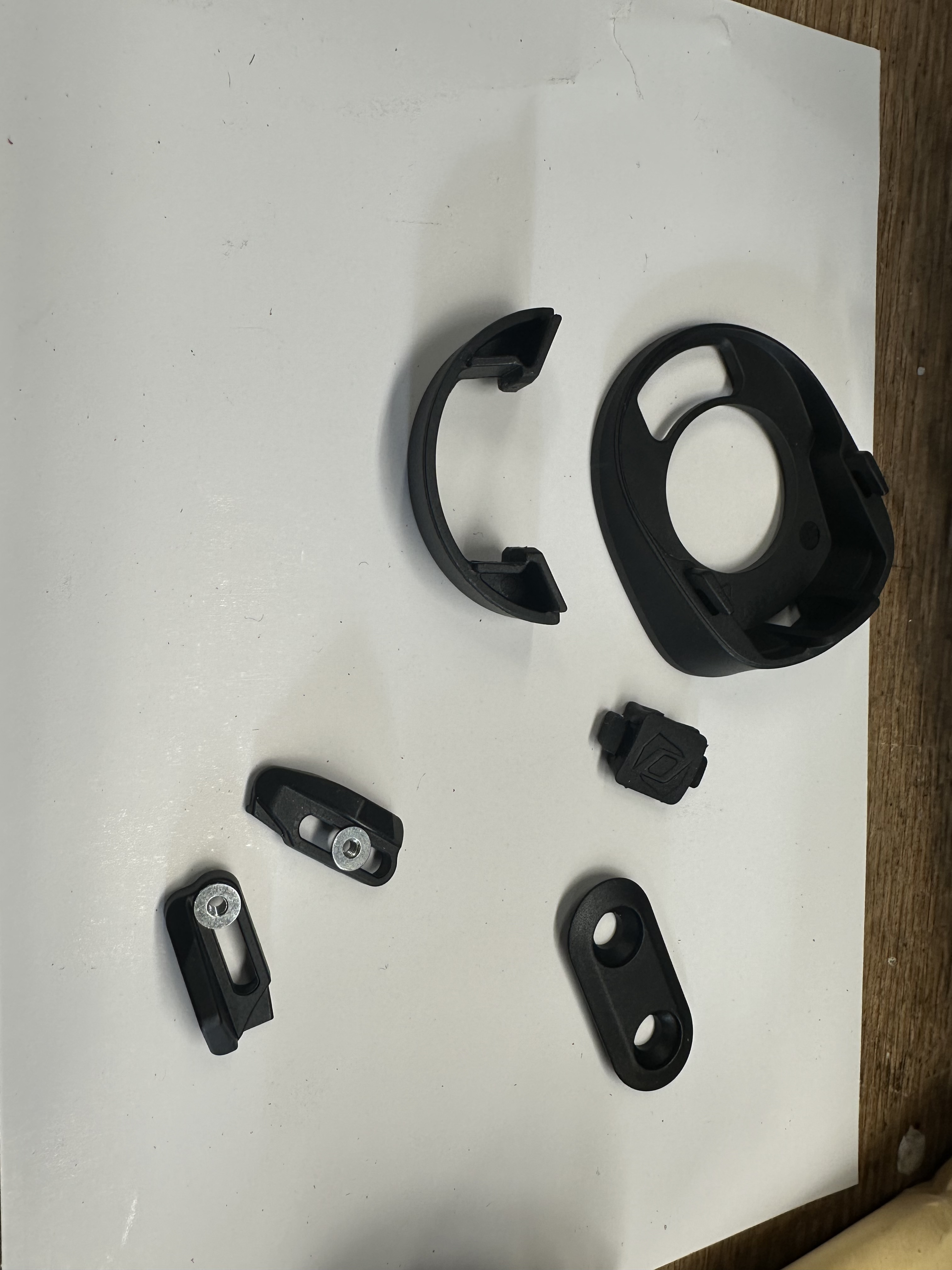

Hey all, just got my new 2026 Scott Addict 10. Once upon a time (long ago) I was a shop tech at a bike shop, long before disc brakes and electronics were the norm. I have some confidence in my abilities to finish the assembly, but also some trepidation.
What I need a little help with are theses lil doo-dads that came in the small parts bag with some stem and headset bits. I know that I’ve got a FD hanger cover, a headset top bearing cover, a lil stem cover/plug for the (weirdly no longer approved computer mount) and a stem spacer front snap on cable/hose cover.

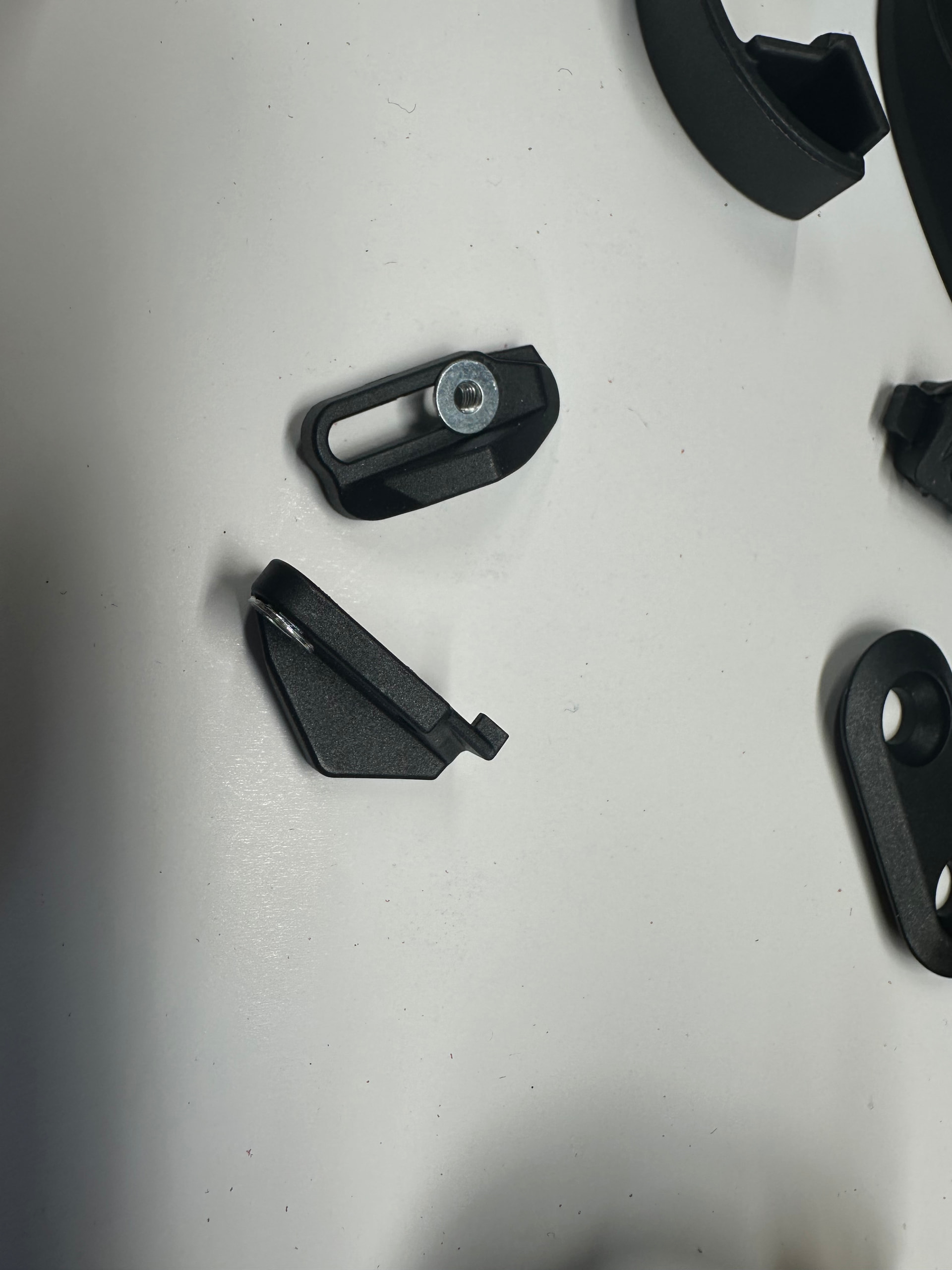

But What’re the two lil guys with a captive sliding insert? Is it a problem that I don’t know what to do with them?
Thanks!
Hard to tell the size from the pic but they look like the doohickies that go behind the front derailleur to brace it.
Ding, ding, ding! Winner! That is exactly it! Google got me to the super helpful Sram doc, looks like they are the “Wedge”
The wedge provides additional support for braze-on mounted front derailleurs. The use of a wedge is strongly recommended as it will enhance shifting function and performance.
Thanks a bunch! I will now continue the assembly and reassess if the FD proves problematic at all.
Interesting that they are not mentioned in the manual, which looks better than most I’ve seen. Must be a SRAM part and not a Scott part.
Yep there an SRAM part, you get 3, one should be fitted behind your front derailleur mount to brace it. You get the choice of 3 so they can fit many different bikes.
