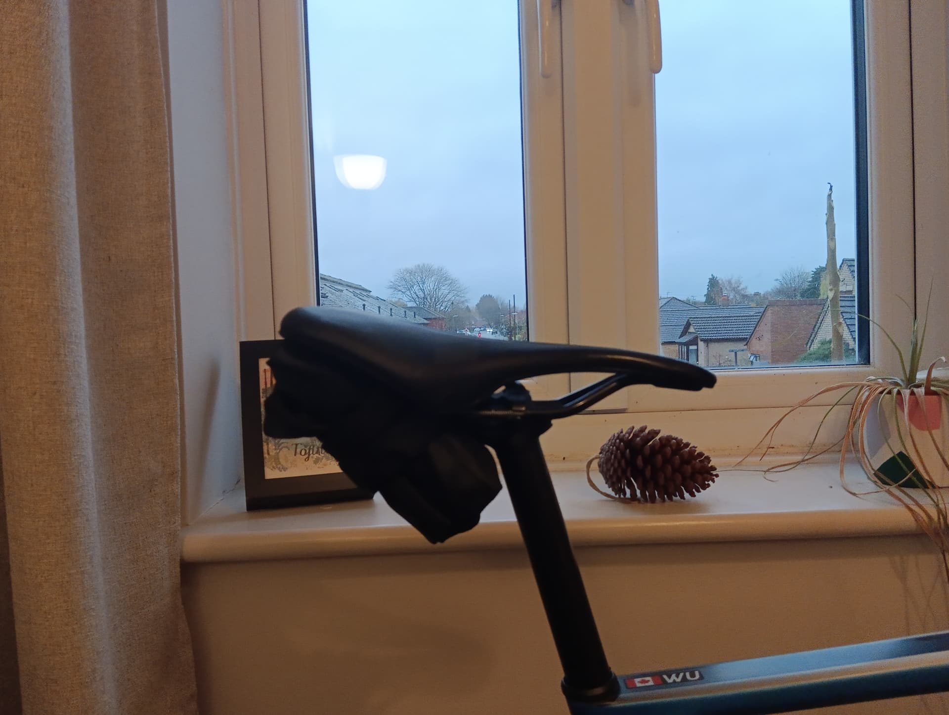

I have mine on quite a nose down angle. It is less extreme when seated as the seatpost flexes a lot and nose points down less. But I sit pretty forward on it still and am ‘snug’ with my sit bones in the narrow bit in the middle of the saddle, the ‘scoop’ keeps me a bit more planted.
With the caveat that I haven’t had a professional fit with this. But it works for me, especially to reduce saddle sores and when riding in drops
With the saddle at such an angle, do you not find that you have a lot of pressure on your hands?

A little, but not to the point of discomfort. Saddle is fairly far back on the rails so that helps. I’ve been playing with the tilt to be fair recently and it might end up with nose a little higher than pictured, but the nose drop is comfortable when in the drops for a long time (I ride in the drops a lot)
