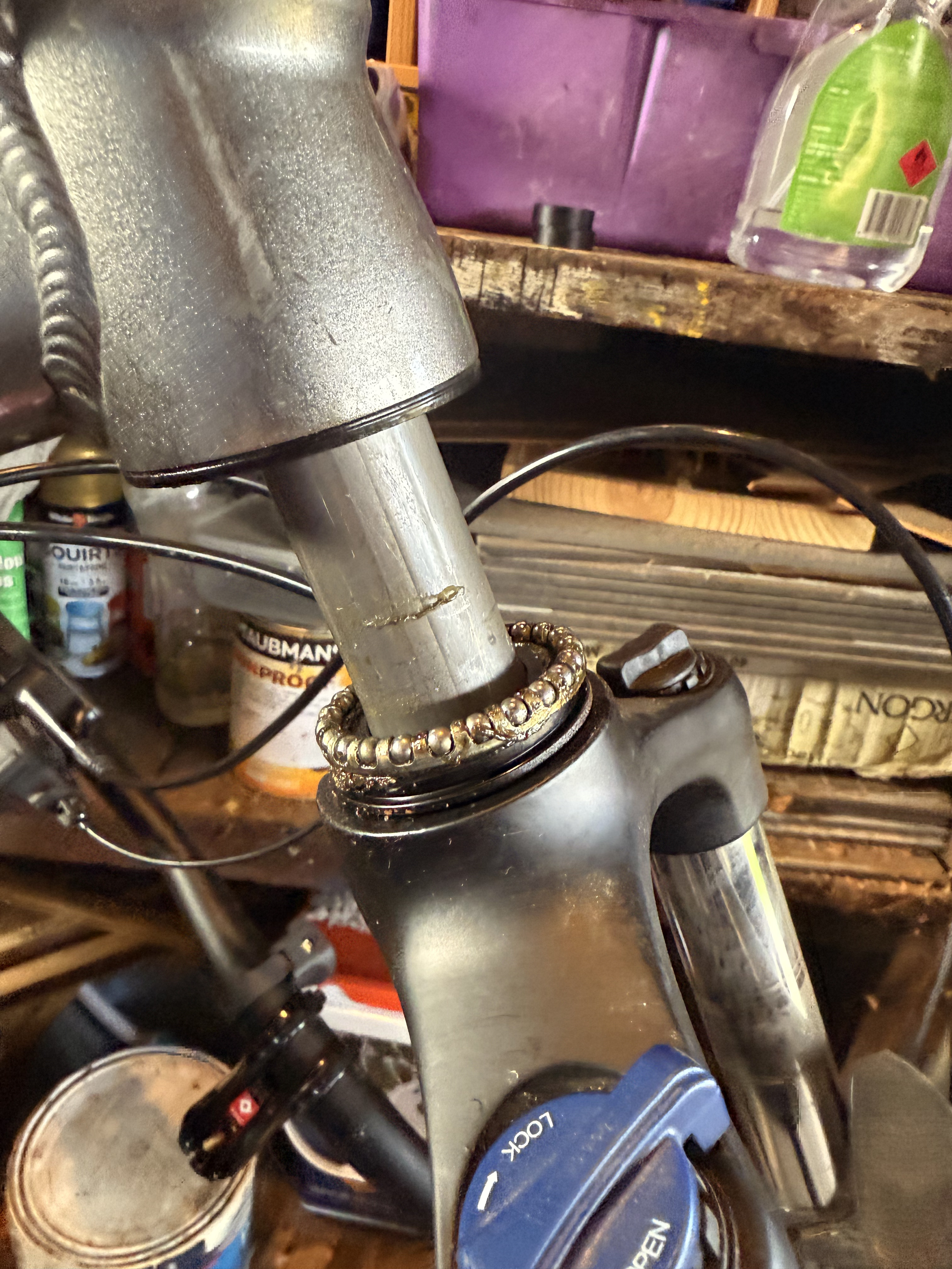

Below is a photo, where you can see an over-sized bottom bearing race. I’m guessing the fork is just using a larger diameter crown race, to allow the straight steerer to be used in this model (and that other higher-end variants do come with a tapered steerer fork).
yes, that frame can take a tapered steerer.
might be worth taking the opportunity to replace that headset with something that has cartridge bearings while you’re in there too
Replacing the headset more than just nice to - It will be a requirement - as it’s unlikely you’d find a crown race for the replacement fork with tapered steerer that would match that existing headset. Much easier to get a full low cost cartridge bearing headset instead and replace the whole lot including the cups in the frame.

That lower bearing race looks like it interfaces with the black upper cup in the photo. I presume I’ll need to remove that too. Will the cartridge bearing just fit up in there or will it require an extra bit of hardware? I’m thinking it won’t but not sure TBH.
100% you’ll need to replace the headset cups in the frame. No chance sealed bearing will interface with the ones currently in there.
You absolutely should use the correct tools for that, if at all possible, but can be done with careful use of a hammer. Use with a punch (or large screwdriver) to remove, and then use with a piece of wood to drift in the new ones.
However, getting the right headset can be a minefield, so would strongly advise taking frame and new fork to good local store/mechanic and just get them to do it all. Headset should be 20-30 £/€/$ (no need to go higher, and if cartridge, cheaper likely also ok but probably won’t find cheaper in a store) plus 15-20 mins workshop time.
Roscoe’s are definitely a tapered head tube and you are right the higher end models come with tapered forks, semi integrated headset and cartridge bearings. Just a case of finding out what fits.
