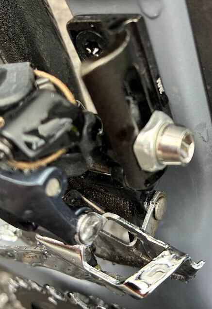

The frame is equiped for a direct mount front derailleur. Because of the form of the seat tube, it is not possible to use a front derailleur with a collar.
I have installed a 46T chainring in the front (because of the max. gear they can run during races in their age category).

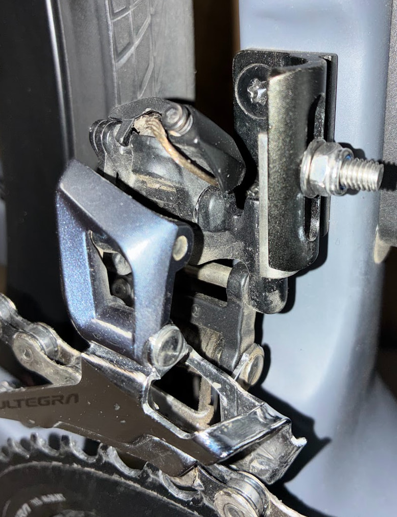

Problem is that the lowest position for the chainring that is possible with the standard direct mount adapter of the frame is for 50T. With this front derailleur height, shifting works but the chain often goes off when shifting from the small chainring to the big chainring.
Does anyone know about a sort of adapter to lower the front derailleur on a direct mount frame?

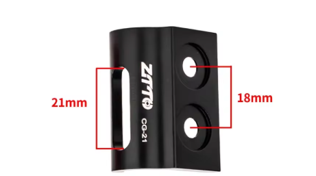

I can only find this on AliExpress, but the dimensions are the same. I would need something similar, but with a couple mm more tolerance to lower the front derailleur:

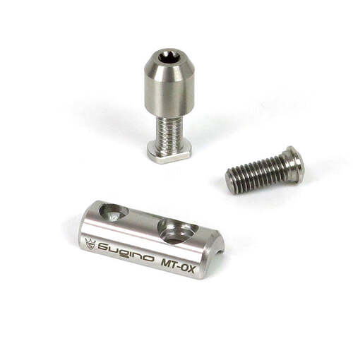

Sugino makes an adapter like that but it’s quite pricy for what it is.
Thank you!
That is exactly what I was looking for, but indeed quite pricy…
Depending on where you are located, here is another version of the Sugino one. We have installed these on a few bikes and they work quite good.
https://www.interlocracing.com/shop/53102-ird-front-derailleur-dropper-4421?search=derailleur#attr=

There are similar adaptors to the Sugino one on Aliexpress, or Wickwerx have one.

It’s an Ultegra front mech.

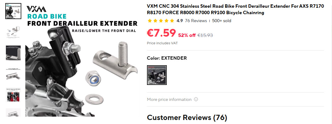

Would be great to find one on Ali, but I cannot find something similar. The suggested (expensive) ones are very difficult to find in Europe.
Edit: found one!
