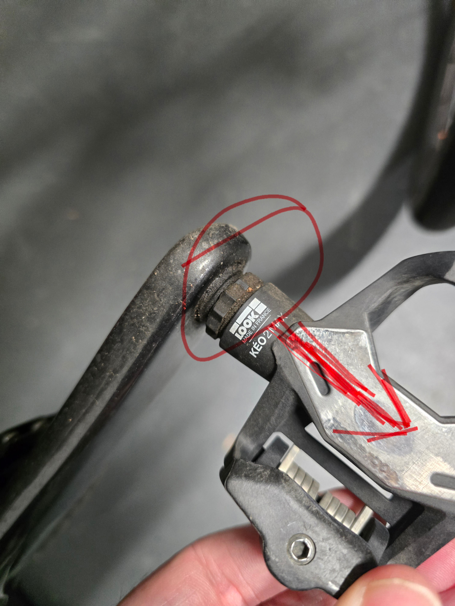

I just noticed my Look Keo 2 Max pedal has some side-to-side play of approx 3mm along the axle. This doesn’t seem normal particularly considering my other pedal on this same bike, and other Look pedals on another bike don’t do this.

Not sure what is happening but if you remove from the crank you can unscrew the axle by gripping the contour plastic bit in your circle (like with pipe grips) then rotate the pedal.
You can then maybe see what is happening. You can aslo clean inside the pedal body and around the axle, put fresh grease on the axle and put back in. I know thats not likely the cause but by removing the axle you might be able to see. Be careful as the contour plastic part is easy to damage (soft) so use a wrag around it. There’s maybe a specific tool!

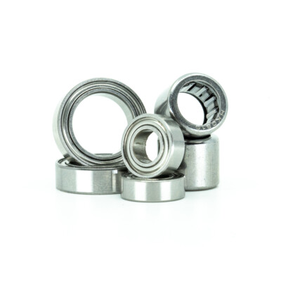

I recently replaced the bearings in my Keo 2 Max pedals. Easy job and they will roll on for another 20,000km

The tool for that is a 12pt combination or box wrench, I think 17mm. It looks to have some space. I’d try just tightening it first if it’s at all loose.

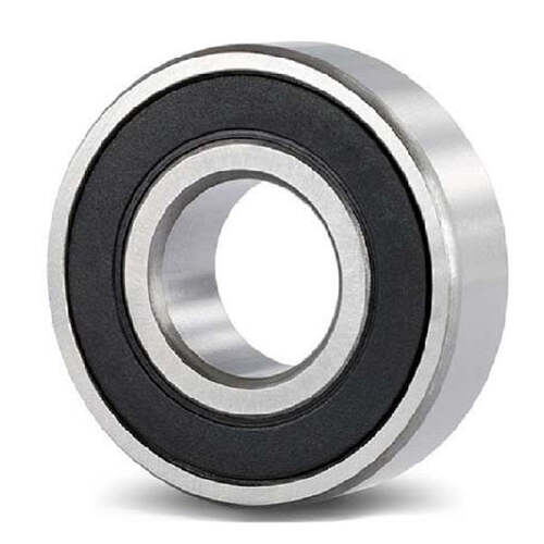

To be honest I just used that ebay listing to see what bearing numbers I needed for Look Keo 2 Max.
I’m in Brisbane (Australia) so I picked the bearings up locally from this place (just double check how many you need for the pair of pedals):
You could also get them off ebay or similar i think. I didn’t place any weighing on spending big dollars on branded bearings (Enduro etc). After doing it once, the servicing was easy enough and I figured new grease annually will keep them going for a while.
