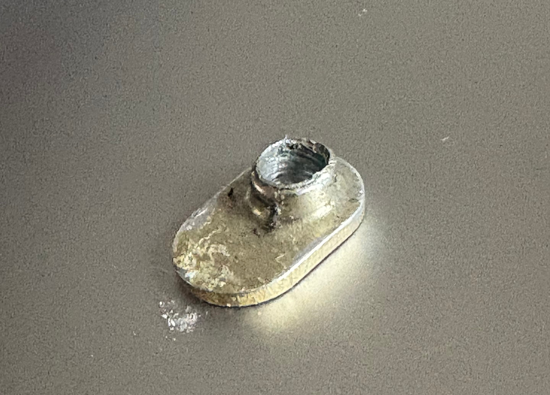

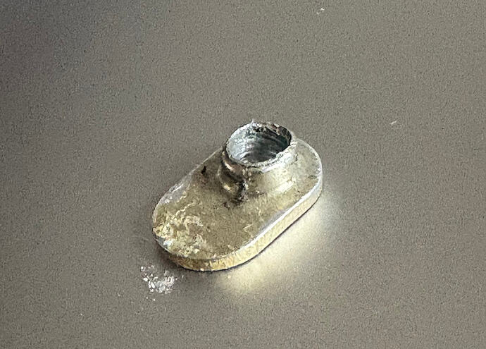

I have a single stripped T-nut for a cleat bolt on an S-Works Torch road shoe (pic below). Looks like a replaceable part but I’m having trouble finding a replacement.
Haven’t been able to locate anything on the Specialized USA site, but Google searches are directing me to this product on various Specialized international sites: S-Works 6 and Sub6 Replacement TI/Alloy T-Nuts, Part No.: 61116-9012.
This product looks right, even though it’s for an earlier model of the shoe, but it’s out of stock everywhere. So where are people getting replacements for this part? Is it called something else now?

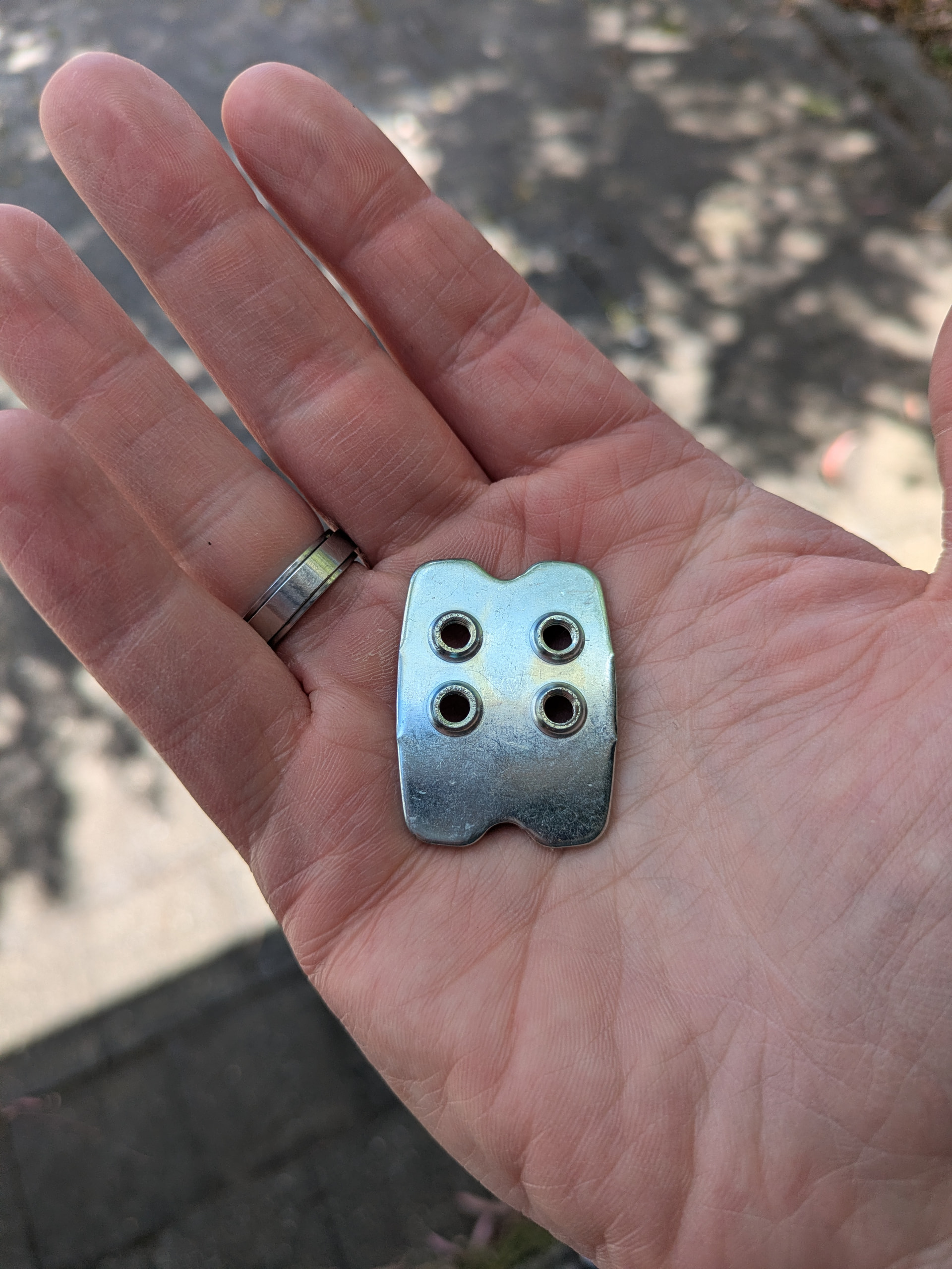

This may be a little more crude than you’d like, but if the actual part is impossible to find you should be able to cut down an SPD plate (often supplied with Shimano SPD cleats) to size/shape. The thread is the same, as well as the thread protrusion compared to a flat nut. I’ve been able to save a pair of shoes in this way after stripping a thread myself.

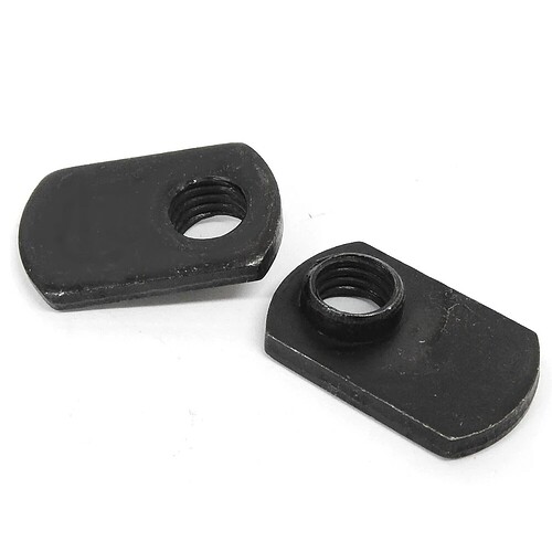

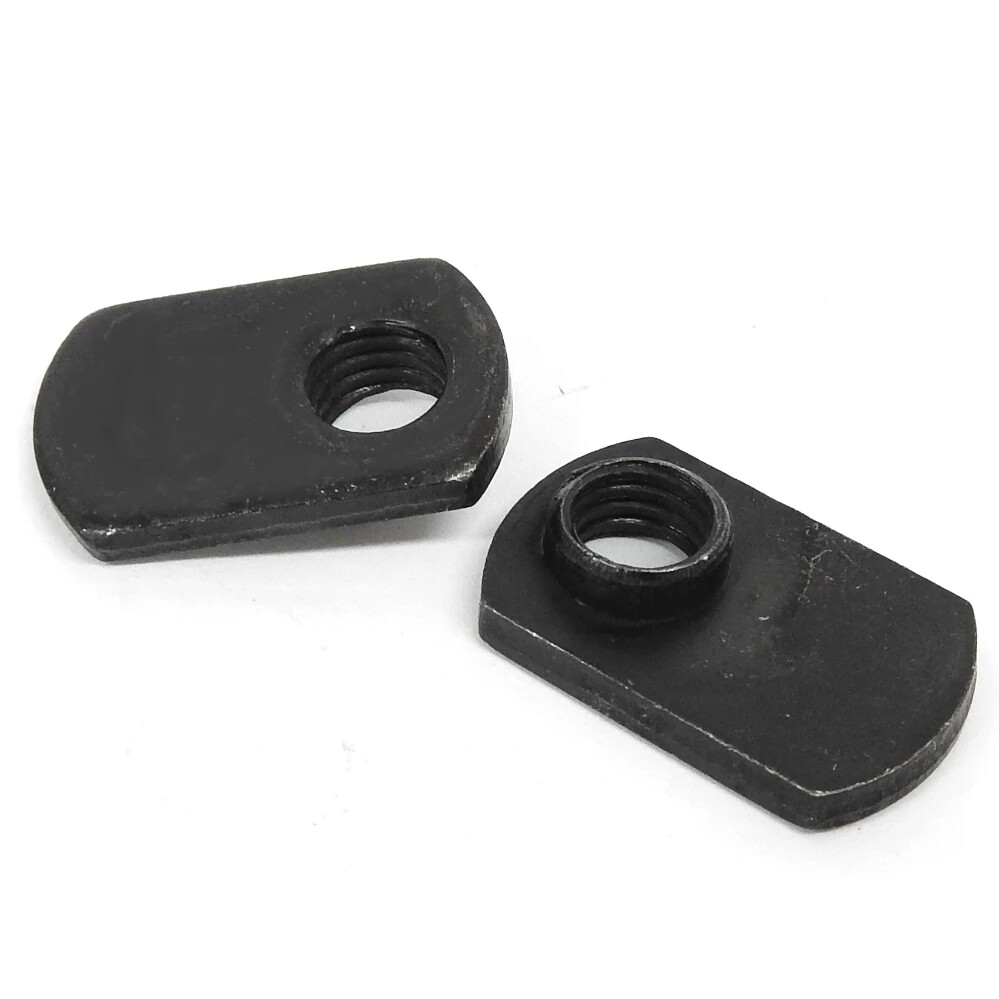

A neater alternative is an eccentric M5 T nut, used on small machines:
https://www.makerstore.com.au/product/hard-tnut-econo-eccentric-m5-1pc/

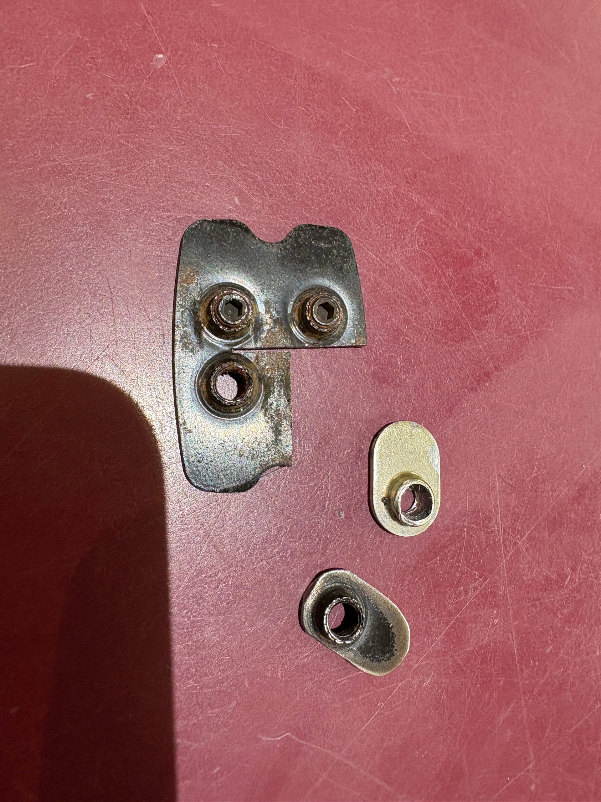

@Iain_Treloar this is exactly what we ended up doing, albeit with an old plate that looks like a horror movie prop. Local Specialized dealer couldn’t help with sourcing the nut then a mechanic grabbed an old plate and cut off a section. Seems to be working fine.
