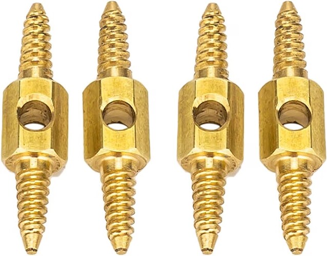

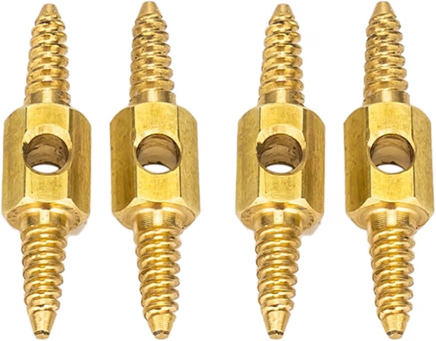

If routing is a challenge, there are double ended connectors you can use to pull the new hose through as you remove the old one:
