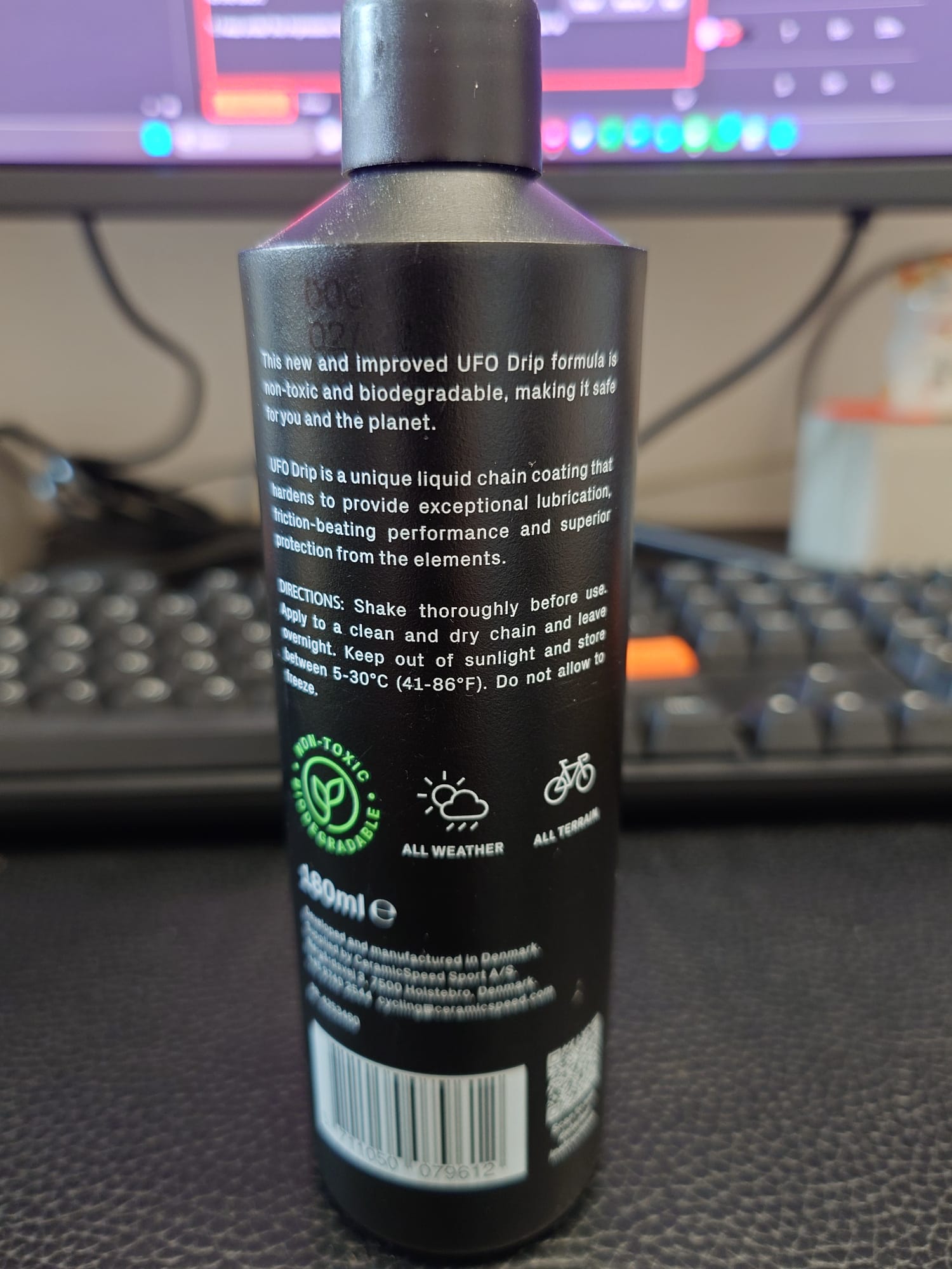

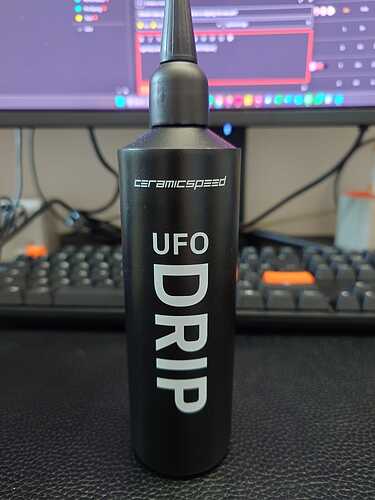

I applied Ceramic Speed UFO Drip lube to my previously waxed chain. I was under the impression that the Ceramic Speed UFO Drip was wax based, but now that my chain is black and grimy, I’m not sure and the packaging doesn’t say. Does any one know if this chain lube (see photos) is wax based?
Pretty sure UFO drip has always been wax-based. There’s a big difference visibly between oil-based lube and wax-based lube. The wax-based drip lubes I have tried all have this whitish color when being applied onto the chain.
Curious. How long of a time interval was there between application and your first ride with it?
Yes that’s definitely wax-based. The usage instructions also confirm.
That said, I don’t think it’s unexpected for a waxed chain to become black, especially on the inside (the side that faces the rear wheel). My immersion waxed chains often look clean on the outside while the inside is black and grimy looking.

I don’t recall the time between application and ride, but at least over night.
Thanks. I’ve just never seen my waxed chain that dirty before, but it was also a rainy ride along some industrial roads with big nasty trucks which isn’t usual for me. Sounds like a quick hot water rinse and re-wax is all I need.
