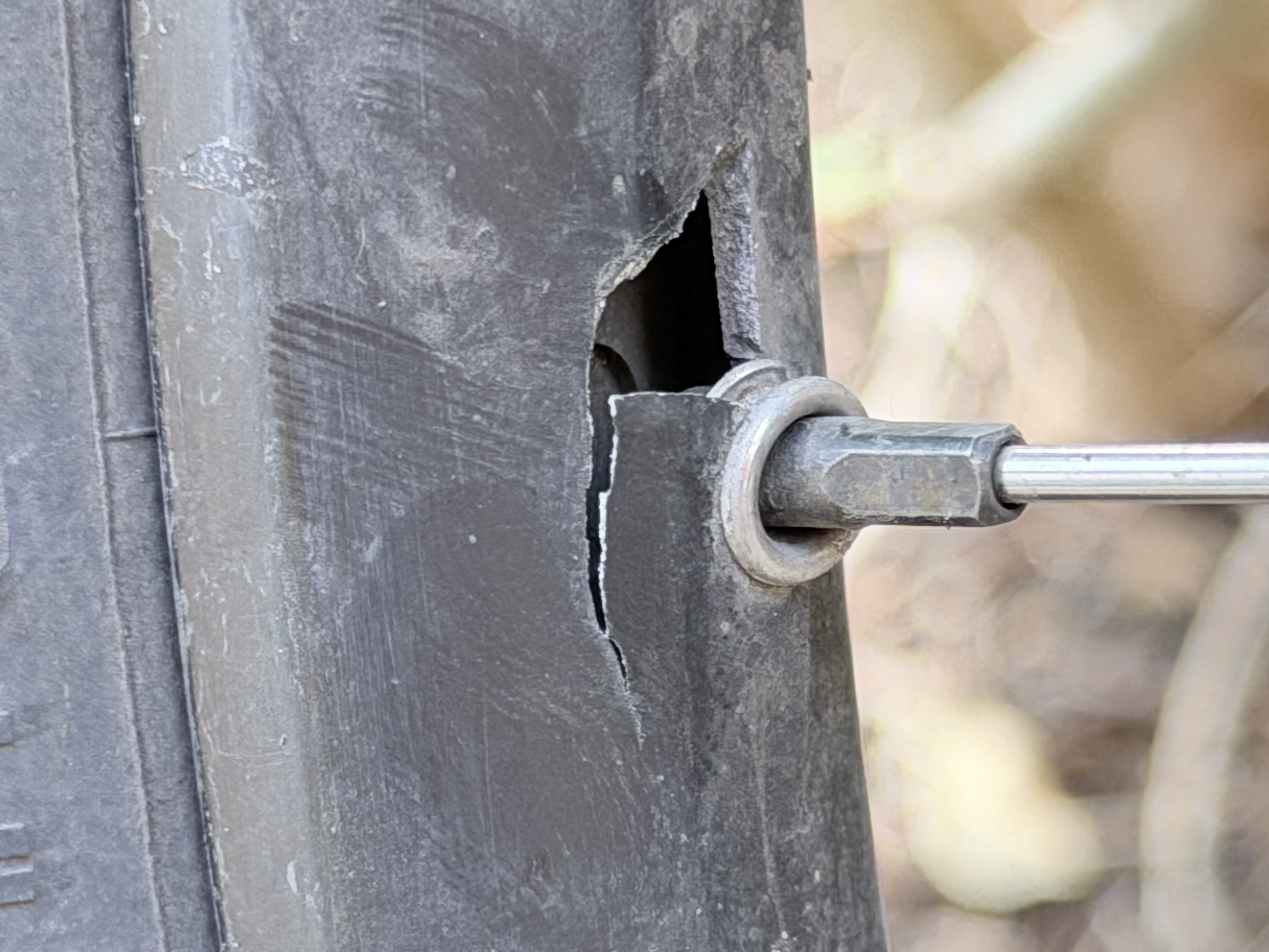

The rim of my rear wheel broke again, the second time within less than three years. The first time around it was Stan’s XC aluminum rims, the second time it was a rim with reinforced spike holes. The hub (Shimano XTR M9000) is still in perfect condition.
I’m not abusing the rims/bike, I think, but I’m not babying it either. My commute has a some gravel, some cobbles, some paved road, and one set of concrete stairs that I ride. I’d also pull a trailer packed with kids and/or groceries.
Why do I keep breaking rims? Should I opt for carbon rims to get something that is more robust? If so, any recommendations? Perhaps I can get something on the used market as the rear wheel still has a quick release.

I’ve seen rims fail in vaguely that way including carbon rims, but they had been used in all conditions, including winter salted roads, which combined with the Alu nipples meant there was galvanic corrosion.
Is it possible you have experienced something similar?
Front wheels rarely give any trouble unless crashed hard - that’s normal. If there’s FS even less chance. You don’t say what the rim is or how many spokes there are, so we have no idea how tough it may or may not be. Regular stairs (= square edged ruts) ridden at speed are going to be hard on the unsuspended rear wheel, and unless you’re super fussed about weight then a 32° (not 32"!) wheel with an Enduro/DH rim and a large volume tyre should hold up way better.
Did both rims fail on the drive side? How many spokes?
The roads are not heavily salted (unlike where I lived before, my XTR rear mech’s clutch rusted in place), but it is very humid all year around as we next to a lake and there are tons of small lakes and channels crisscrossing the landscape.
I can avoid riding the stairs, but the previous set of wheels failed even without stairs (I took a different route back then).
The first rim failed “everywhere”, the fatigue cracks were all around the entire wheel. I’d have to check where the hole is located, I will update my post later.
Edit: It is a drive-side spoke. And the rim is a Contec Xeta Max, whatever that is.

That hoop has no corrosion that contributed to that failure
