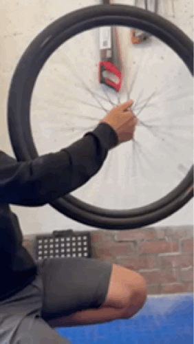

I’ve just replaced the 6802s in my gravel wheels with some new shiny enduro bearings. When I press them into the hub the disc side set feel grumbly. I’ve pressed them in one at a time with and without the preload spacer and it seems just one side is the problem. The bearings feel fine once they’ve out.
I’m not expecting anyone to diagnose the problem over the internet but I’m posting in the hope that someone might have some ideas of things to look out for. I can send them back to Scribe but they’re out of warranty so it’ll be an expensive hassle I’d like to avoid if I can. Can the escape collective brain trust help?
