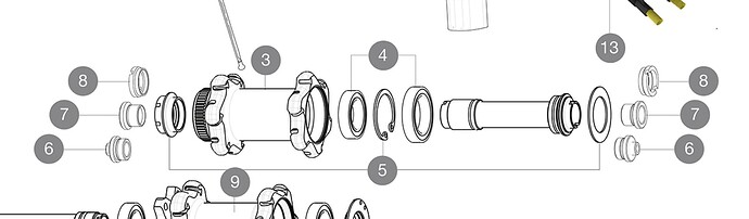

Has anybody got a clue how to get to the bearings with this hub, would need to change those? I have removed both threaded endcaps and that threaded preload part (second from the left on brake disc side), which gives visibility to the 6804 bearing on that side, cant figure out how to remove plate second from the right, numbered also with 5. Circlip is not accesible, axle is only thing visible together with that bearing and that plate. Maybe hammertime?

@Lauri could you possibly share some photos? I’m sure I’ve replaced bearings on these hubs but can’t recall exactly and a photo might jog my memory.
Sadly I don’t, friends bike thats back in use. Axle is a bit unusual, slotted at the ends, both ends are externally threaded, preload side on two diameters. Will take a picture when I see the hub next time.
