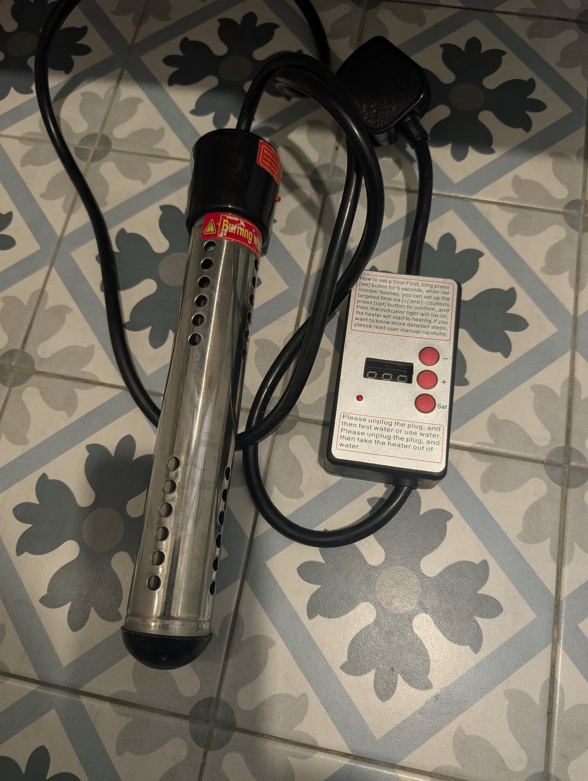

I got myself one of these bad boys off of AliExpress only to be able to heat the water in my ultrasonic cleaner quicker (the cleaner’s heater took forever to do its thing). It only takes a minute to get the water in my cleaner (15-litre, but half filled) up to 55 degC, give or take, and 3 minutes to get it close to 90 degC.

For no other reason than not wanting the old Silca wax to play any part in drivetrain longevity. Degreaser is effective on waxed chain? I asked Adam of ZFC and he suggested not only putting the chain in multiple rounds of boiling water but also a final dip in CeramicSpeed UFO drivetrain clean, which is supposed to be able to remove wax from chain.
