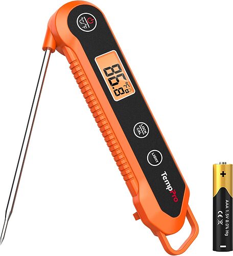

I like this for deep frying my chains. A thermometer is still a good thing to have.

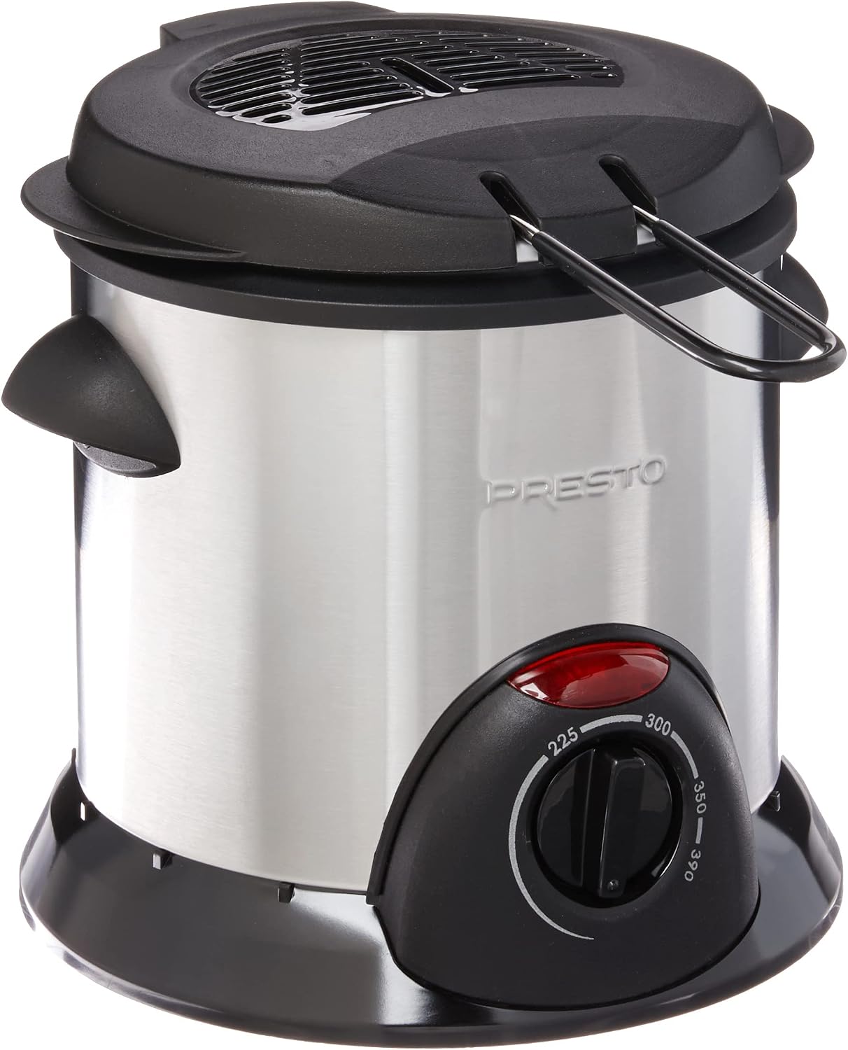

Just being a bit flippant about frying the chain in wax, but I do use a deep fryer. I heat the wax up to the recommended temps, and lower the chain or chains (holds 2 chains with room to spare) in the basket for the recommended time and then remove the basket from the fryer. The basket is great for letting the chain cool down a bit and then I hang the chain from a nail in my floor joist and straiten it out and let it finish cooling.
