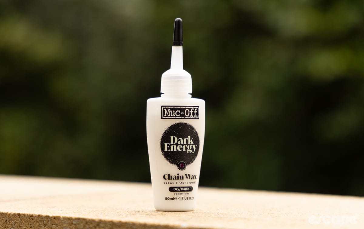

Is there anyone here that has already tested the new Chain Wax Cleaner from Muc-Off? They launched their new Dark Energy Chain Wax last week and also have a Chain Wax Cleaner now. It looks promising as something good to clean an already waxed chain before rewaxing, but as it is from Muc-Off I went for Silca to be safe :slightly_smiling_face:
